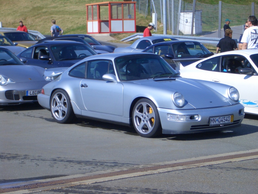

Attached are some pics of my car.

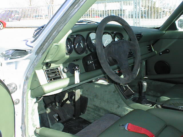

I've seen pics of that car before and the interior is fantastic.
Nick....glad you confirmed the obvious.....there are two RCTs in that color here in US now...the other was recently in Atlanta but was a lightweight for track use...a beautiful color....that green Ruf uses is choice. Seems green is Ruf's favority color.

Some more pics.

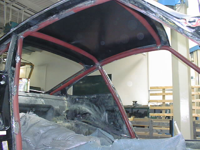

You have anymore Integrated Roll Cage (IRC) pics?

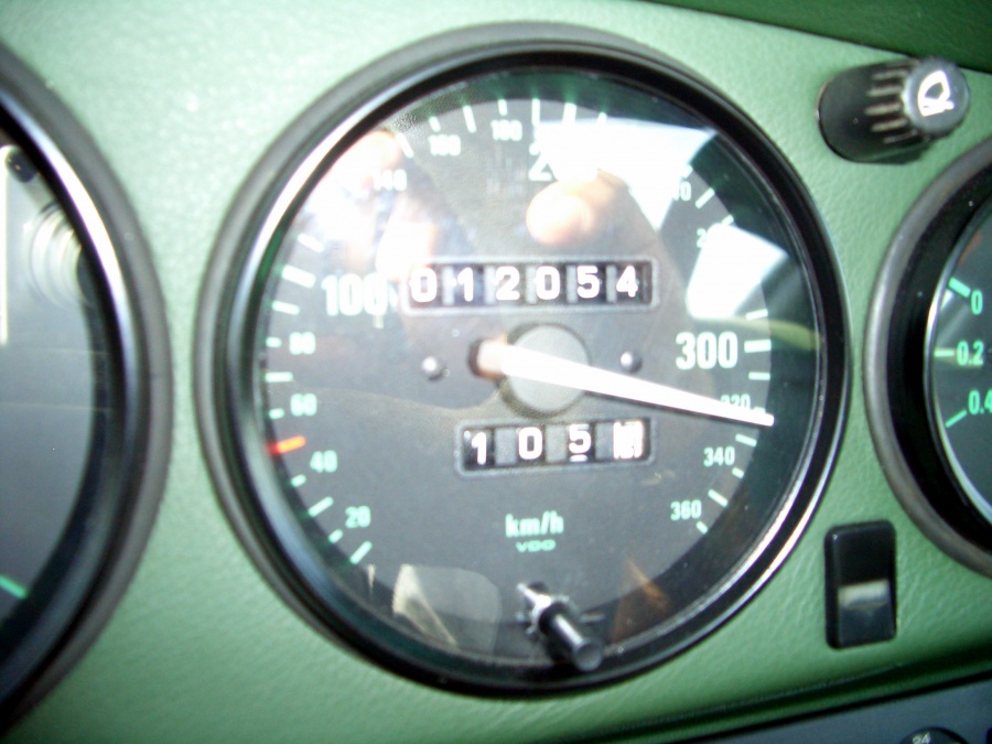

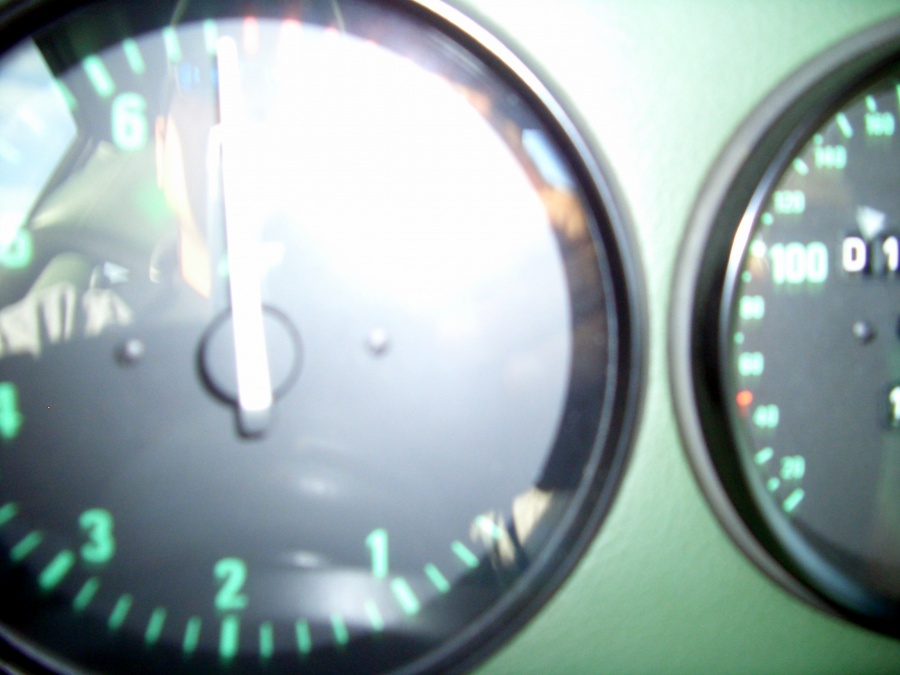

One pic of the IRC and two pics of the speedometer and tachometer.

Awesome...about 322ish KPH....that should put right around 200 mph....sweet!!!
So your car was black before....silver certainly is timeless and classic.
Did you snap any pics of the IRC in the engine compartment?....where did it connect in the front of the car...straight down of the door sill or straight through to the front trunk....Louis and the boys do really nice work.

The car was black. Alois stripped it to the bone and replaced the roof skin, fenders and doors.
The IRC tubes go down to the door sills and each of the A pillar tubes connects to the other tube through a tube behind the lower part of the dash board (above your knees). This connecting tube is not included in the standard IRC and was covered in carpet. We had to remove the glove compartment to accomodate the connecting tube.
The tubes in the back stay inside the cabin.
I also added removable tubes for the doors and removable cross tubes in the back of the car. The car is very solid.

Beautiful car..I especially like the green interior. Next time I visit PR hopefully I will see your cars around...
