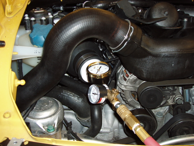

You need one of these my friend.................

plug her in and get a bottle of soapy water and start sprayin away.....then look for mr bubbles.....

How about you do one whole test for all leaks, instead of wasting your time trying to single out ONE problem and missing other potential issues.

check your f hose. I replaced all my clamps to the f hose and y hose and dv's. Those spring clamps and I don't get along.....lots of bubbles

this does check the entire system. One of my boost hoses poped off at the intercooler while boost testing. Tighted c clamps and X-strapped all intercooler connections....holds 1.2 bar all day long!
