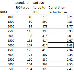

Here are the standard values for 996 turbo (k16). You can use the correlation factor column to your VE values to get the results.

Awesome. Thanks Ken.

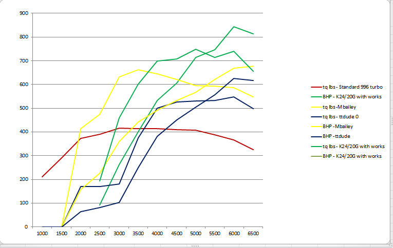

This is what i get for you and MBailey. I have just taken approx figures from the graph on the first page of the thread - how do we think that compares? I don't know whether the correlation will be identical for 997 v 996.
Are you saying that you could use the same correction factors for different types of turbos?

Mike I don't know. I have used the same for k16 v k24 and it worked fine when comparing x50 against std 996 turbo k16 v my set up.
When I done the rough graph of you and ttdude, the figure for you looks low, but it was a quick taking the values of the graph on the first page. Also when you produced the VE numbers for your car, was that at the maximum they could be e.g. boost levels, fueling etc?

Interesting graph... I dont know if its high or low since my car has never been dynoed. The log used for the VE calculation about a year old and I have made some power gains since then. Regardless, its very interesting data and I really appreciate you and Dave working so hard to draw so many valuable conclusions from it!!

Thanks for plotting my "dyno" graph. For Mike, I just used one set of data from his datalog in which he had a couple runs recorded. I didn't check to see which one was best and I believe none of them were from his 5.5s run.

No issues. The thing is that when I study your signature (which I presume is the car we are referring too?) that ran almost 200 at the texas mile - correct?
If that is the case, then I would have thought that you would have needed more power, or you are running less weight perhaps?
I think you need to go out and get another datalog!!!

We need Mike to take his car for a spin

Interestingly, the graphed hp is almost exactly what Todd Z estimates my car is making so it may be very accurate.

You should put your car on the dyno graph too Ken!!

Here you go. I must be sleep calculating!

Wow Ken!!
Your car pumps out the hp and torque!! Is that at 1.5 bar?

Yeah, his VE hits 300 or so. It would be interesting to see his 60-130 run with that profile.
Yes, I suspect he would crush his prior 6.66s run!!
