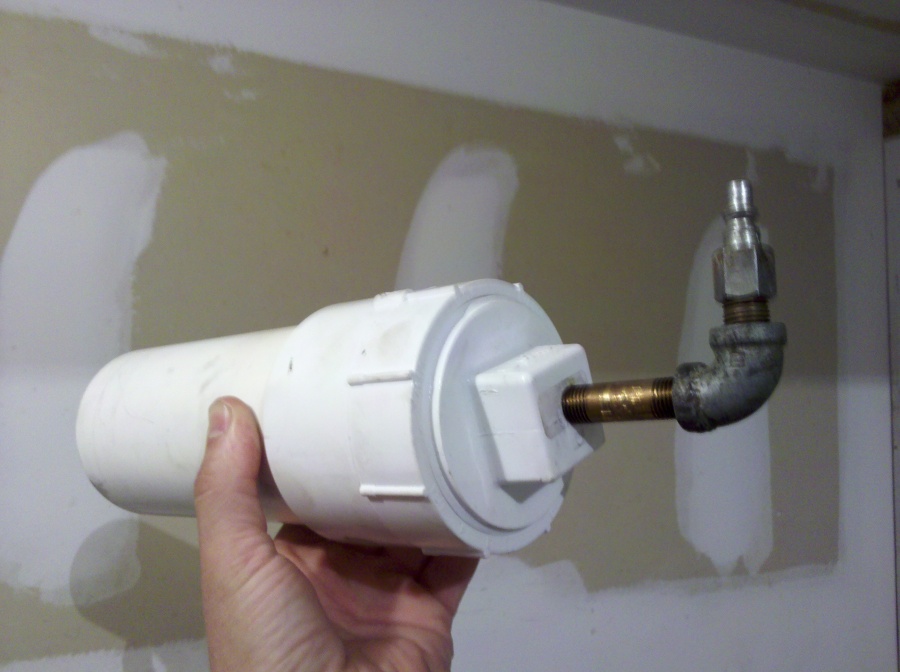

well there you go.. you took out the Y pipe to say the least.. and other parts...
you didnt mention that in beginning..
if you have a leak between the airbox( with maf on it) and the turbos you will have low end stutters...
seems like you were stubborn and didnt listen to Mike...
now you have a job on your hands..
to get rid of all the boost leaks you need to do a boost pressure test.. not that easy for first timer... from the turbos.... the right way....
then once we know thats taken care of you can address the maf issue if any...
you could have it at the Y pipe to TB as well...
that also doesnt mean you still dont have a pre turbo leak... like at maf to aluminum connection... or a few inches further at the big dv to aluminum intake connection..
at this point, since you touched a bunch of things , it could be anything...
next time tell us the full story and dont what you actually did... maybe we all can waste less time on labor day weekend chasing a leak you probably caused but did not mention what you actually took out...
Get mike on the horn.. have him send you a boost leak tester... both sides... you need a big compressor... wheels off.. car up in air... plastic fender wells off... and pressure test to 20 psi... get a spray bottle with soap and water.. make sure its quiet inside the garage... one person puts air in the other listens and sprays...
Im guessing one of your hoses is not on right since your hearing a hissing noise.. etc etc...
