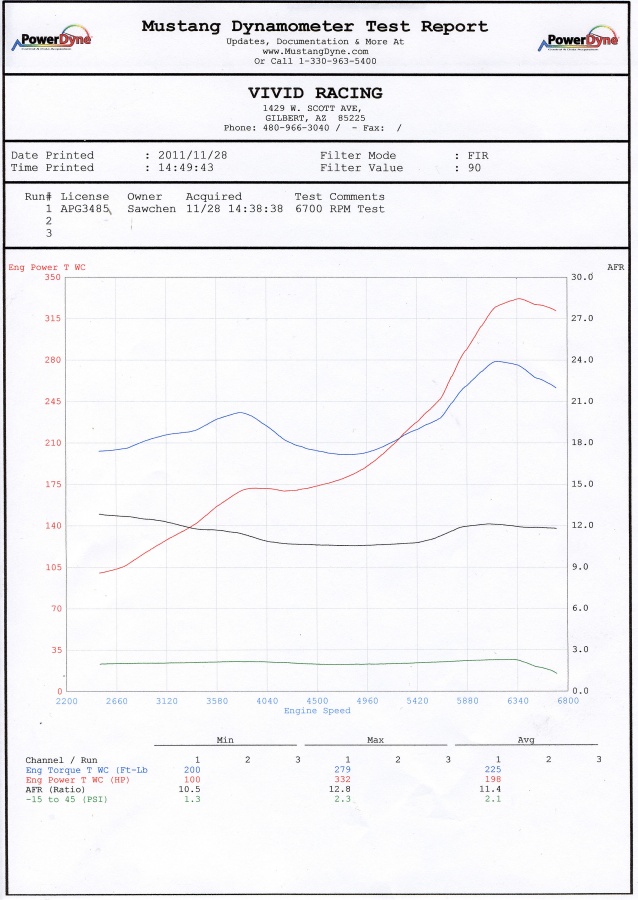

I did not get much feedback on the 996 board on my dyno runs.
stats: 2000 996 stick custom Supercharger 5-7 psi
Dyno Mustang Dyno AFR sniffer test only for AFR
Question what is the stock AFR for idle since it hunts? just looking for ballpark and AFR in producing power.
First tune test.
Note drop in the 5300 rpm range and AFR is leaner and produces more TQ/HP at high RPM and "0" boost. Compared to test map 2 below

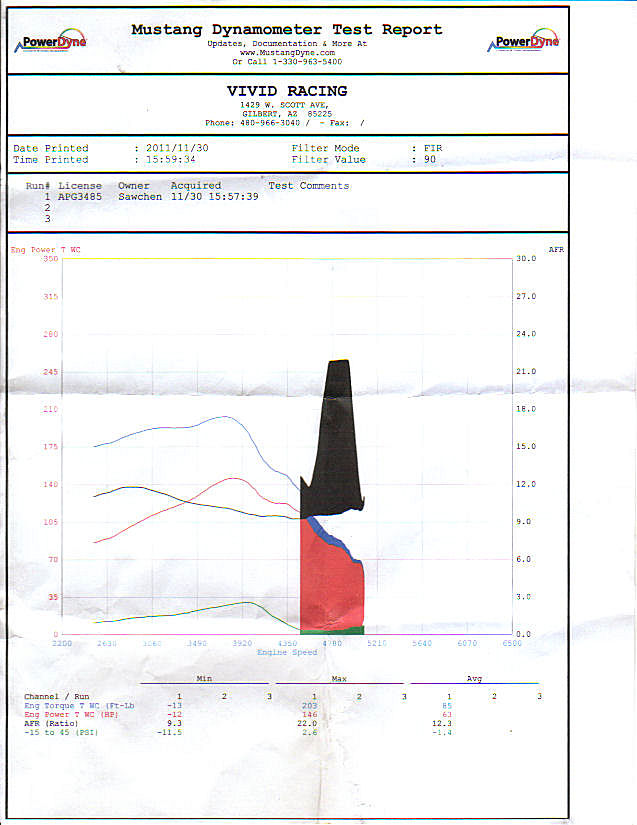

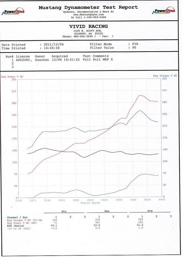

Second tune map.
No dip in the 5300 rpm range but lower TQ/HP and AFR is at 11.5 and psi at around 5 and Note: Throttle had to be gently applied if not it would pop and sputter etc to get through test.
My question what does it take to get a smoother graph especially at the high RPM'S. I also had a smoke test done and no leaks and belt is tight.

You need more fuel enrichment under accel. A supercharger is almost instant boost and it'll pop when it gets lean. Tune it rich and then pull the fuel out.

Had to shutdown this test due to popping minimum was 9.3 and assume that richening it will not bring the boost on earlier?

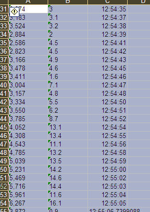

I could just not fugure out how to make a graph using excel but here is a small slice on original map.
1 is RPM
2 is Timing
3 is the time before data input
