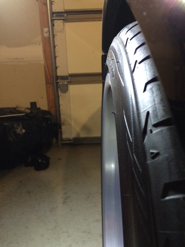

295 on a 11.5 is going to look pretty stretched here is a 305 S04 on a 11.5" wheel

Thats a nice looking fitment. Looks good at the rim and wheel well. You are running 38 offset and lower than stock ! Im running a 44. How is the clearance on the inner well ? My 44 puts me closer to the inside than your 38. My 315 barely fits a finger at inner lining.
