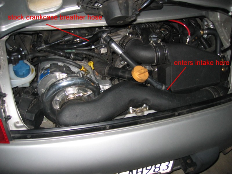

Here is how the stock EVO setup is. Notice the 1 inch hose coming from engine to the intake tube. This is required for EPA reasons and returns all crankcase gases back into the intake system to be burned.
where's your catch can?
In the corner of the engine compartment next to the coolant reseviour. The above picture is before I installed it.
