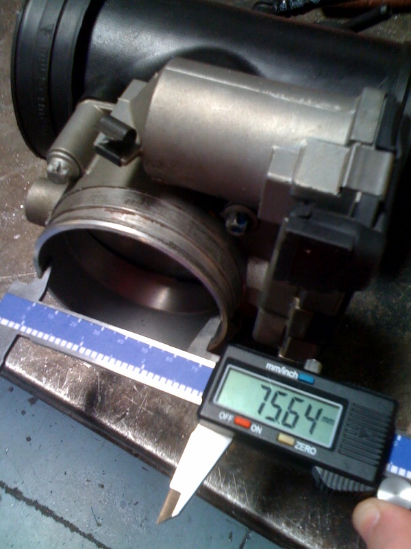

dgreen - I measured the ID with calipers on both. Those are the numbers I got.

Not to doubt you or anything but are you sure 78mm?
I have mapped every single DBW throttle body ever produced by Siemens VDO & Bosch and nothing is showing up as 78mm.
Is this the opening @ the rear or the throttle plate?
Also I cant imagine that piece is very efficient for flow?

INA, as an enthusiast you have MAP every single Porsche throttle body?
The aluminum T Plenum is very efficient, it is just like the stock design incorporated with a larger inlet to match the CTT throttle body. You dont need any directional shape since the engine works off pulses.
So am I sure about the sizes, here you go.
