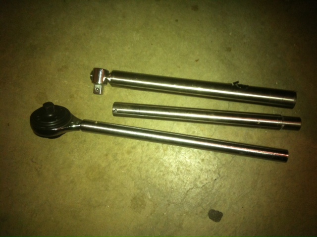

This is what I have, the porsche breaker bar w 3/4"
and a 3:1 tq multplier 1/2" in, 3/4" out so you can use a normal 1/2" tq wrench.
I paid around 600 for the pile, I'd take 1/2 that if somebody really wants it..
pm me
