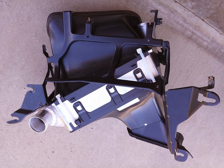

These are VERY good quality. 4 1/2 inch thick cores, and look at the welding skill. Top notch.

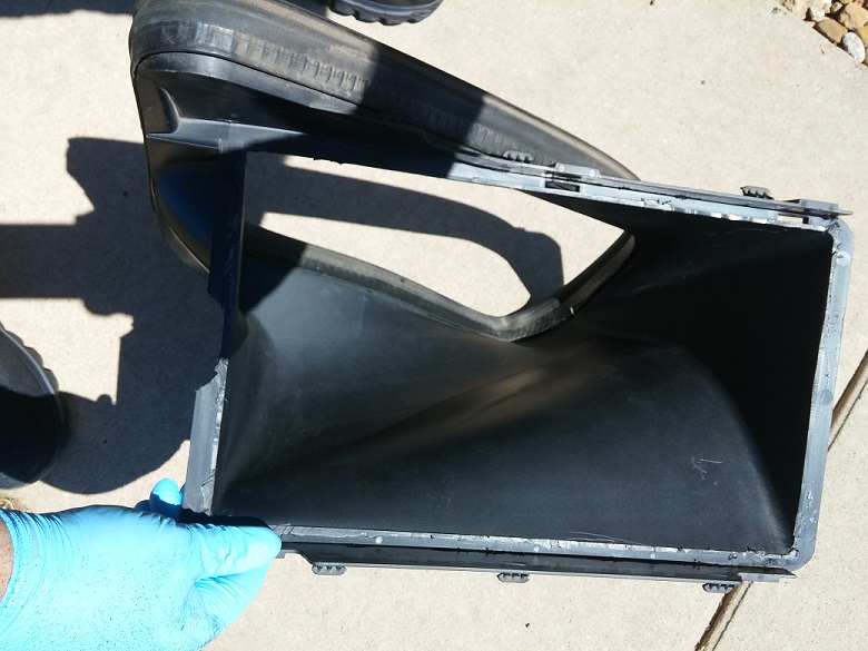

Now with the size of these, there will have to be some modifications done to make them fit properly. Installs similar when doing the 3.5" cores on the 996's, you need to trim a bit. I actually completely trimmed both sides of the plastics to completely flat as seen in this photo and believe this would be required since they are thicker. This gets rid of the lip that seats into the stock intercooler all together. (and frees up a decent bit of room)

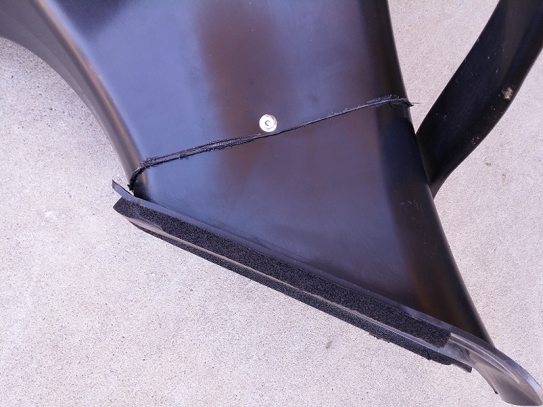

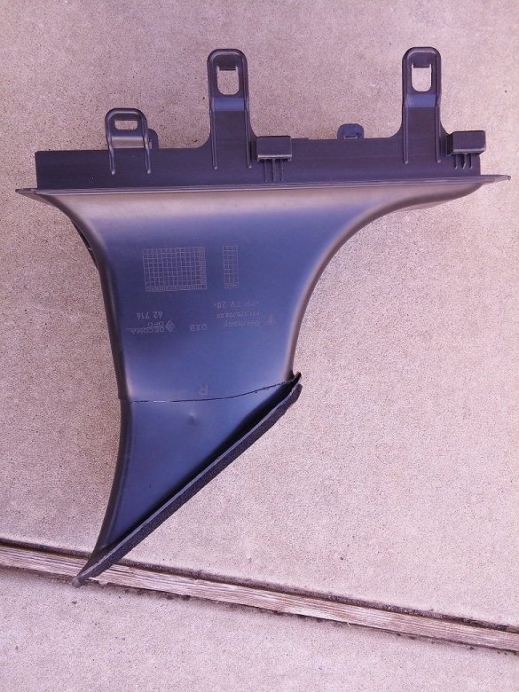

Lastly you will need to trim the top (what I like to call snorkel) down about 3/4th's of an inch. What I did was cut in the middle of the snorkel, and created a sleeve by sliding it inside the other. I test fitted to get the correct size, then put a rivet to hold it in place.
Cutting it.
"Sleeve" effect created
Measured and rivets on both sides before cleanup

Almost ready for installation.

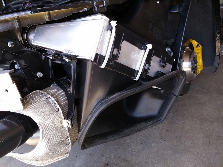

Here is what they look like installed.

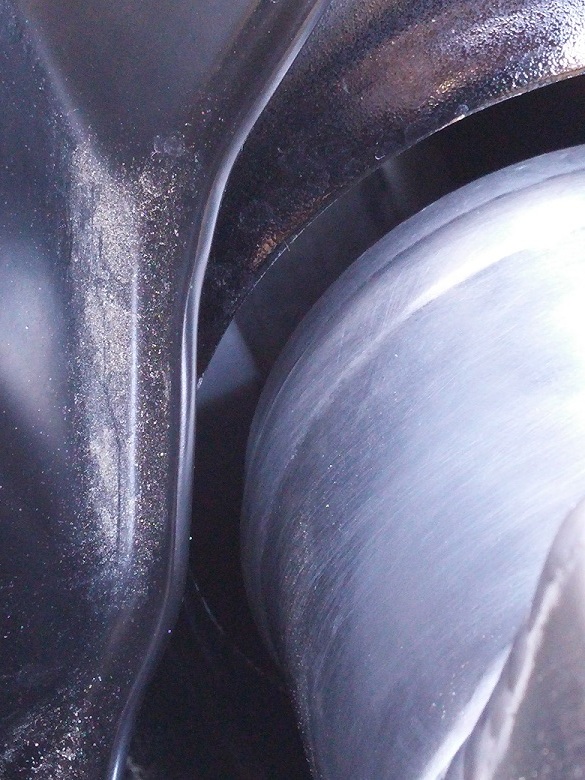

Notice plenty of room to fit hoses.
So far the only caveat is the Forge hoses that were included on my set were not the easiest to install. This has nothing to do with intercooler placement as they are spot on, it has to do with the hose length and shape. I hear that possibly there may be a custom set in the works just to make installation a little easier, but Sam would have to chime in on that one.

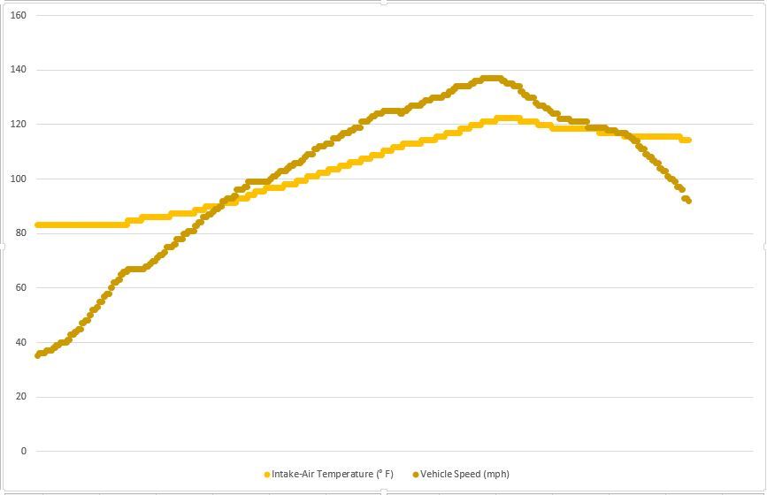

**UPDATE**
Ran a log tonight. Keep in mind the car is stock other than Intercoolers / Exhaust / 91 Octane Stage 2 Cobb OTS Tune (running 17psi)
Did a 2nd through 4th gear pull to about 140mph, outside temps were about 76degree's.
One thing I noticed was it seemed not only to do pretty well, but the recovery time looked to be decent.
I will try and get a few more logs over the next day or so.
