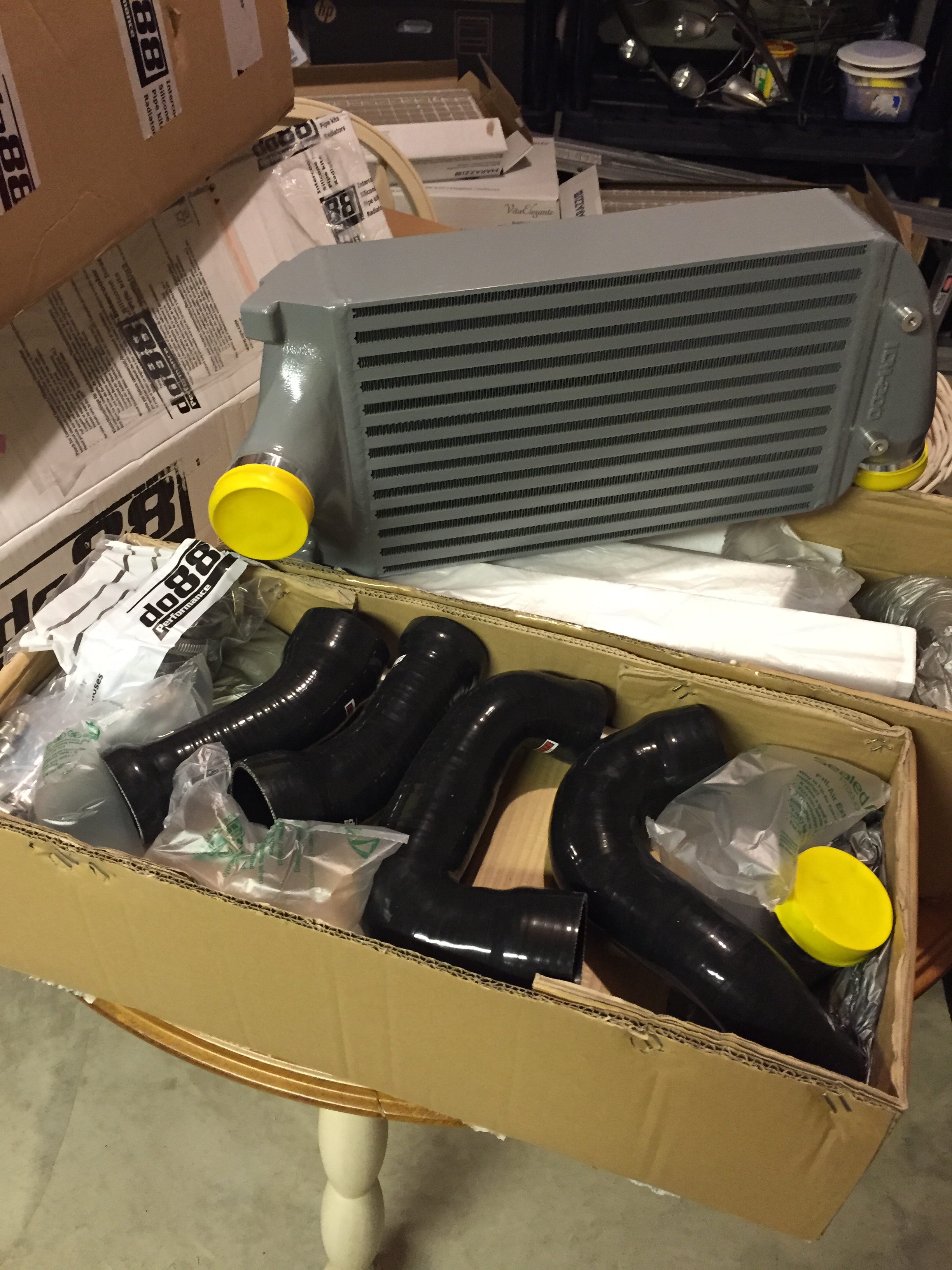

Just installed new Intercoolers and turbo inlet pipes on 997.1 from DO88
just an FYI to everyone out there that is looking for an Intercooler and or Turbo inlet pipe upgrade for your 997.1 Turbo. i have been looking to make the jump for an upgraded intercooler for some time. I looked around and did not want to spend around the $3000 mark, which most aftermarket coolers cost. I recently purchased the new DO88 intercoolers and Turbo inlet pipes from Fredrik at Do88. First off the product arrived within 5 days to my house in Missouri from Switzerland! amazing service and the price for what you get is hard to beat! I recently had my performance shop install both the intercoolers and turbo inlet pipes. The fit is amazing and wow i can tell a huge difference (butt dyno). I just wanted everyone to know that for a very reasonable price there is another intercooler and turbo inlet pipe option out there. I have attached some of the pics of the fit and finish of the intercoolers. They fit perfectly and did not need zip ties to hold the air shrouds on like others i have seen. Thank you so much Fredrik. Your product works very well and great pricing!!!!! 997.1 Turbo owners you need to check out DO88's products!

Nice ! Thanks for sharing, I like these better than the 997/2 ones. As you said, no zip ties or butchering of shrouds. Clean install with great result.

Would be nice to have some reliable data showing the benefit of this IC vs .1 OEM, sure do look nice though and sounds like they fit, but I had heard that there was still some modifications required...are they a perfect fit?

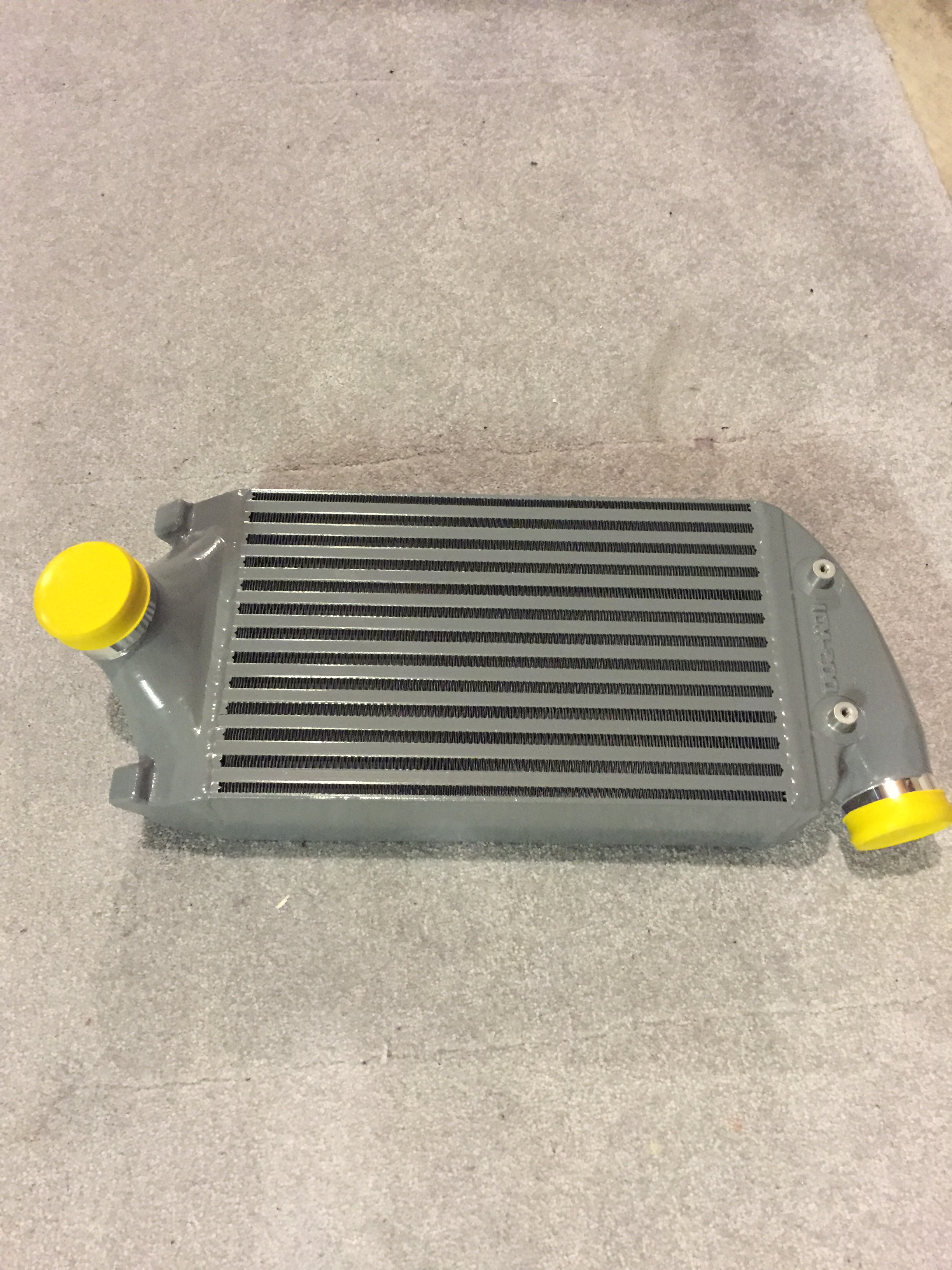

the inlets are awesome and are true contribution to the 997tt community. turbo inlets are a great mod and up until these we have very expensive options such as Evo and Champion.
i am curious as to why the intercoolers look painted/coated tho, i always thought that hurt heat transfer.

The cost is around $1,300 when converted to our dollar and they came with nice silicone hoses. My shop has pics of install. I will try to dig these up. You do have to trim around the shroud but it still is a better fit than the gt2 core. No zip ties required... Compared to the stock 997.1 it is a massive improvement! Just the end tanks themselves are wider like gt2's compared to stock 997.1. The inlet hoses I feel made a difference from DO88 as well. You can feel it for sure in the higher rpm. It flows better on the high end therefore you don't have the hesitation per say as the Rpm's rise as you do with stock hoses.

I think/hope its coated in that heat transfering coating that a few entities are using these days.
I don't have personal knowledge, but the data seems to support that it aids in cooling. Dont have any links but the info is out there.
If that is indeed what they are doing, its very smart. I planned on coating most performance parts with it.

from what i've heard from a pretty reliable source says these really aren't much of an upgrade, especially compared to the gt2rs units.
