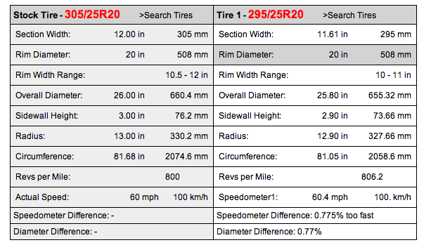

This should show you everything you want to know.
Why do you want to go to a 295?

Thanks for posting that up Ed! I just found a good local deal on 295's that's why I'm considering it.
The difference seems very small, but I'll kick myself if the gap in my wheel well is any bigger than it is now. It'll bug me to no end and I'll probably end up lowering it, but do you think it will be noticeable?

You are almost a 1/4 inch lower then the 305's, so yes you will notice it.
I run 295's on the street and 305's (bot on 19" wheels) on the track and I notice the difference in side wall.
If the deal is really good then do the 295's and take the money you saved and but a lower suspension. Your car will look better then it already does.

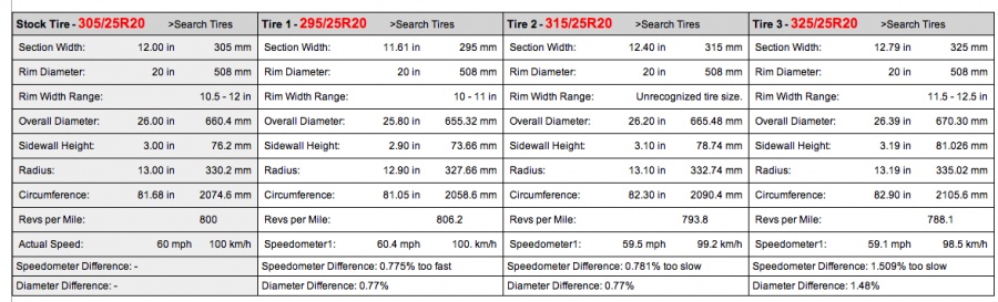

Ok, that's what I figured, maybe I should stick to the 305. What's the max size I could go, 315? Based on this logic I assume the gap will look smaller w/ a 315?

Here you go, I did the numbers for the 315 and 325. The bottom line shows the difference over your original tire.

Thanks again Ed, rep for you.
Is anyone here running 315 or 325 on the narrowbody 997?
