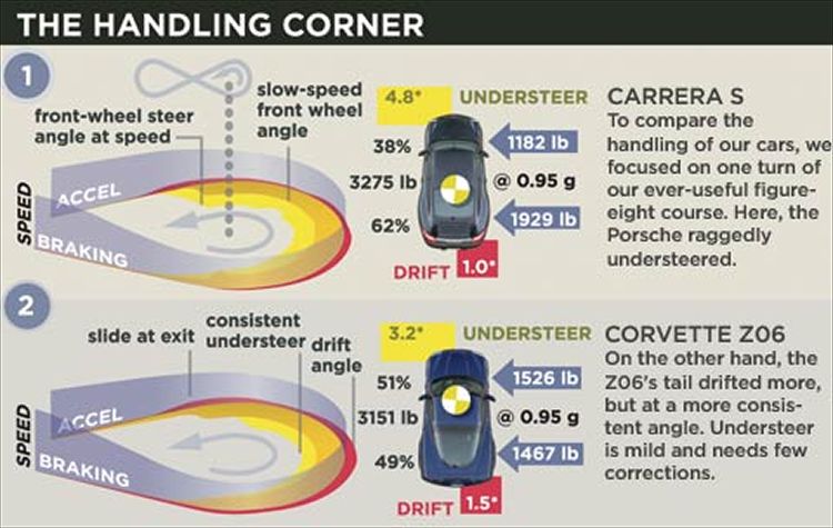

I am going to put that graph here that I promised. It is interesting and helped me understand how to attack the lower speed turns you will see on AutoX. I don't know if this will help track drivers with open courses
Most difficult part to drive 997 at auto-x for me is to get this feeling of how far car keeps going straight after you dial your front wheel into turn. Plus you need to have almost no free-rolling at all.
It works unbelievably good in slalom, but when, say, you need to do 90 degree turn after you redlined car at 2 gear and you are approaching at 100% throttle then go into full braking then you need to trail brake into turn with subsequent transition into acceleration - it is not like track with pure simple slow in - fast out, it is more like fast in - fast out with initial dial into turn while still braking then with full throttle you kick car into drift and essentially by the time when you start accelerating your wheels should already look right into entrance of next turn.
I do constantly overshoot this spot where you need start turning wheel without car reacting to it, all old reflexes demand to almost pass the cone by and start turning wheel only after than, but with 997 it has to be done quite well before cone and to calculate exactly the moment when understeer will be finally gone and car gets its full grip. It is quite difficult to explain with words and I may not even doing it right, but I struggled with it last season and hopefully may be will get this properly this season. People say it takes year or 2 to completely get into it. Will see.
I also find that 997` *** is way too heavy to use handbrake predictably. In case of 180 degree turn it is simple enough of course, but, say, to use it just to initiate drifting - no, does not work for me, most usually and disturbance of rear axle when you are going on limits of grip on burning hot rubber results in immediate spin.
