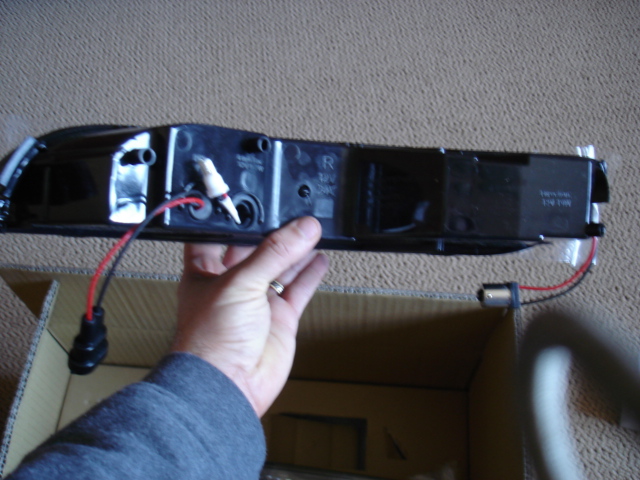

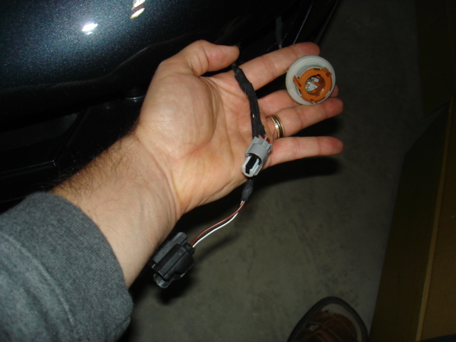

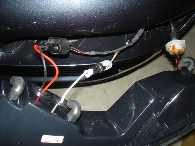

I received my Rottec DRLs yesterday. I'm very pleased with the lights. Here are some pics of the install. Basically, to remove them all you do is insert the card tool as per the owner's manual. Push in once and pull out the assembly a bit, then push in again and it will release. Pull it out and disconnect as per the manual. The only trick is that the fog light bulb and connector need to be removed from the original housing after the wiring has been disconnected. Then you re-use the black connector that the little blue bulb was in. It really couldn't be easier.

Doug, thanks for the pics and writeup. This is a easy DIY for anyone!
You're welcome. Yes, this is definitely a DIY.

Mine came in today too and it was as simple as changing light bulbs with 2 observations: The center (park light) connector is polarity sensitive. If you plug it in one way it fits fine but no park light. Unplug it and flip it over and all is well. Check your lights for full proper operation before you slide the new unit in all of the way and click it into place. I had to take one of mine out to flip the plug and it seemed to fit quite a bit tighter than the OEM unit. I actually split my plastic card getting it to pop loose. They look great though, especially with the DRL module hooked to them.

Doug, thanks for those pics, they really helped out as I was staring clueless at the wires for at least 10 minutes. I found first light to be a bit of the pain to do since I didn't know how. I did the 2nd within a couple of minutes.
A few things to note:
* The bulb connector on LED lights can be hiding in the large side hole of the LED assembly. One of mine was. I fished it out carefully with my finger.
* You have to reuse 2 pieces of the hardware from the OE lights on the LED lights! Look at the pictures above and see which those are. I would have never guessed to do that, at least not for a while. I just don't understand why the connectors couldn't be made to work with OE wires without those pieces.
* Separating the OE wiring by cutting the electrical tape and freeing them makes work a lot easier.
* I changed how the wires ran through the inside of the bumper to make the reused floating hardware easier to manage on the insertion of the LED lights.
