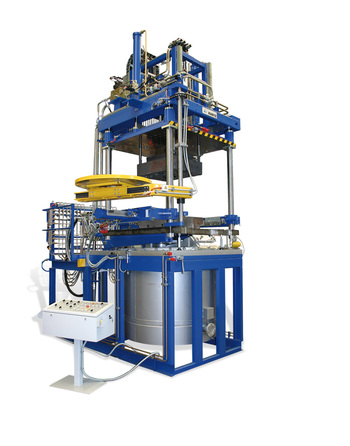

I love these thread, they give us the opportunity to inform the customers on the various options in the wheel industry - a complex industry!
Below is an article written by Carlos, lead engineer at MORR wheels, on all you need to know in the wheel manufacturing industry. You can combine flow forming with a cast or forged wheel to make a "hybrid". The MORR VS8.1 1 piece forged wheels have flow formed barrels for reduced weight. The Forgestars are a cast hybrid with flow formed barrels. They are our number one choice for lightweight, high quality, well priced wheels.
This information comes from over 5 years of experience in the automotive wheel industry. I’m an Industrial Engineer with a minor in Mechanical Design, I own two wheel companies, have dealt with every aftermarket forged wheel manufacturer in the world, have designed, engineered and manufactured very strong and light wheels in both cast and forged variants and have very close relationships with some of the leaders of the wheels industry in the USA including members of the SAE Aftermarket Wheel Committee and the SEMA Wheel Industry Council.
Article 1

Gravity casting is a method of manufacturing a cast wheel of an specific metal alloy, typically aluminum, although Magnesium is also used, which involves supplying molten metal to a mould cavity via a feeder through a running system where the molten metal entry point is located above the top of the mould cavity. In this manufacturing process all the metal entering the mould is subject to turbulence. This turbulence can cause severe defects such as oxide inclusions and entrapped gas porosity and in some cases mould erosion and hotspots.
Low-pressure casting in the other hand takes care of the disadvantages of Gravity casting by filling the mould by injecting molten metal at about 25psi through an in-gate just below the top of the mould cavity from a source under the mould through a method which allows complete filling of the mould. The force of gravity acts against the upward flow of the metal and eliminates the possible turbulence caused by the falling liquid metal. The molten metal is stored in a pressured container and by increasing the pressure metal is then forced into the mould.
In low-pressure casting the method in which the metal is forced into the mould is the main difference/advantage over gravity casting and is absolutely controlled. As explained above it results in a low turbulence or turbulence-free mould filling with little to no corrosion.
The molten metal in the furnace is in a closed container under protected atmosphere. Because of this the metal absorbs less hydrogen and any other impurities as well as the oxide formation being greatly reduced. As opposed to gravity casting, the metal surface is not interrupted constantly since it is been forced from under the metal surface. What you get is a very clean quality metal.
Basically low-pressure casting uses positive pressure to move molten metal into the mold quickly thus resulting in a finished product with an Aluminum that is denser than Gravity cast.
The advantages of low pressure die casting process are several:
