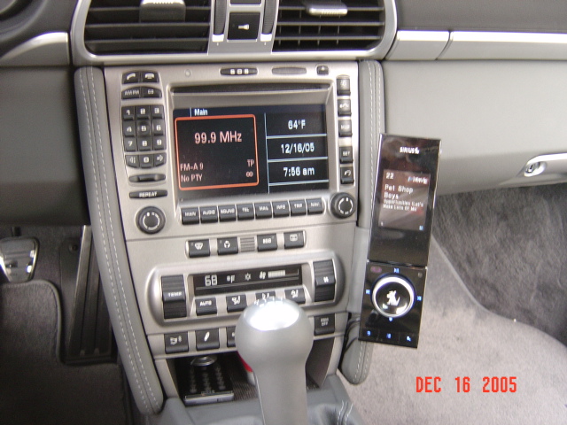

This is the 3rd install try of my Sirius S50 radio. It works perfectly.
The FM modulator is hard wired to the unit and the car antenna. It stops the signal from the car antenna and then sends a signal through to the radio. It is very clear. In fact I set my Sirius to the strongest station in town and it played through perfectly. The S50 is very sleek looking. It records up to 50 hours of Sirius program or MP3 from your own collection. It doesn't look too out of place mounted in the car. This is 100% better than a transmitted FM modulator. The top head removes for carry with earplugs, recorded material only though.
These are the part numbers from Crutchfield to make it work.
# 60714110 FM Modulator relay
#12040EU10 Euro Antenna Adapter OEM F to Motorola M
#12040EU20 Euro Antenna Adapter OEM M to Motorola F
The install was about 5 hours from start to finish. The antenna for Sirius is under the plastic cowl under the windshield wipers. This is also where Porsche puts the GPS antenna. With the radio, parts, and installation its around $1000.
