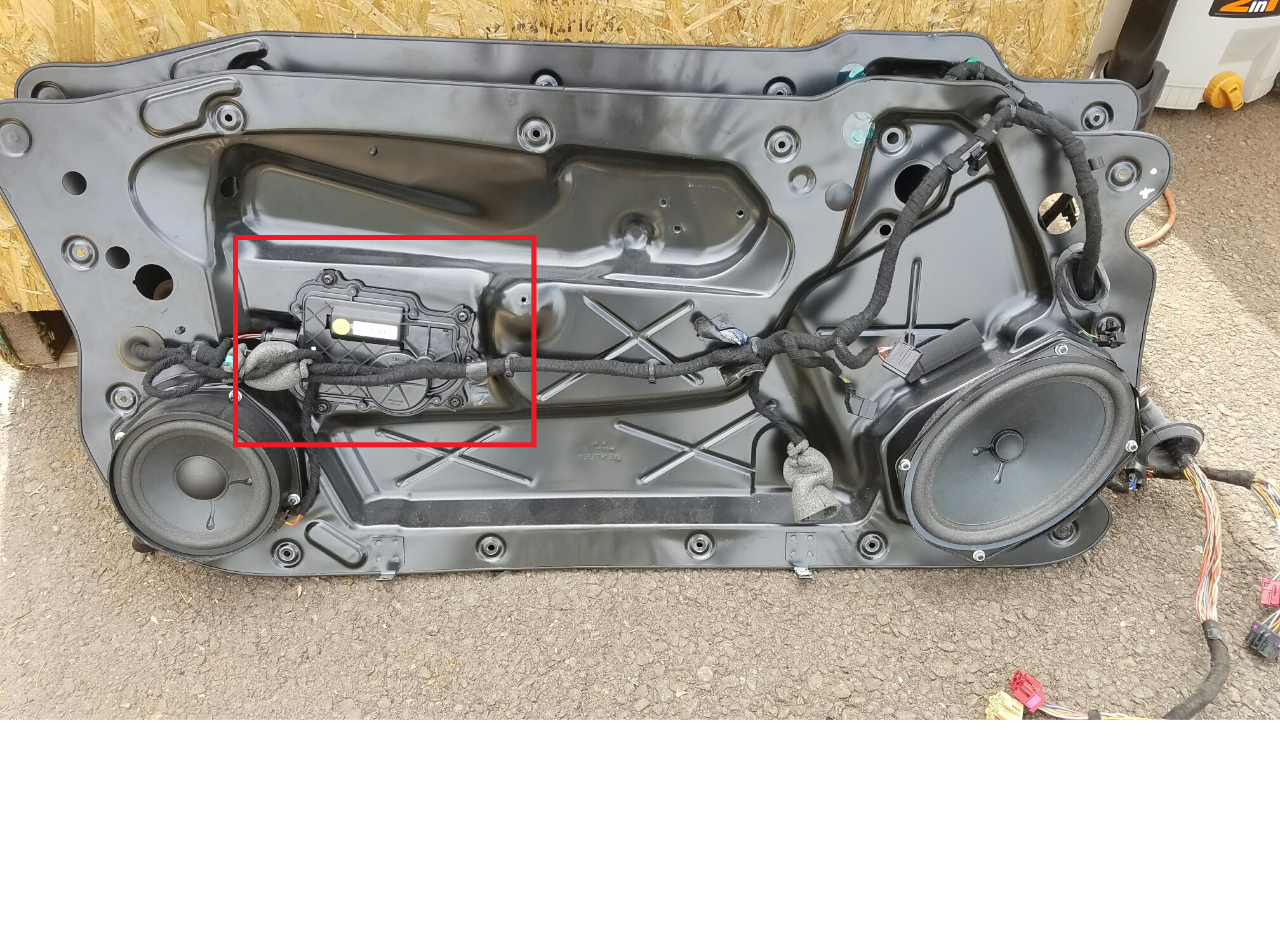

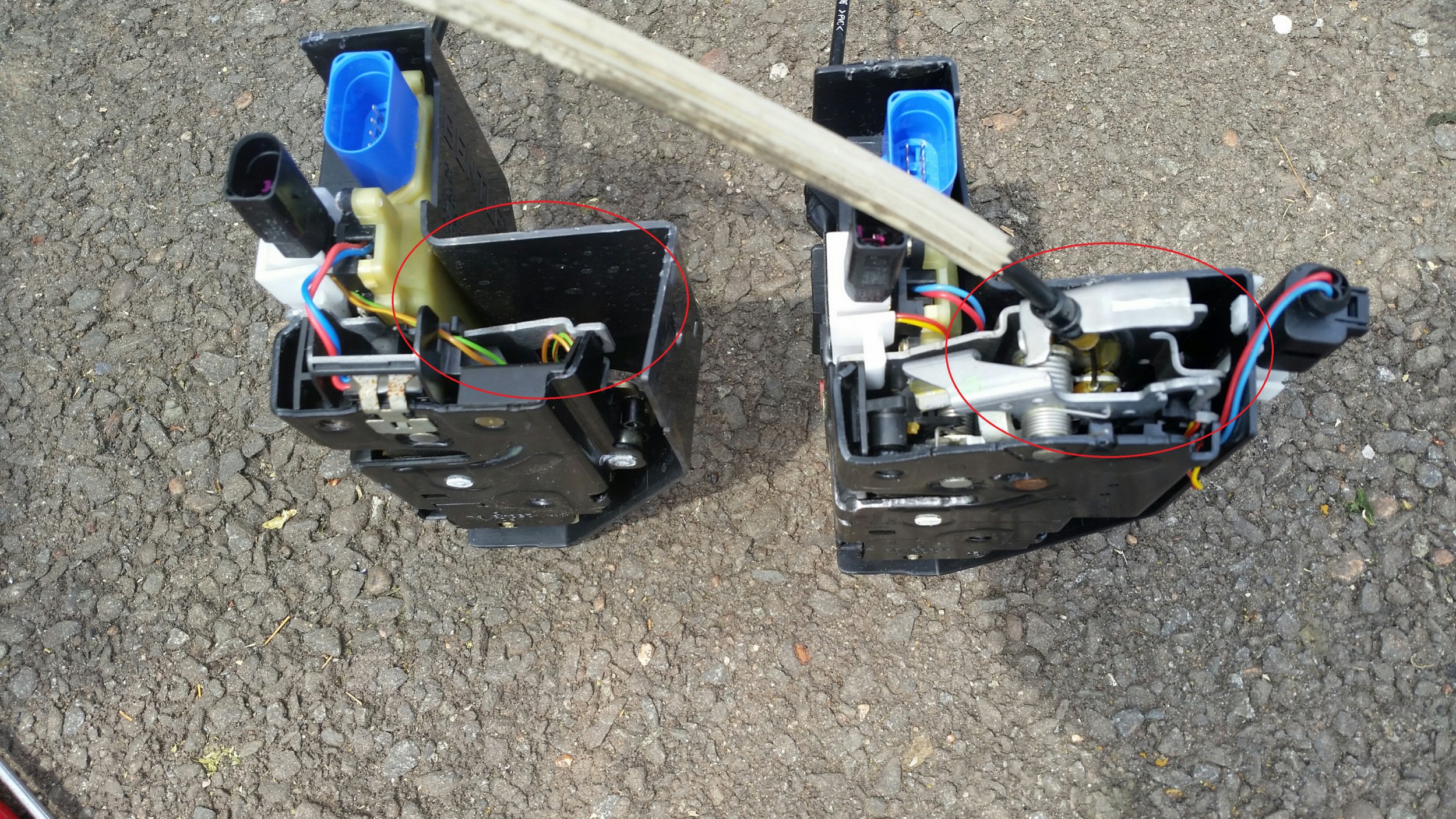

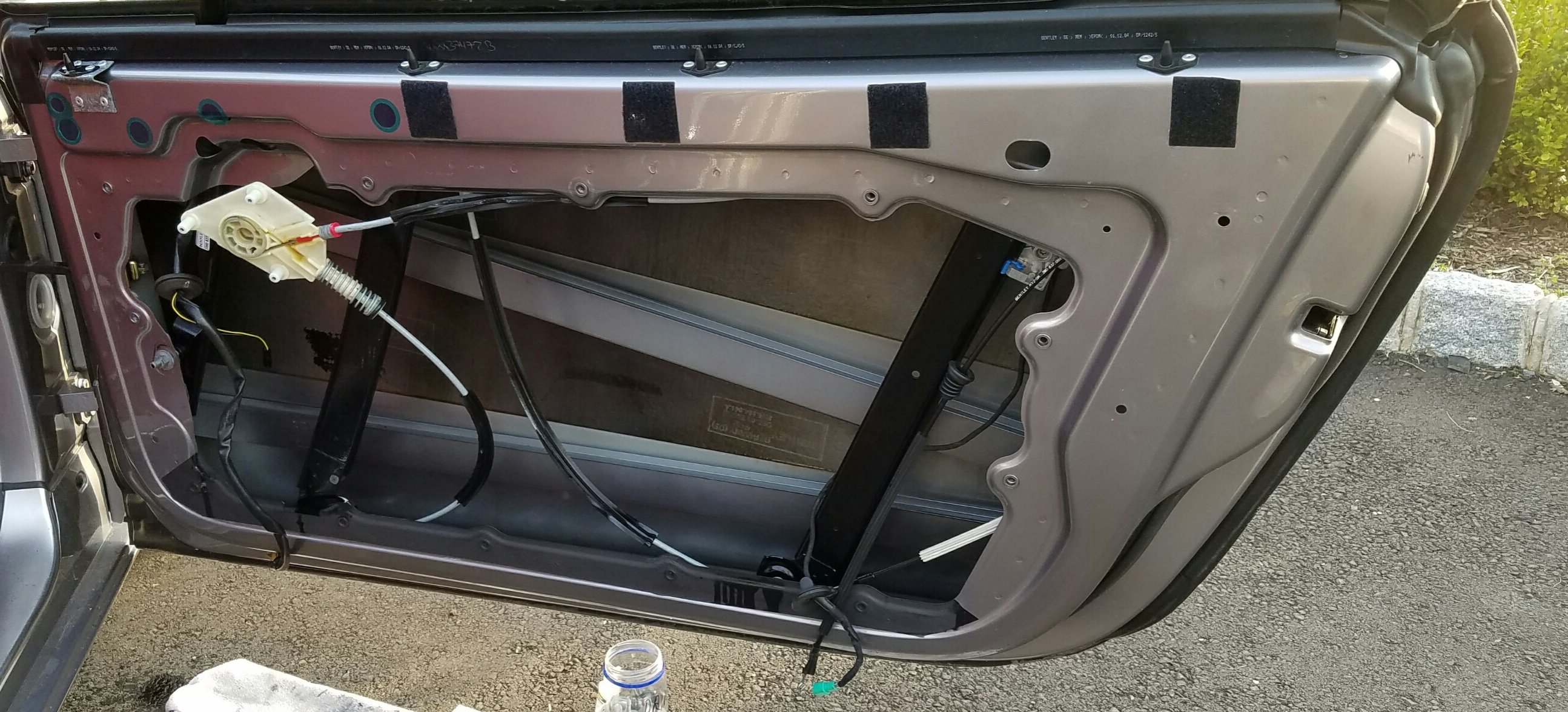

Originally Posted by joc44
Soft close doors i like, was there much to it, was the car just normal doors first or rusted up ones and just replaced them with ones from the donor car.
is it plug and play or so much more.

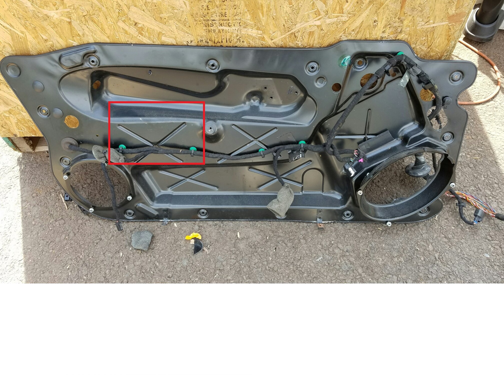

Hello Joc44,
I am sorry to report that adding soft close is not plug and play, not only are the extra wires not in the main harness of the vehicle without soft close, the inner door panels have a recess for soft close when so optioned, along with the soft close latches.
As to your other question about my doors, those are my original doors non soft close, gutted and updated.

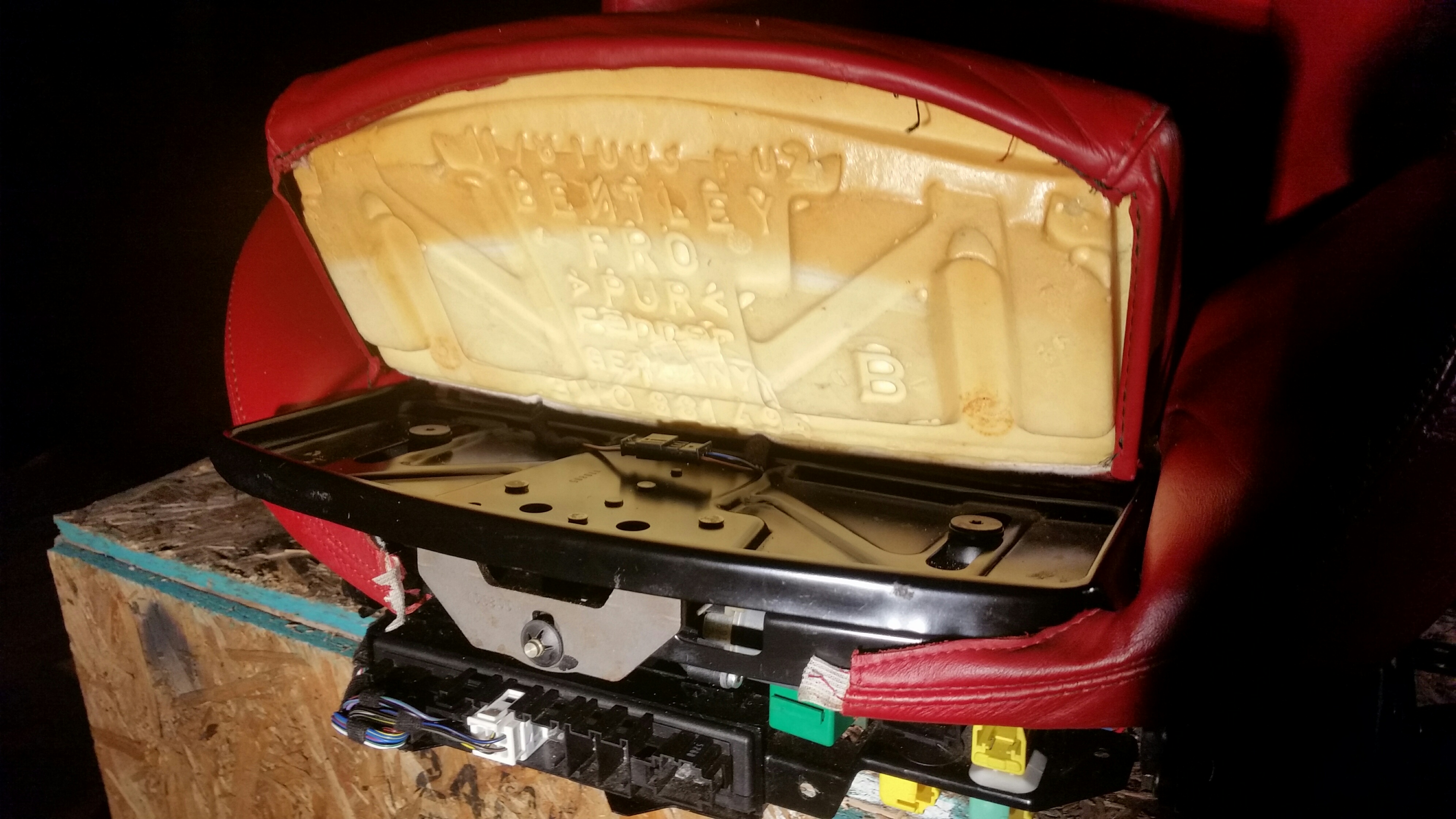

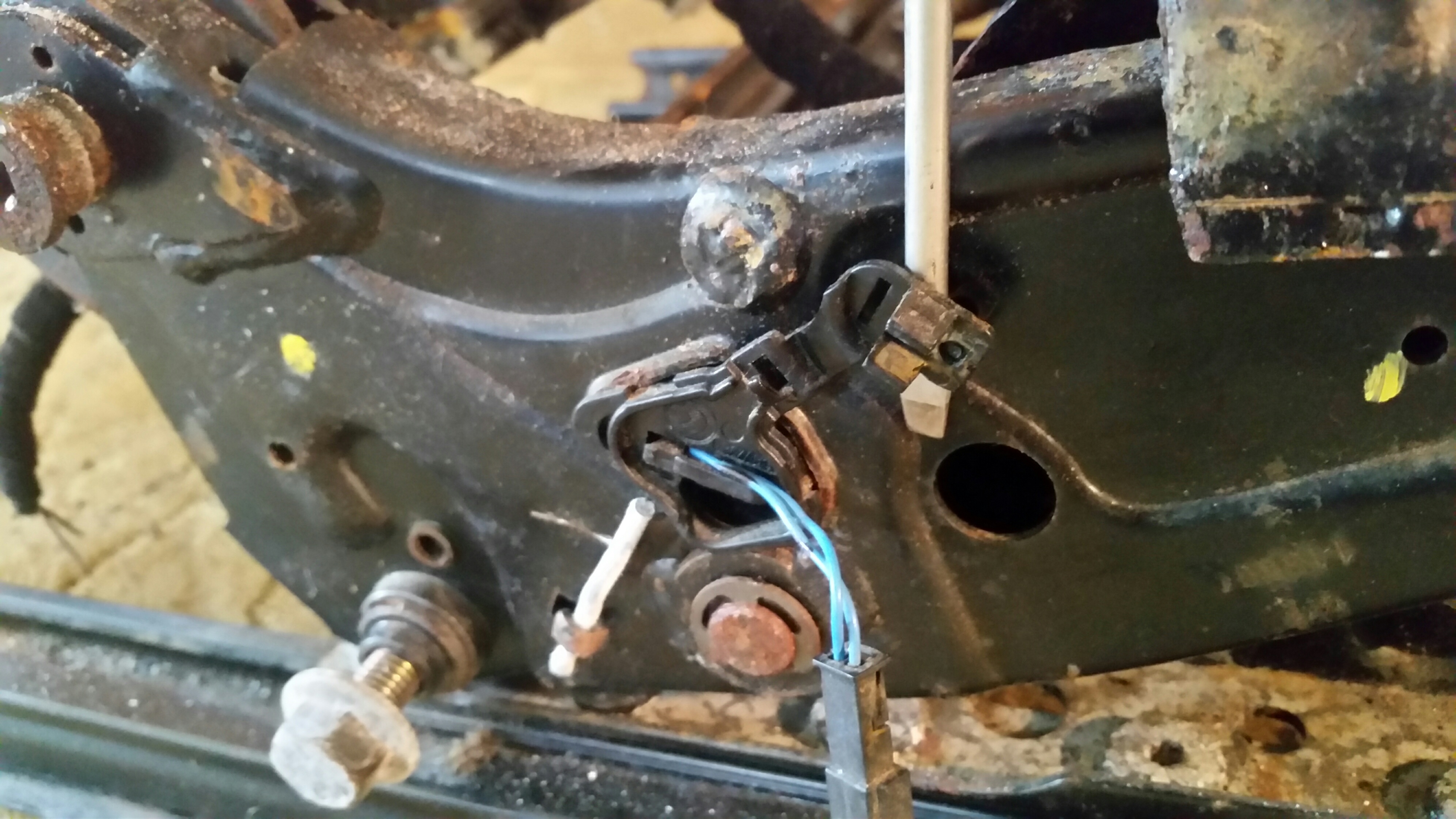

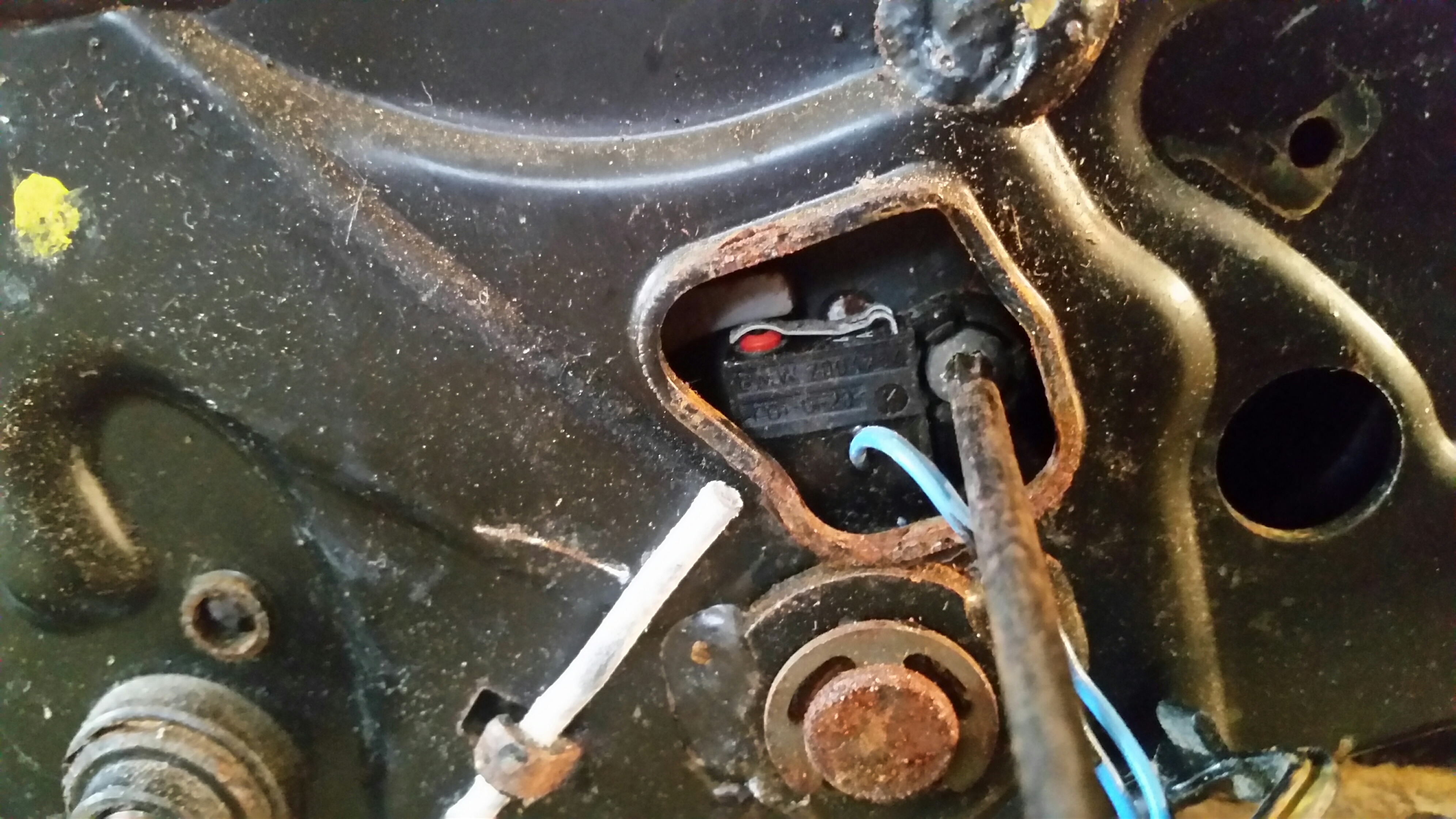

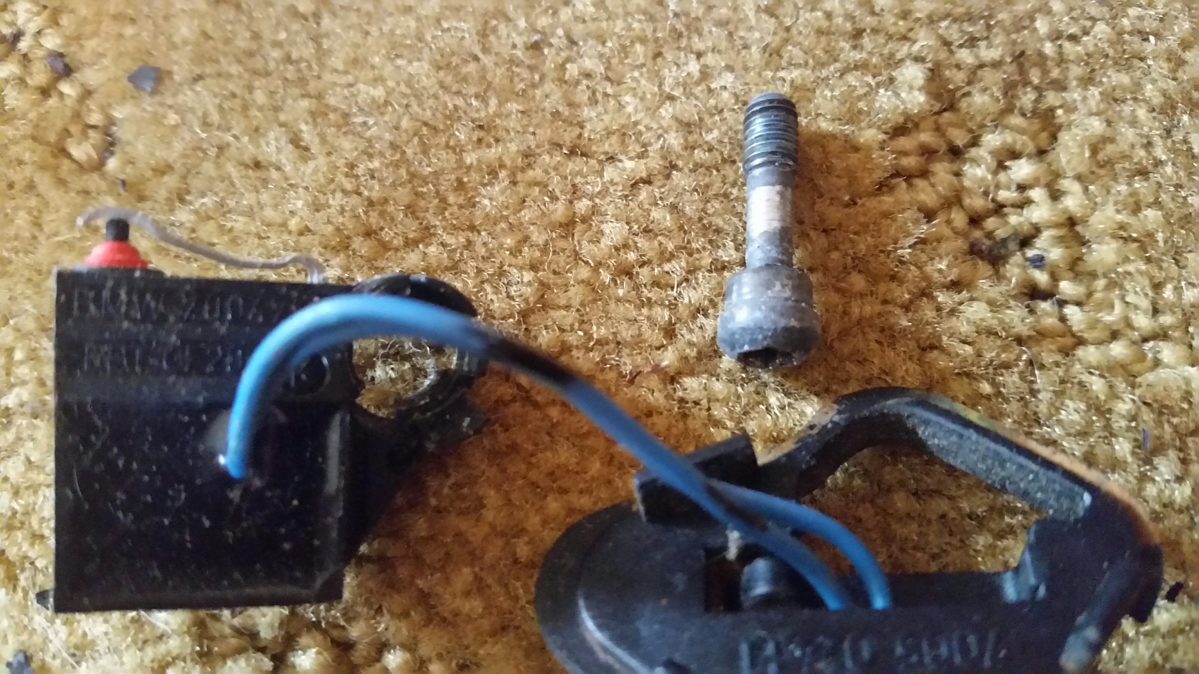

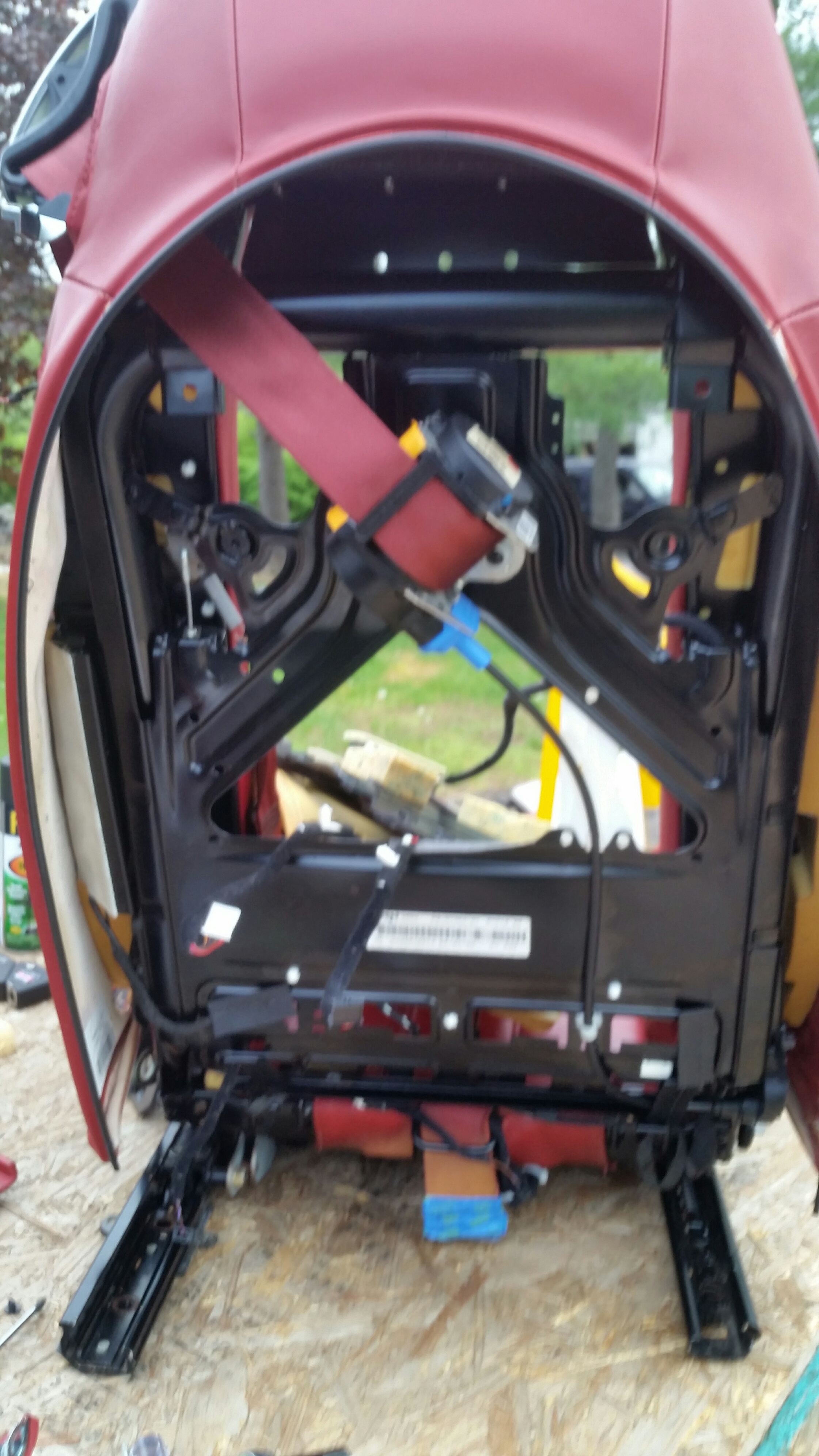

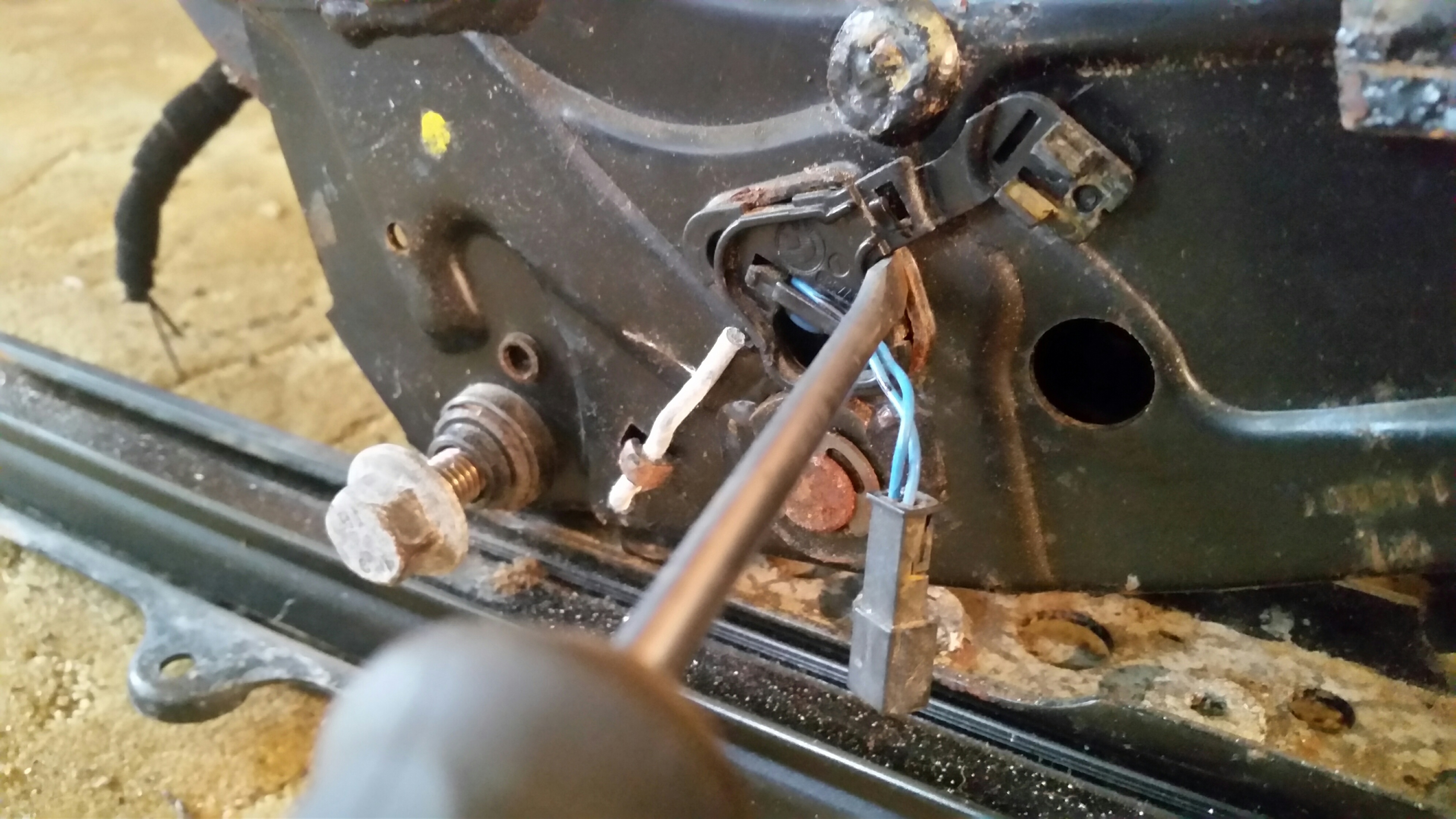

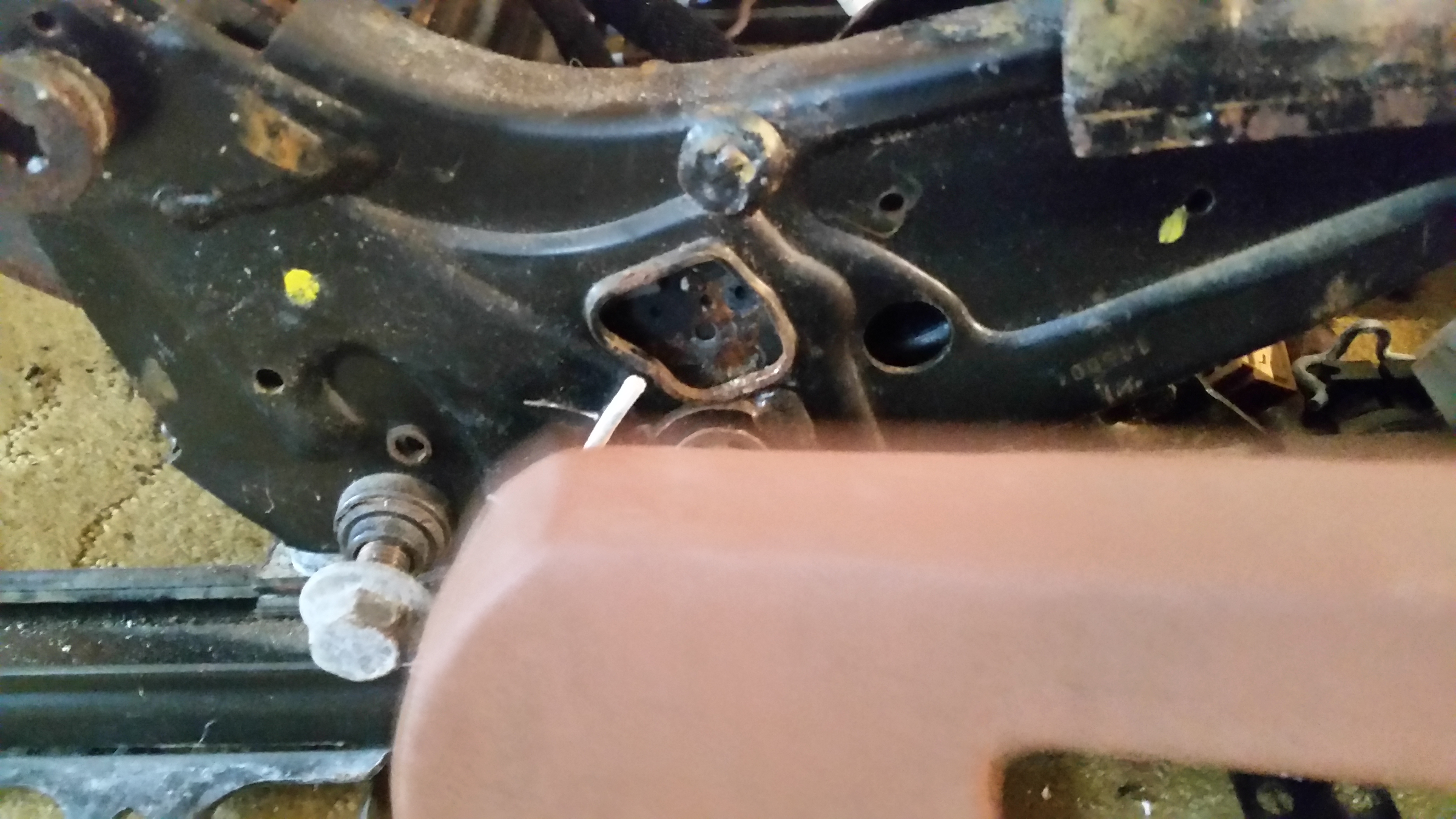

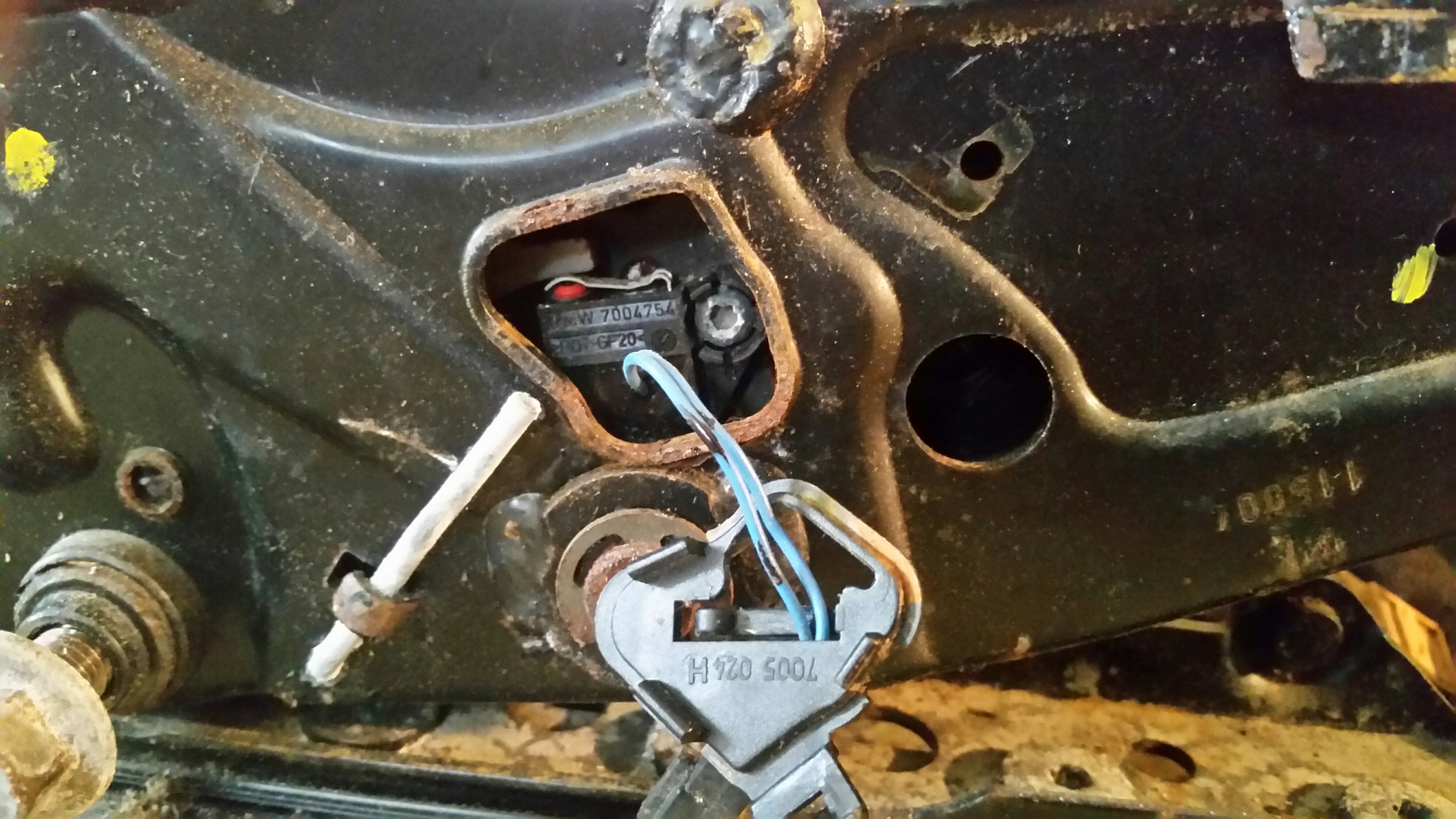

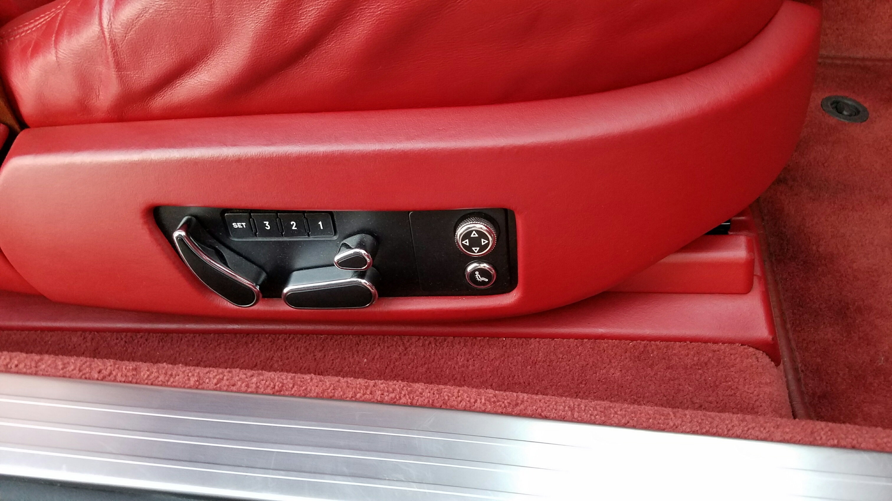

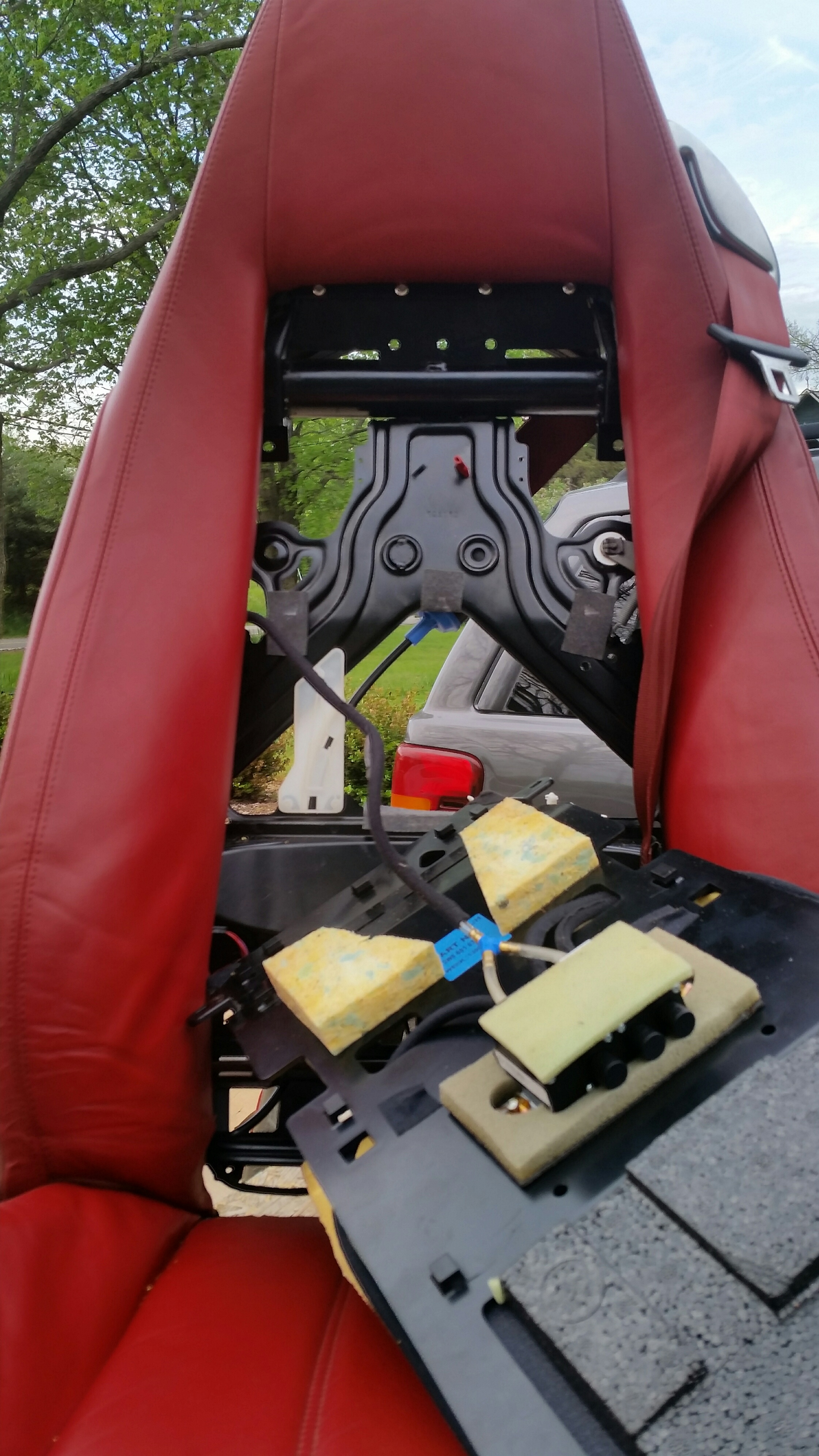

J JJ,
Can i ask when you had the front seats apart, the micro switch that tells you on the dash
BACK REST NOT LOCKED, is playing up in mine when i go round corners can you put a good pic on the post of where it is.
Thanks John
  #68
Old 05-02-2016 | 09:14 AM
Johnny Hotspur GT's Avatar
Administrator
Joined: Jul 2014
Posts: 3,446
From: Montgomery NJ
Rep Power: 1002
Johnny Hotspur GT Is a GOD !Johnny Hotspur GT Is a GOD !Johnny Hotspur GT Is a GOD !Johnny Hotspur GT Is a GOD !Johnny Hotspur GT Is a GOD !Johnny Hotspur GT Is a GOD !Johnny Hotspur GT Is a GOD !Johnny Hotspur GT Is a GOD !Johnny Hotspur GT Is a GOD !Johnny Hotspur GT Is a GOD !Johnny Hotspur GT Is a GOD !

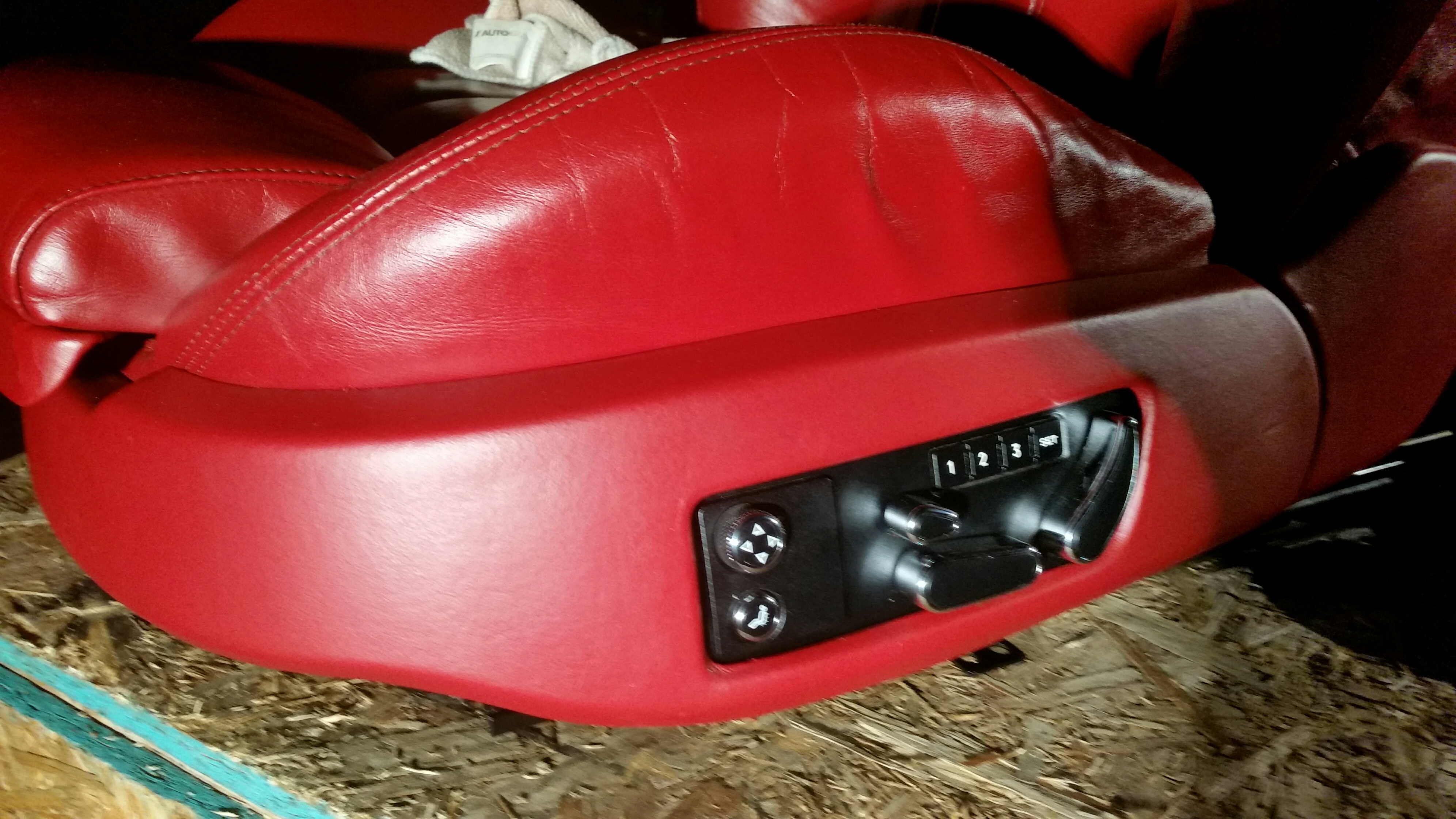

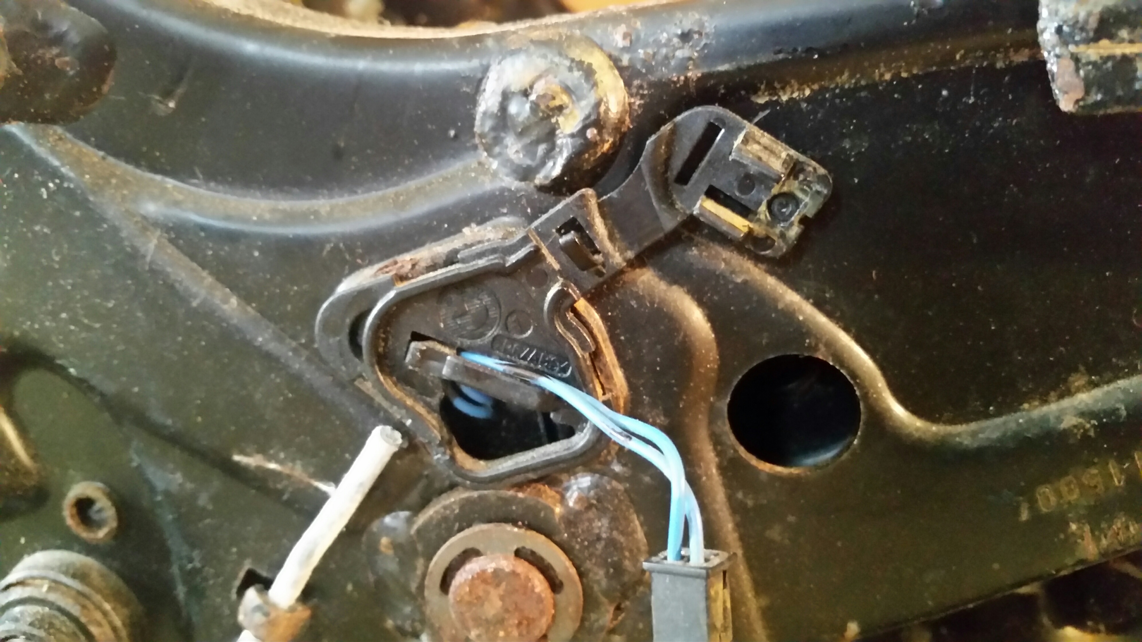

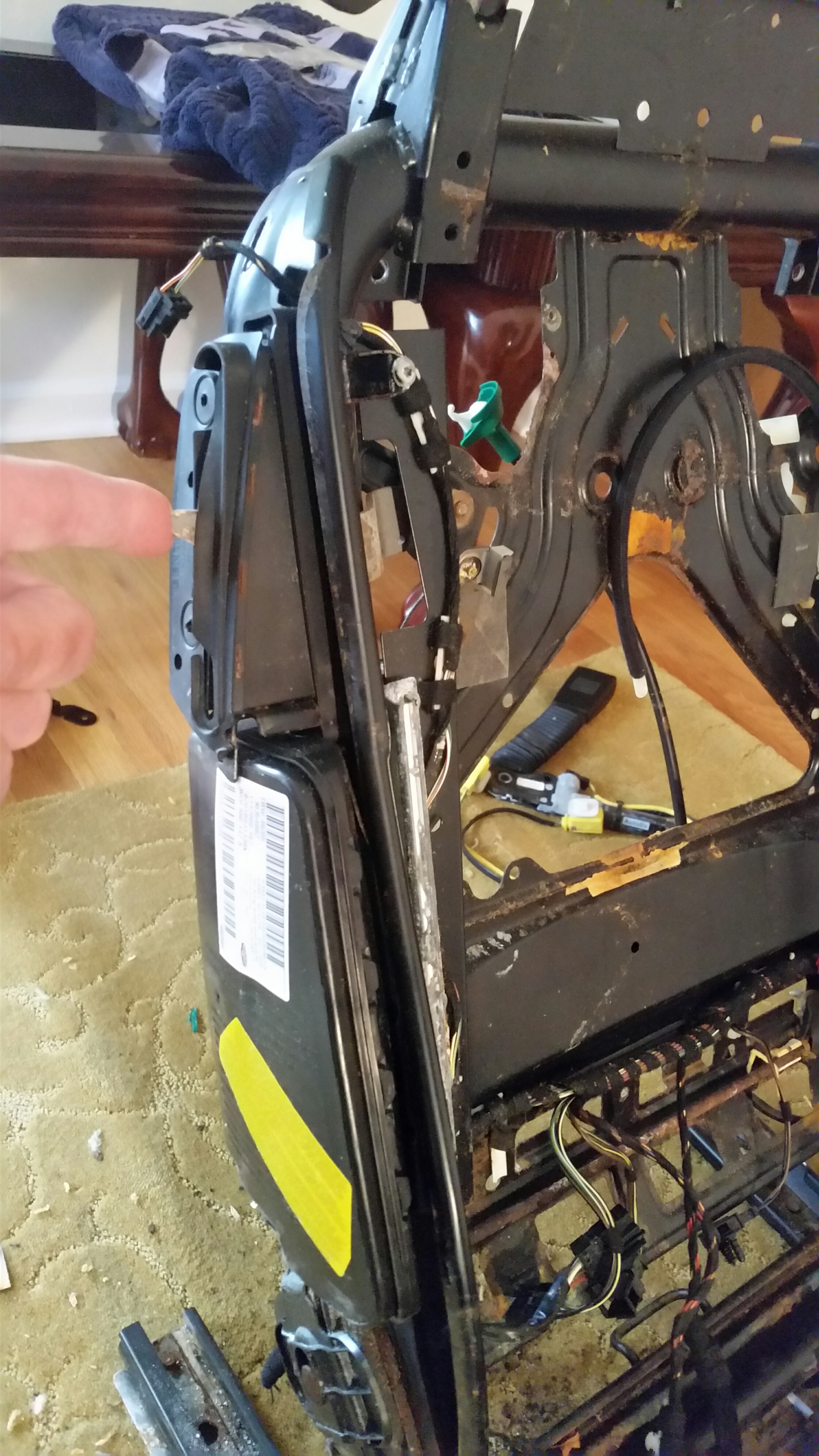

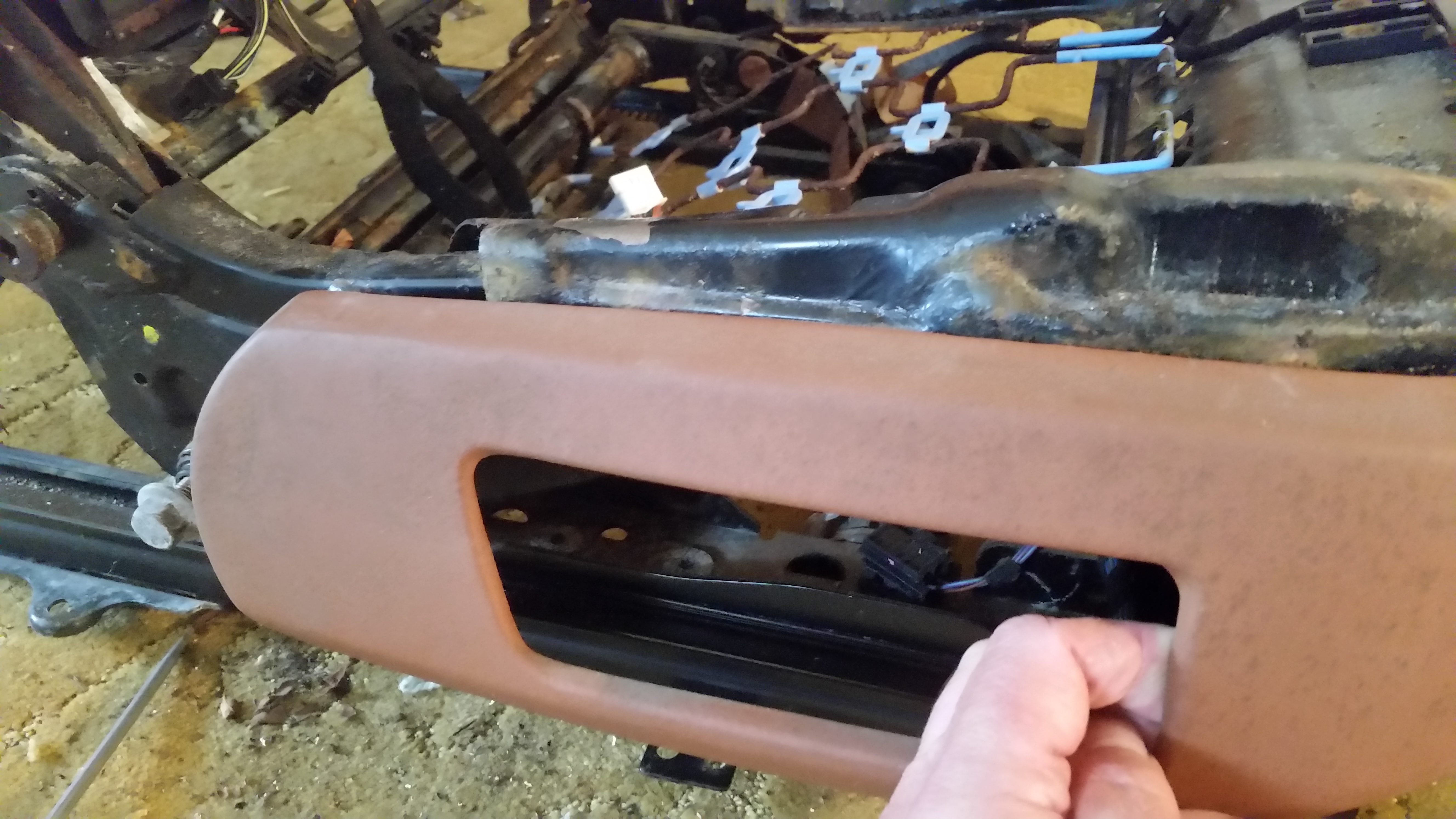

J JJ,
Thanks John

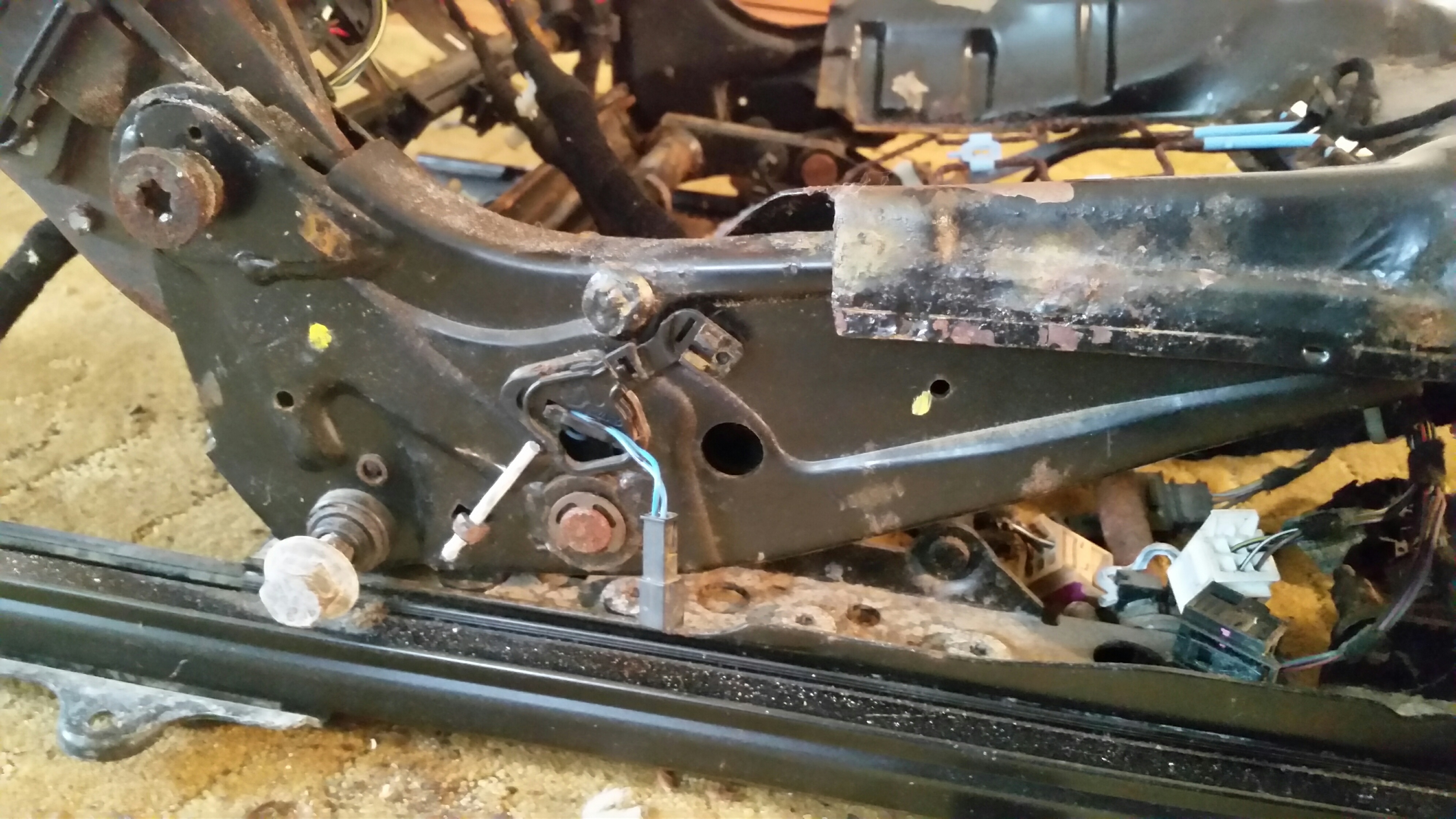

Here you go John,
So by removing the seat switch control trim you should be able to access the micro switch.
ID:	447309   Click image for larger version
ID:	447310   Click image for larger version
ID:	447311   Click image for larger version
ID:	447312   Click image for larger version
ID:	447314   Click image for larger version
ID:	447315   Click image for larger version
ID:	447316   Click image for larger version
ID:	447317   Click image for larger version

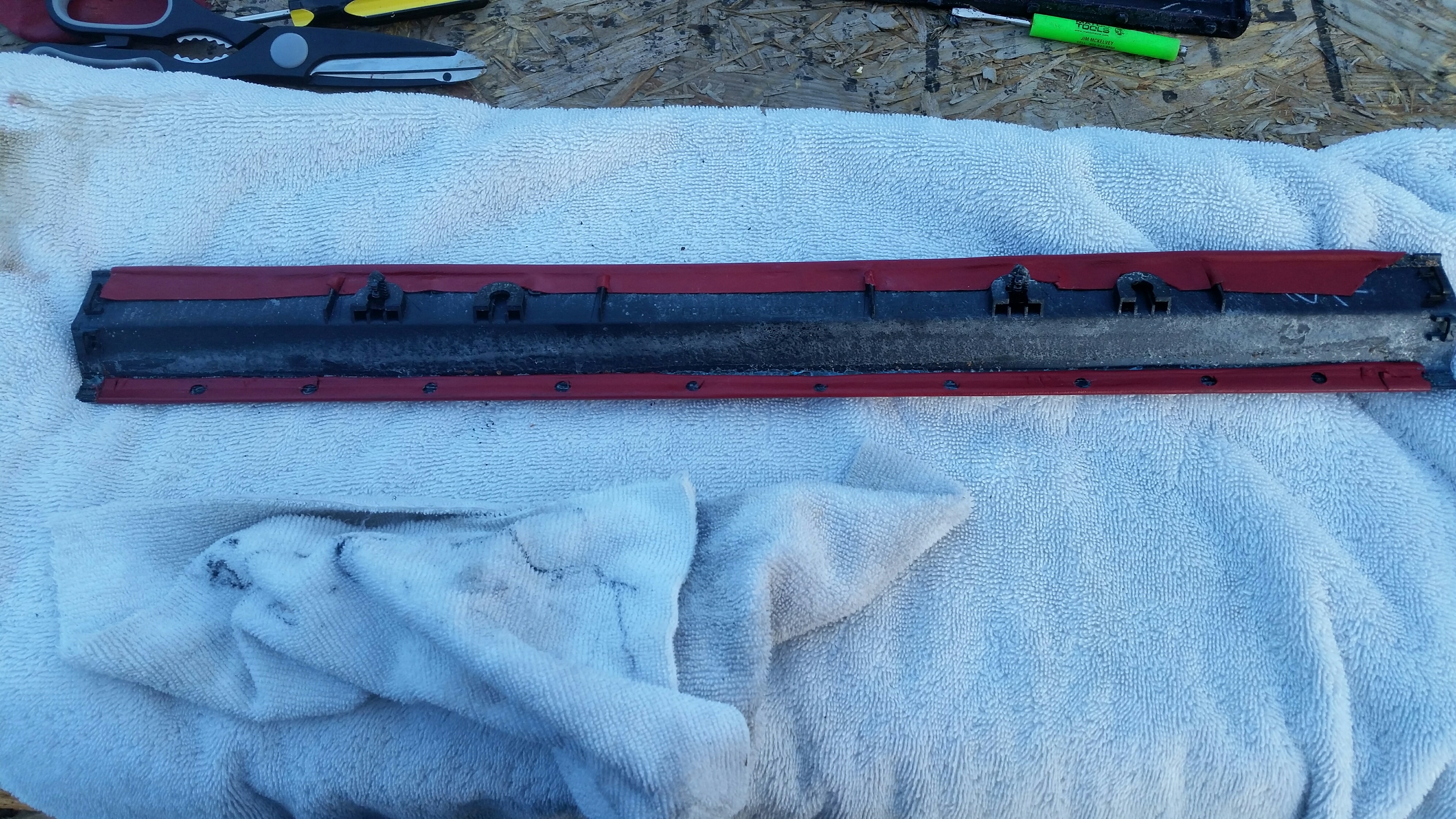

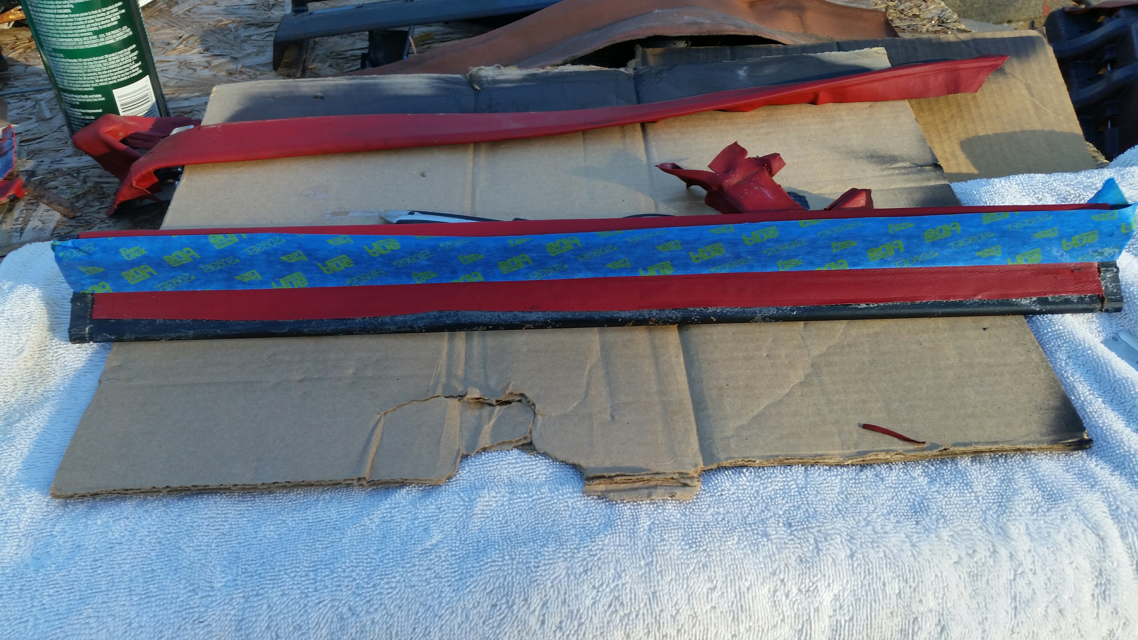

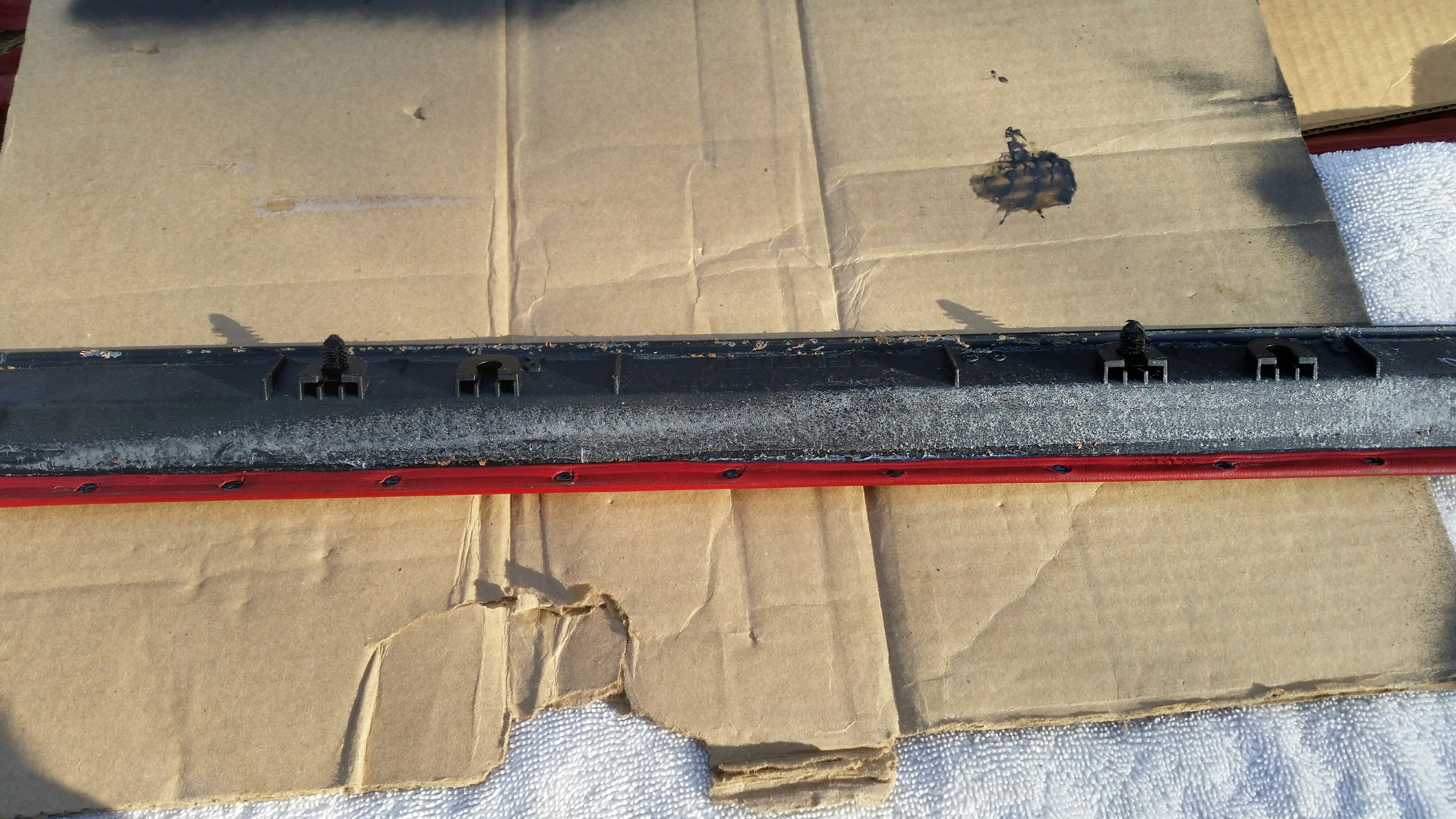

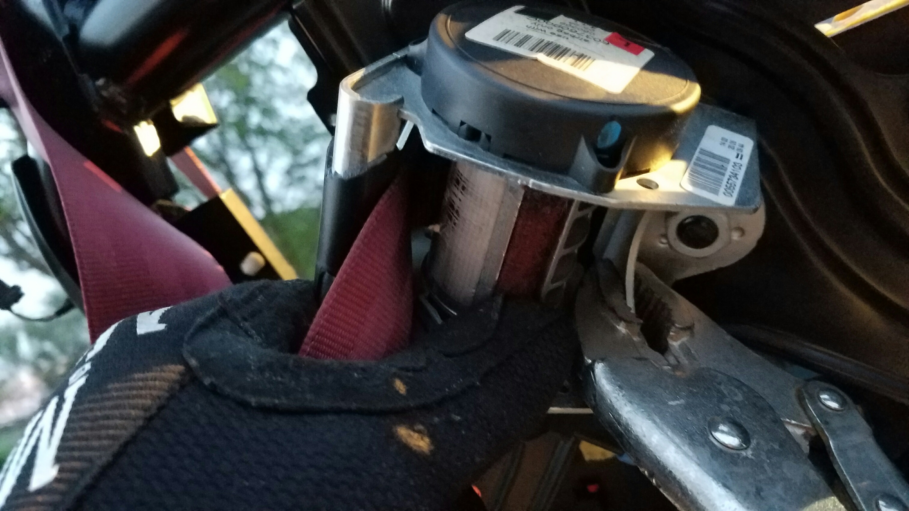

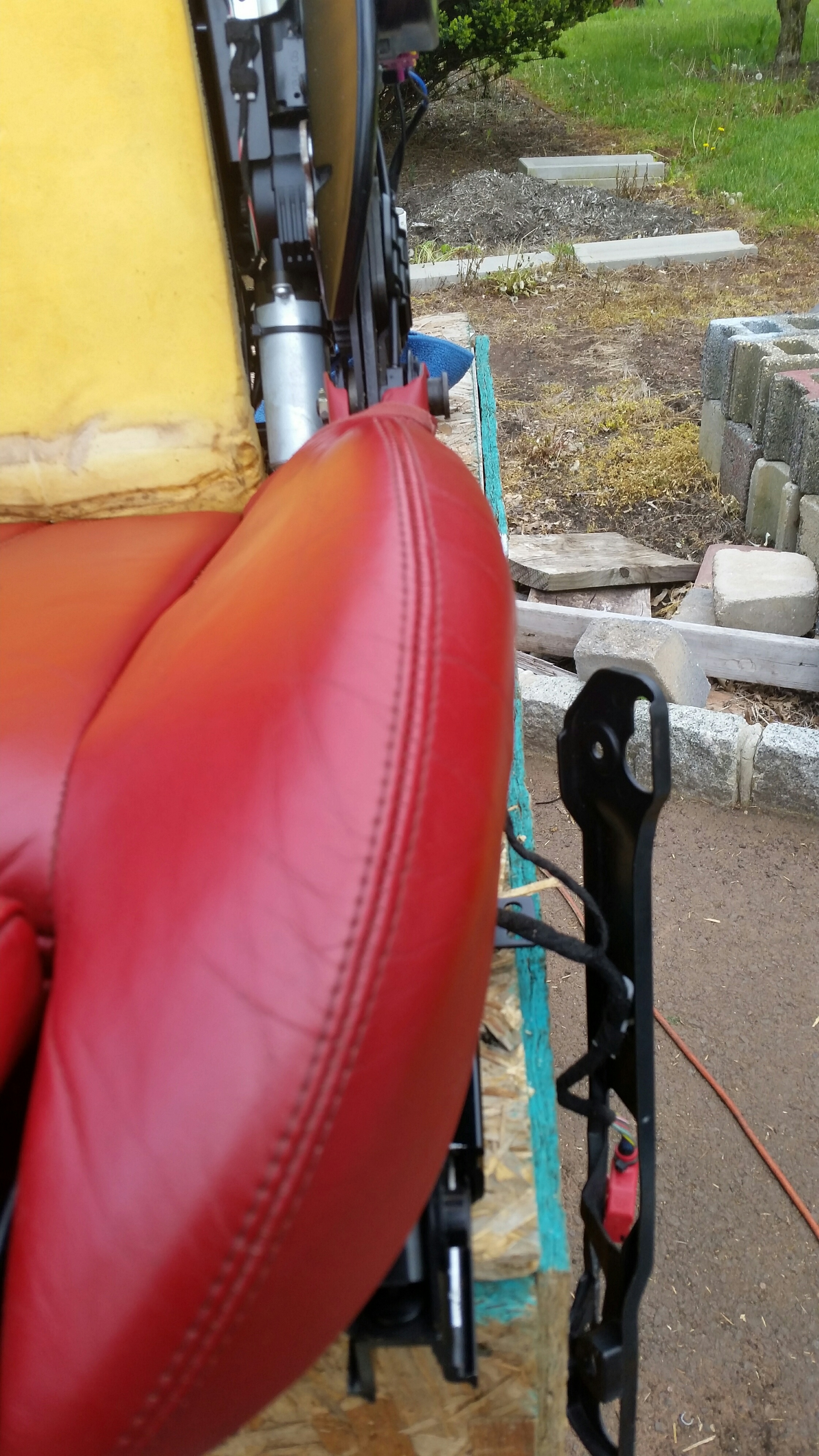

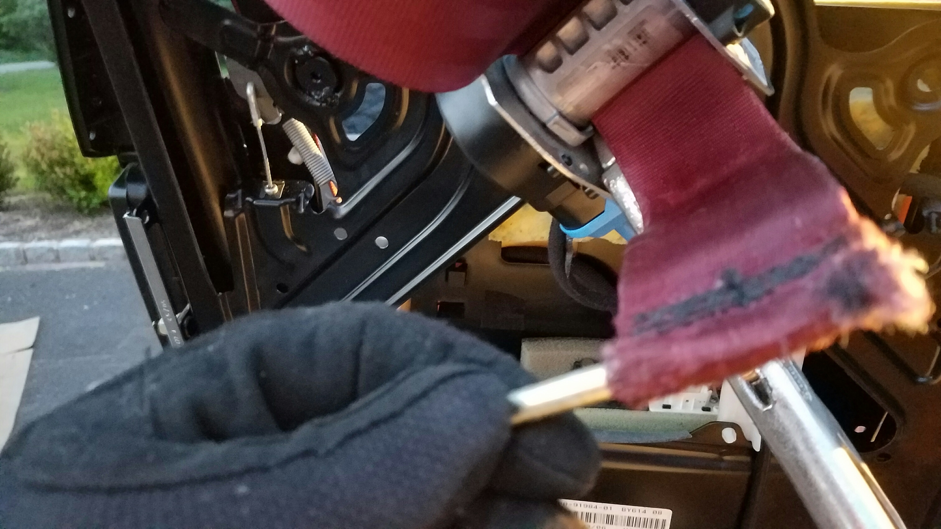

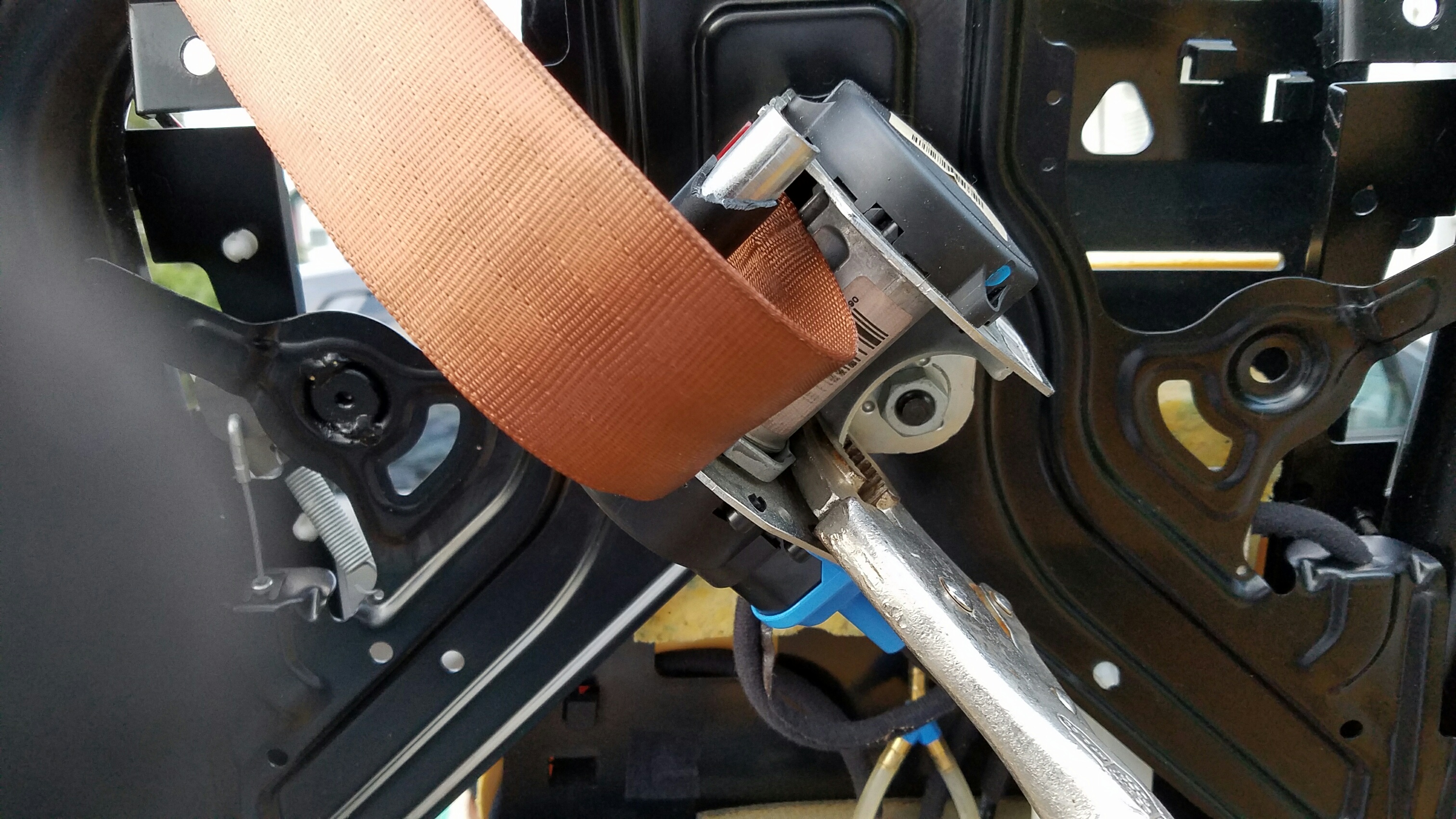

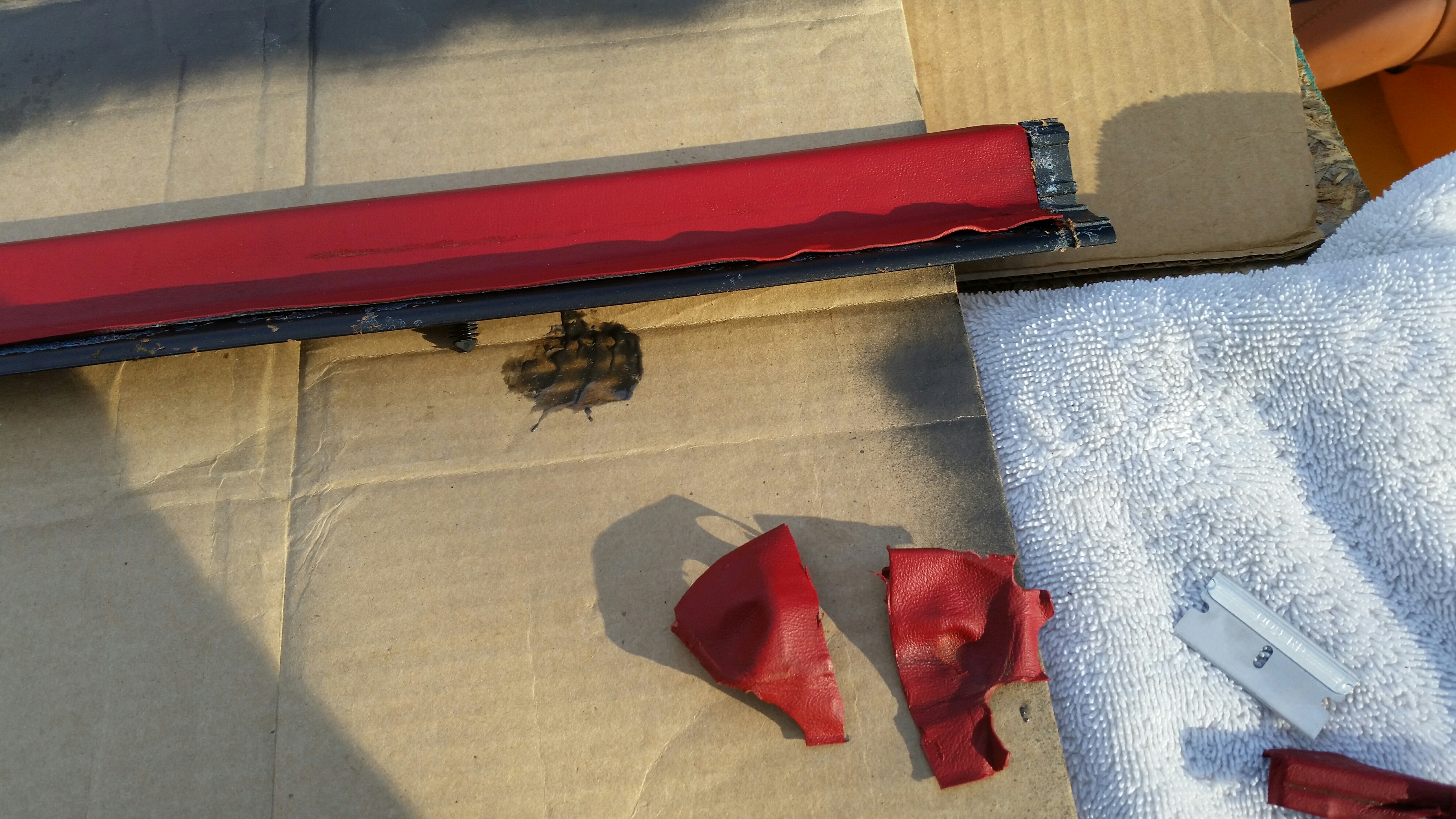

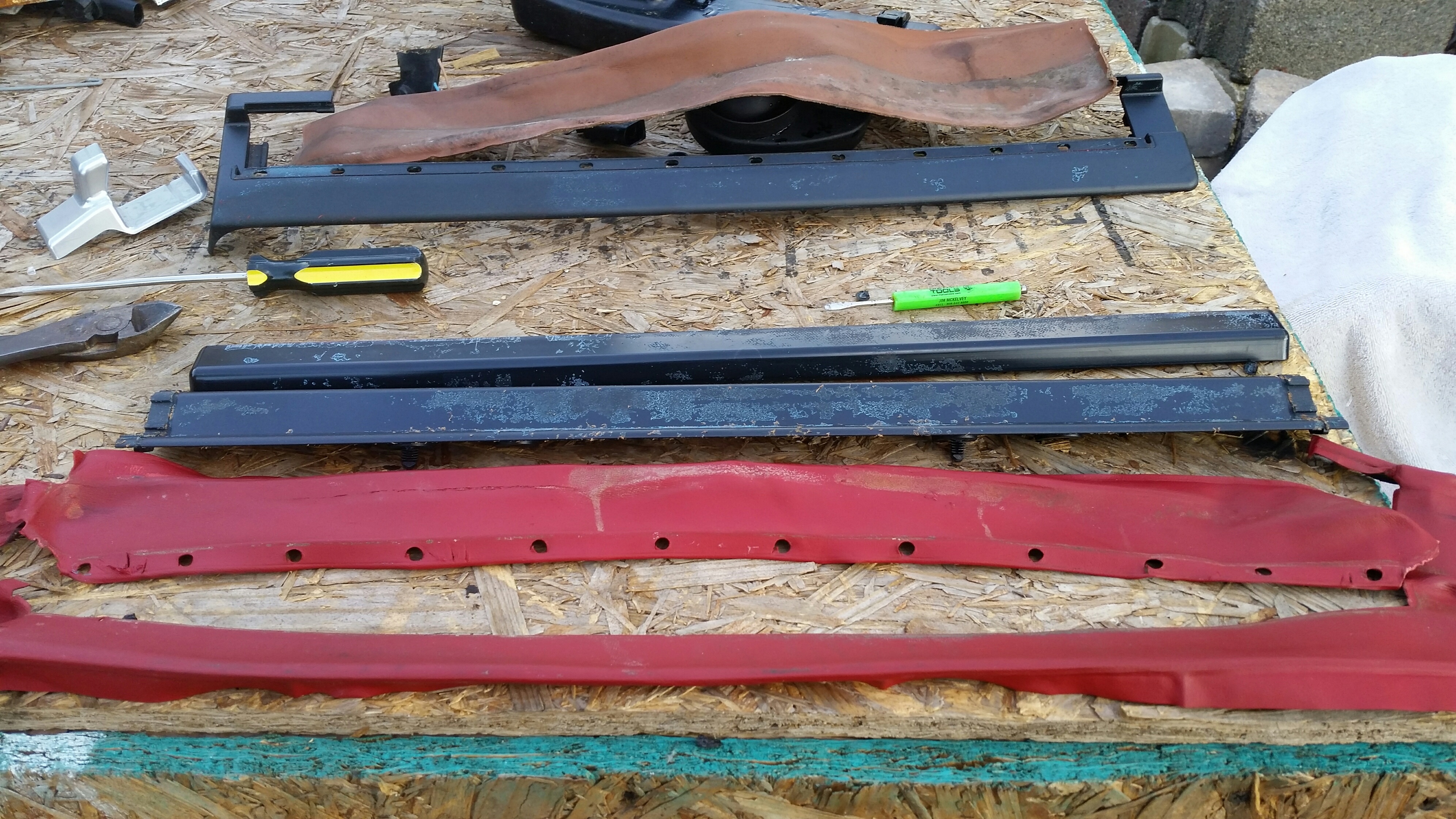

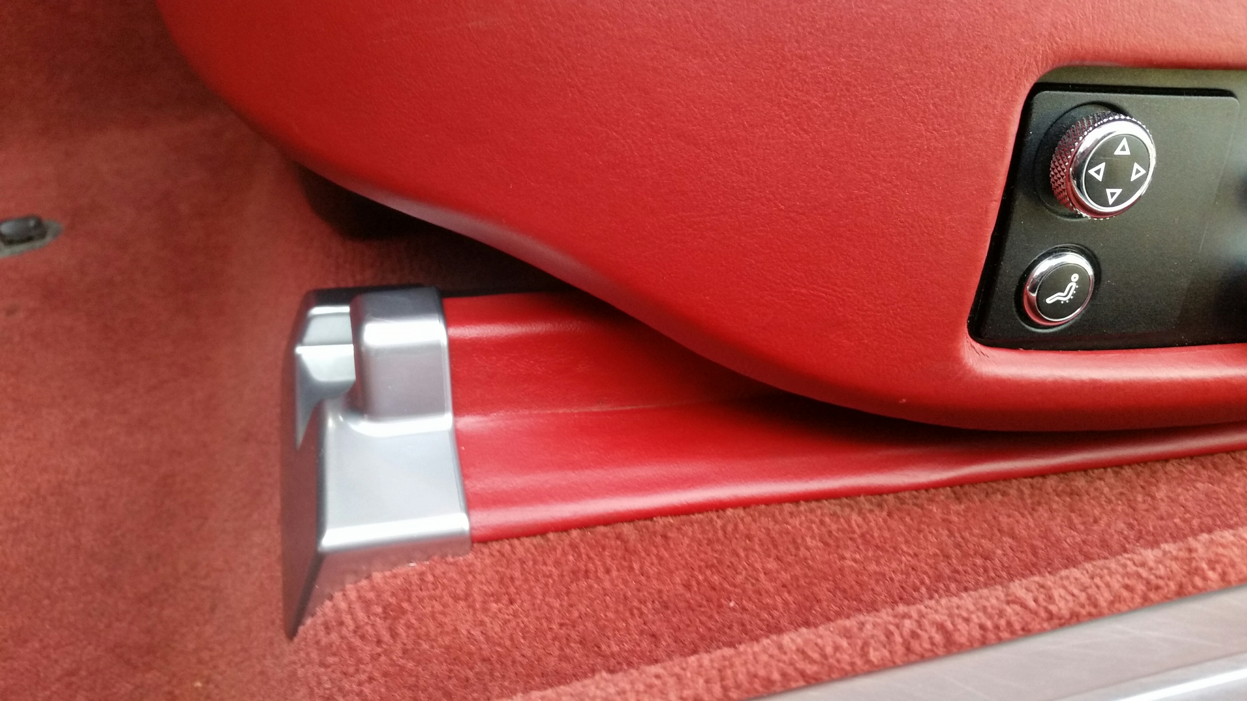

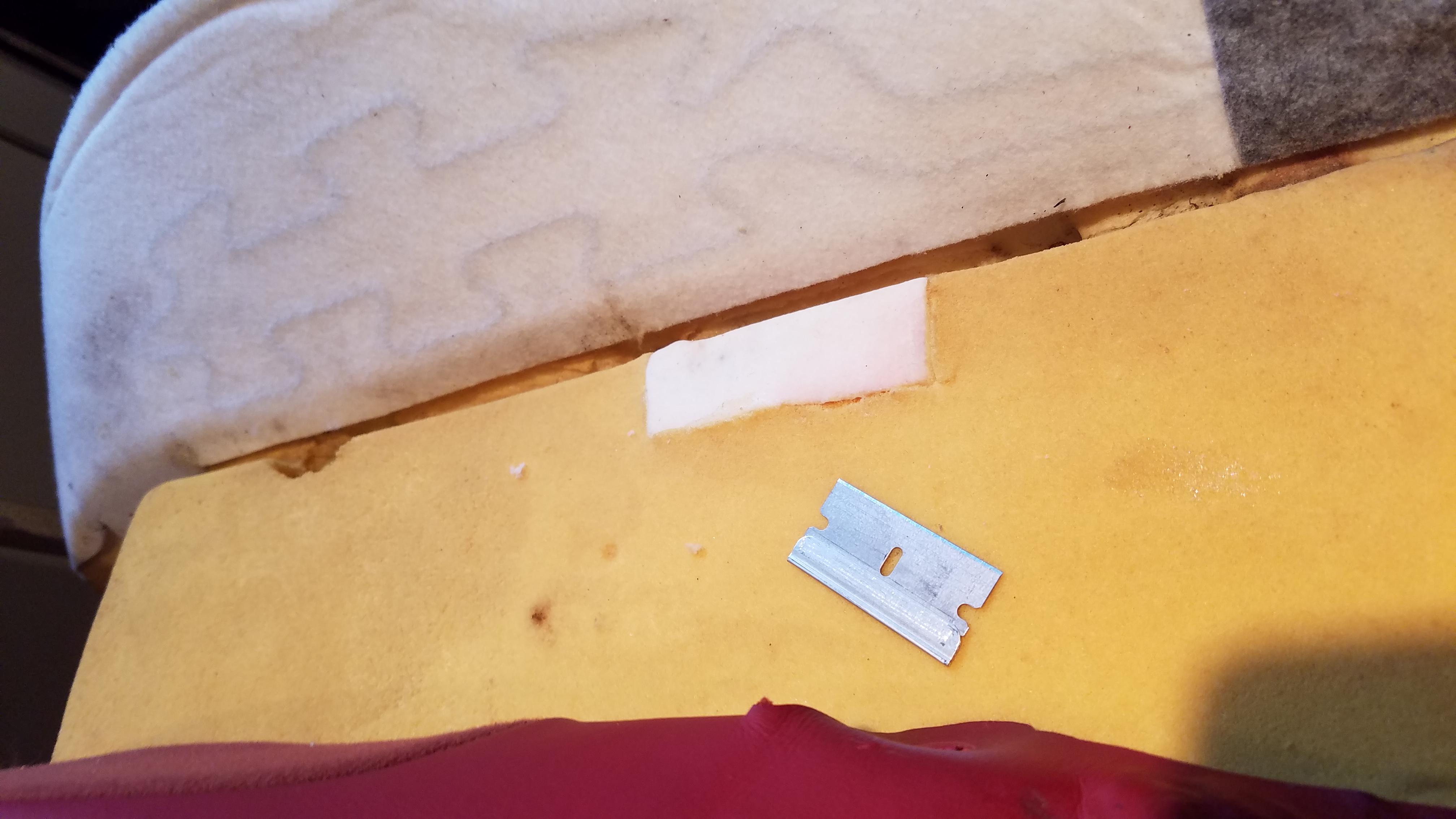

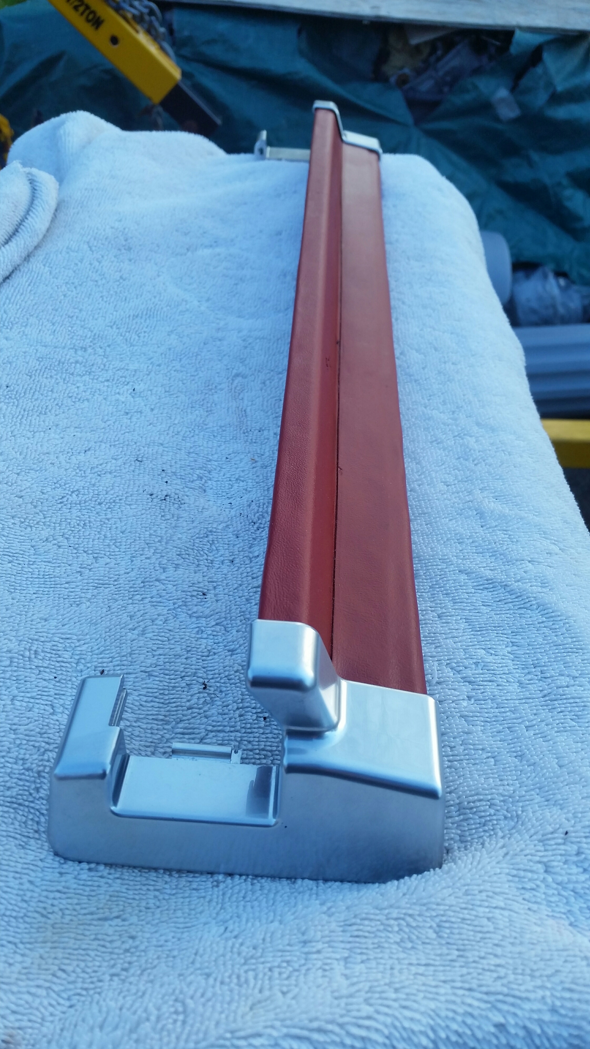

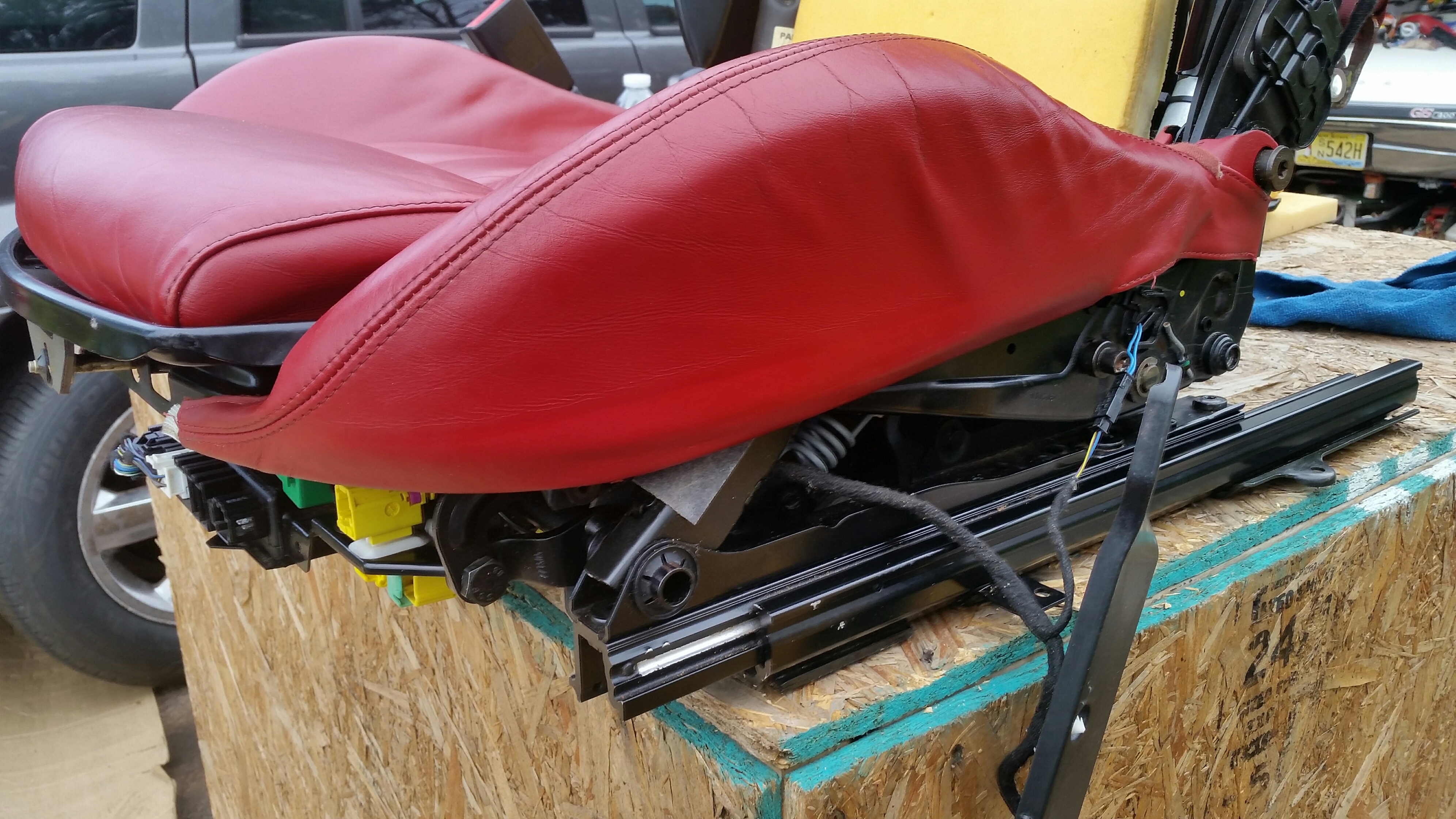

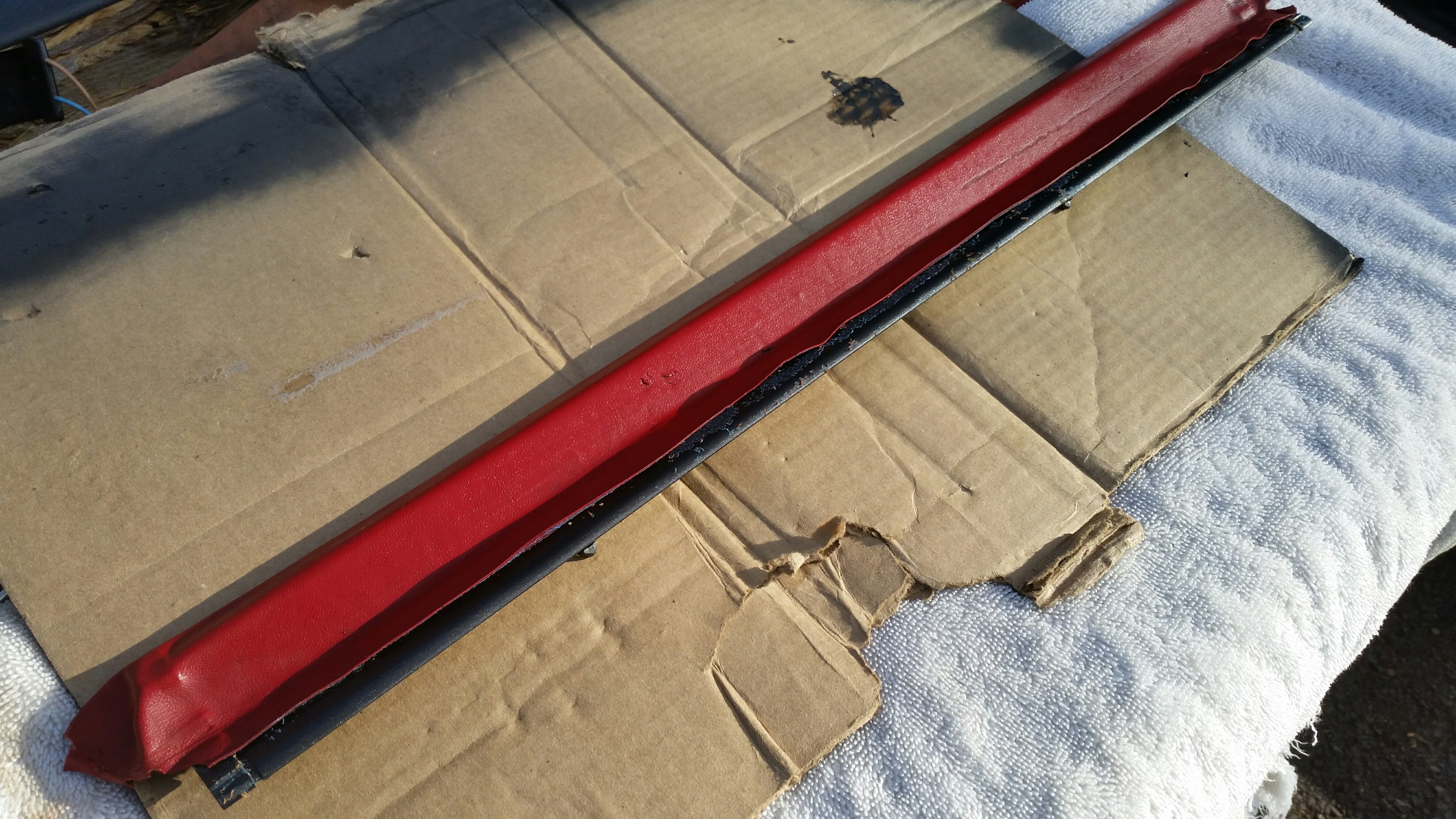

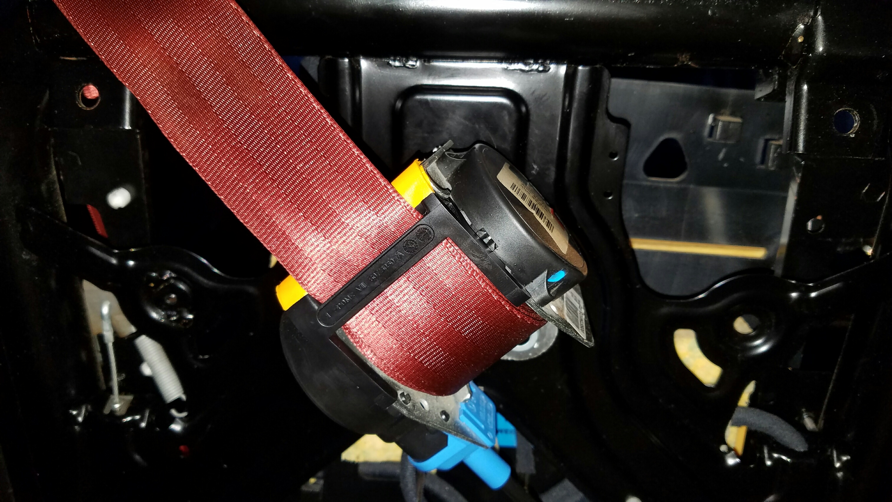

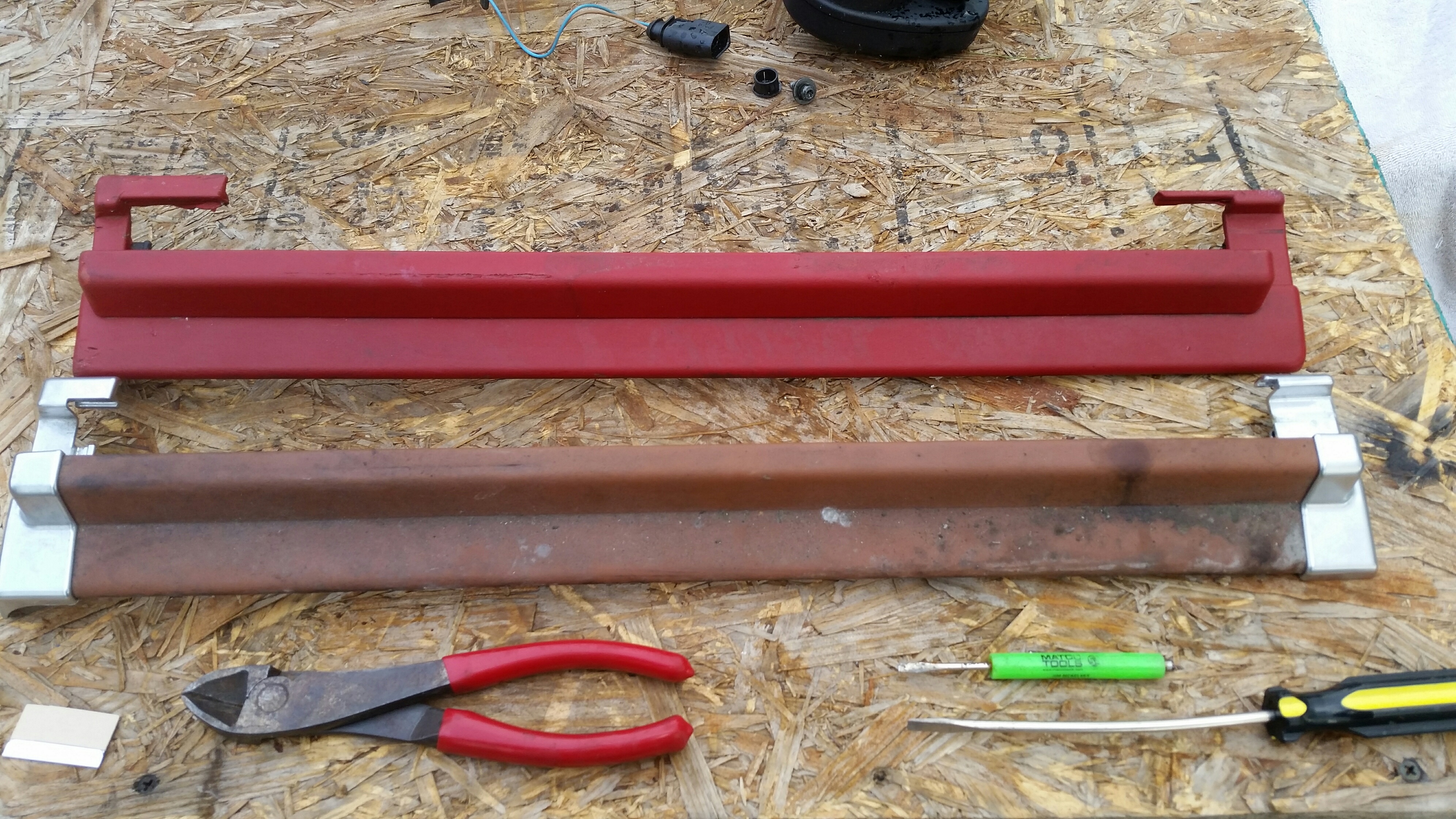

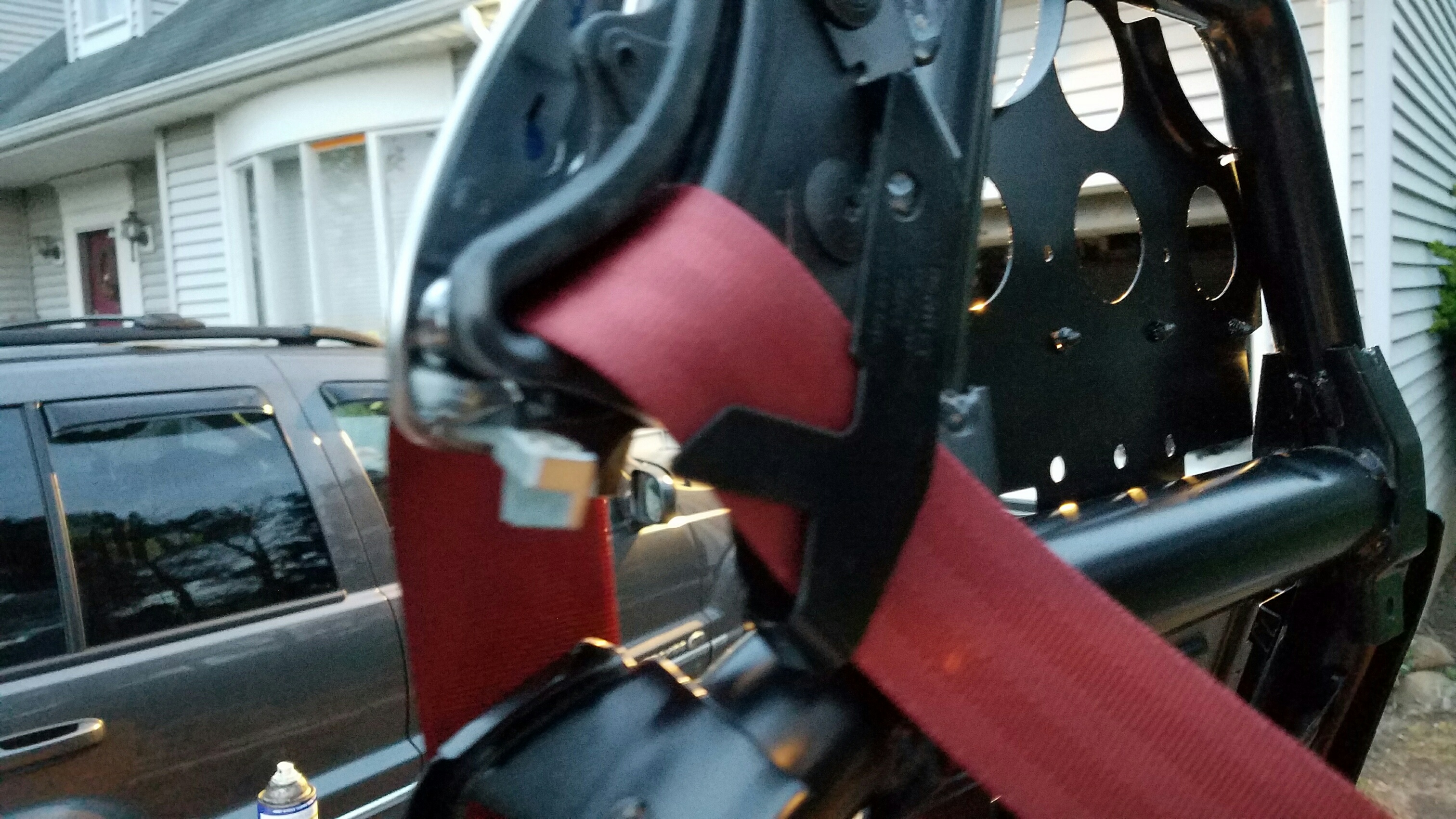

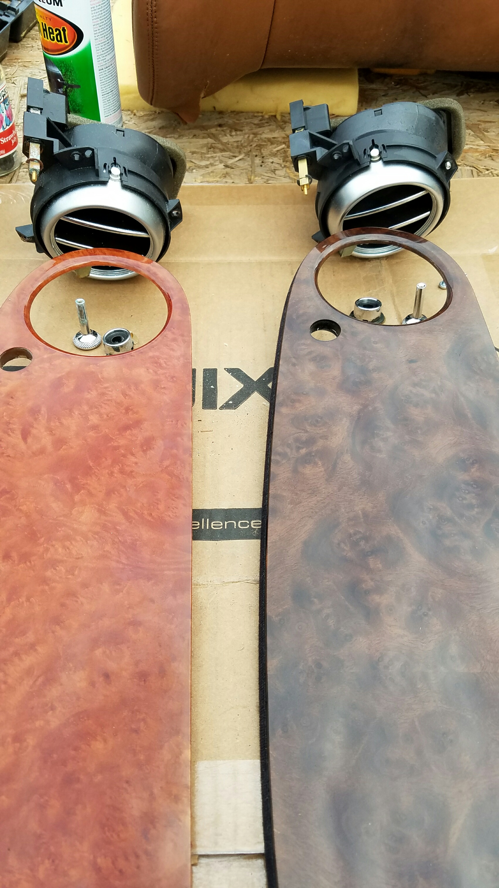

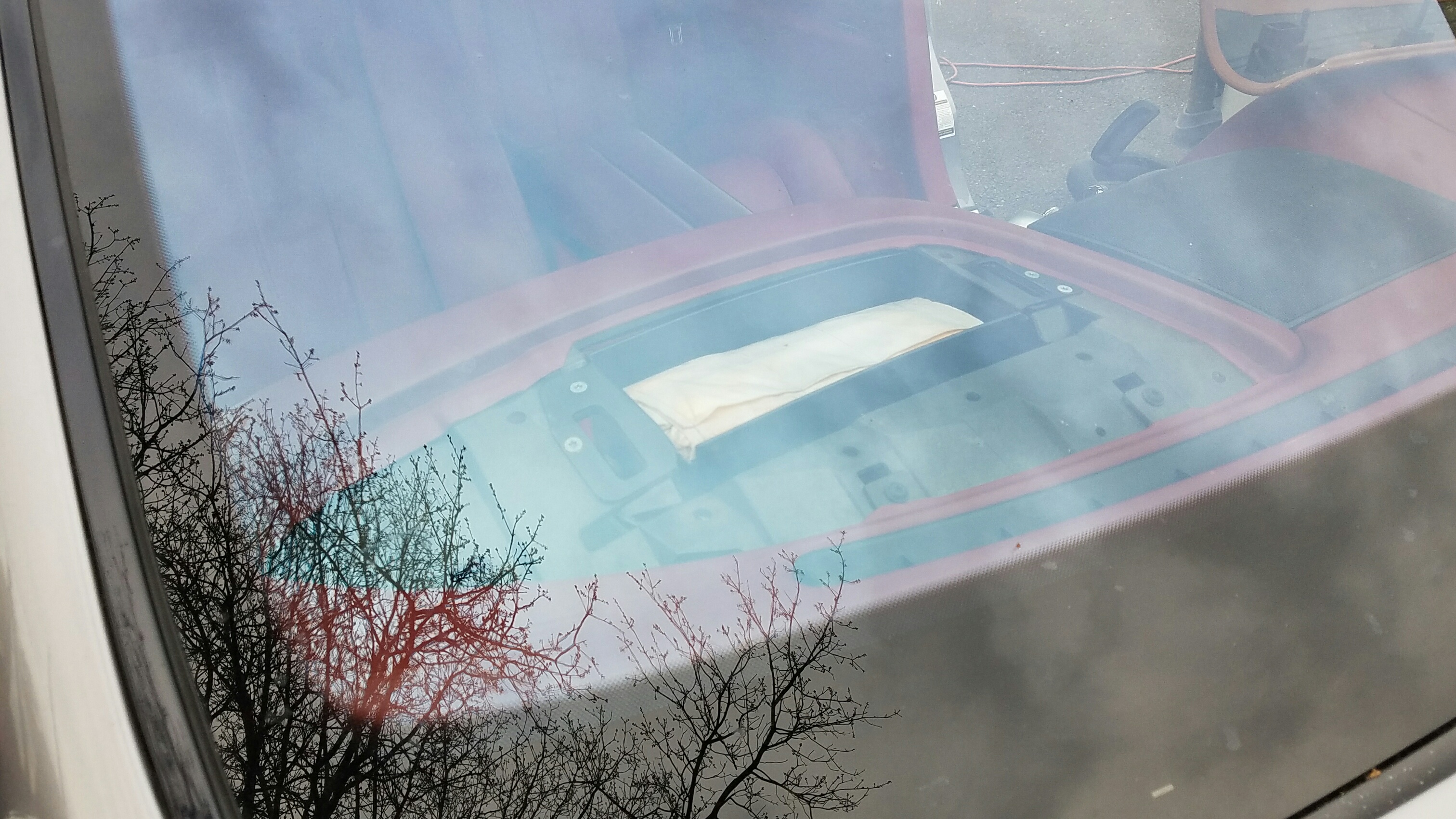

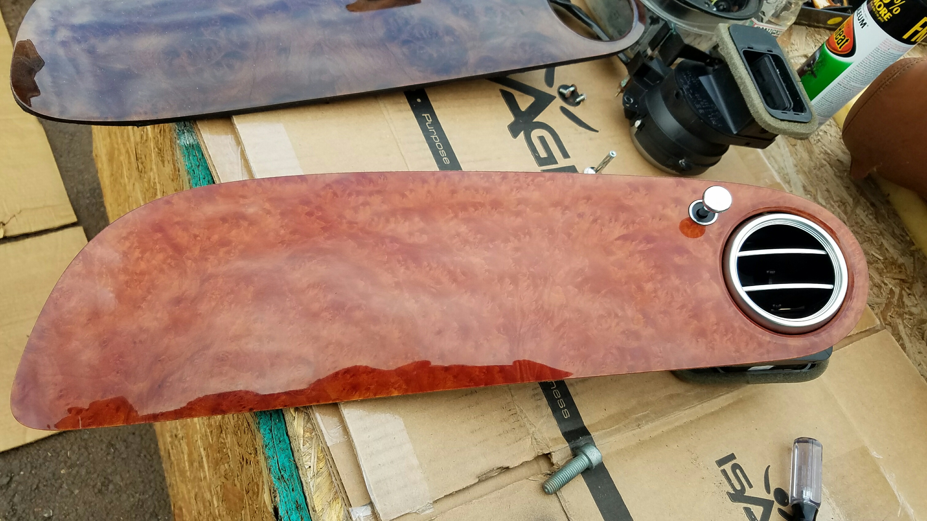

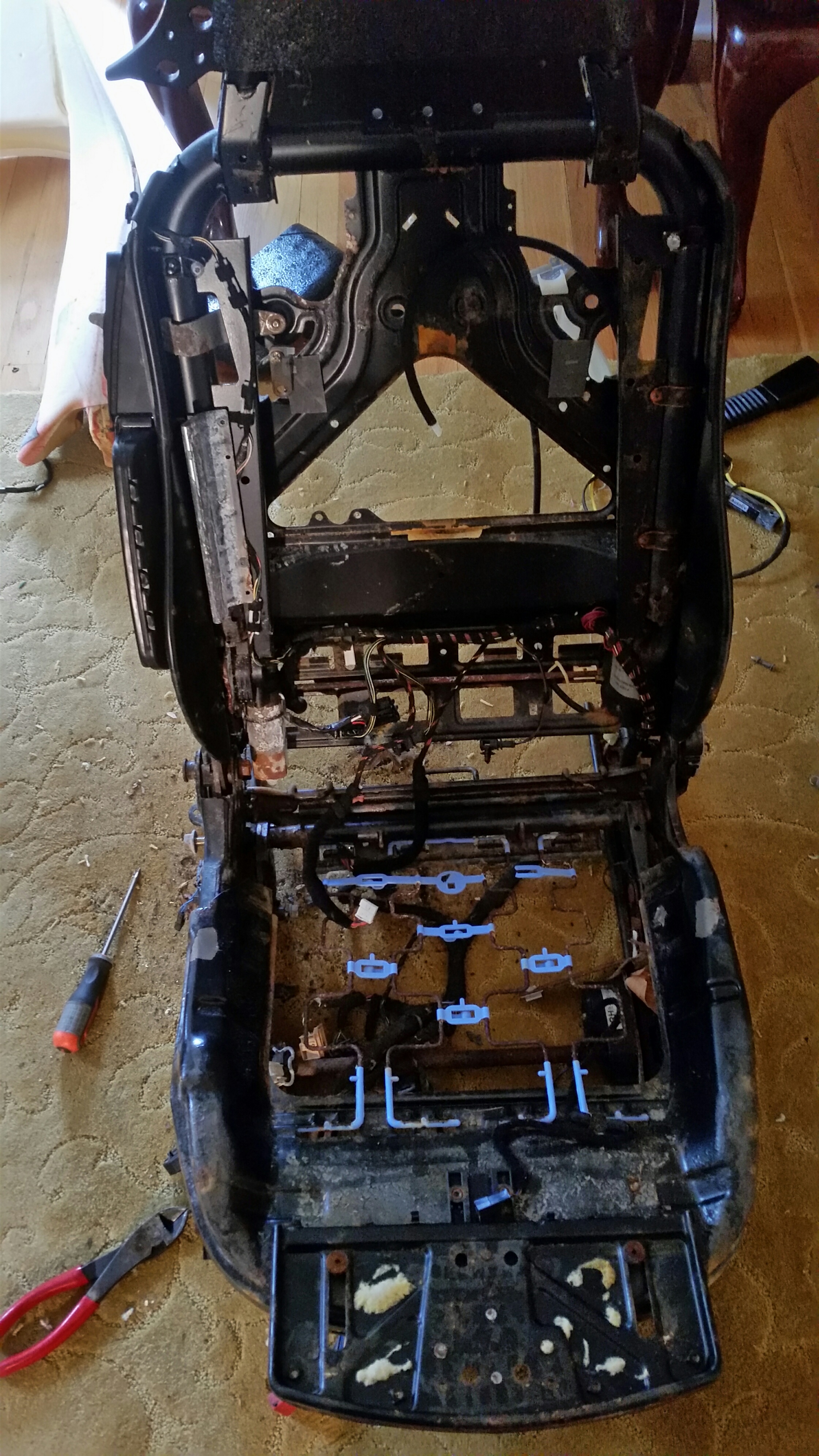

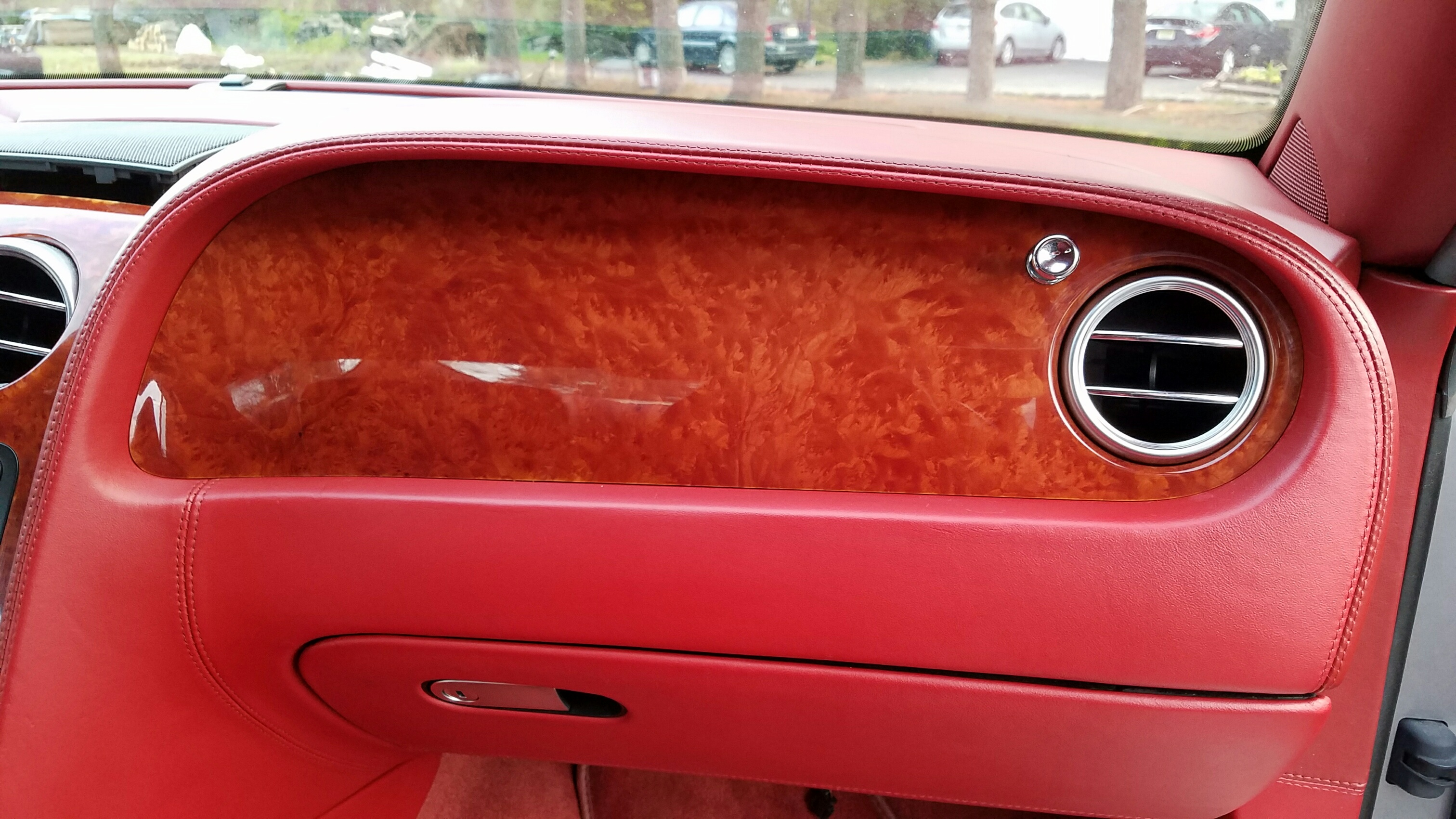

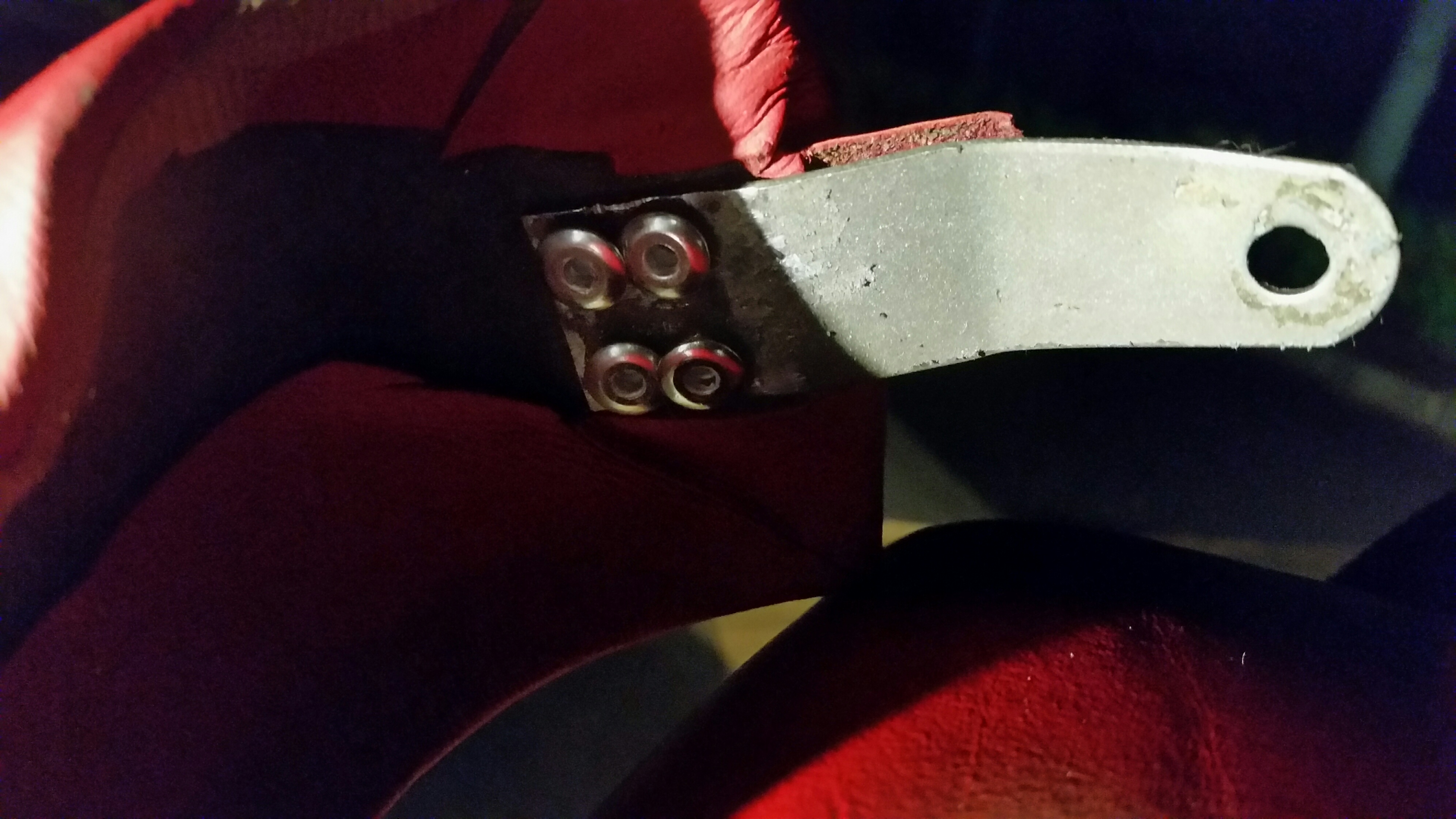

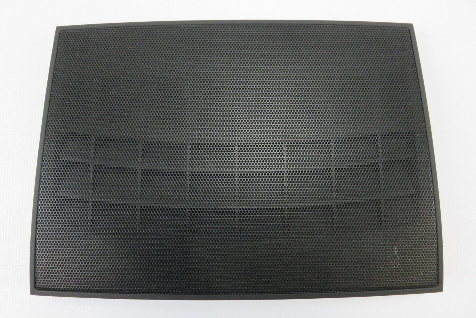

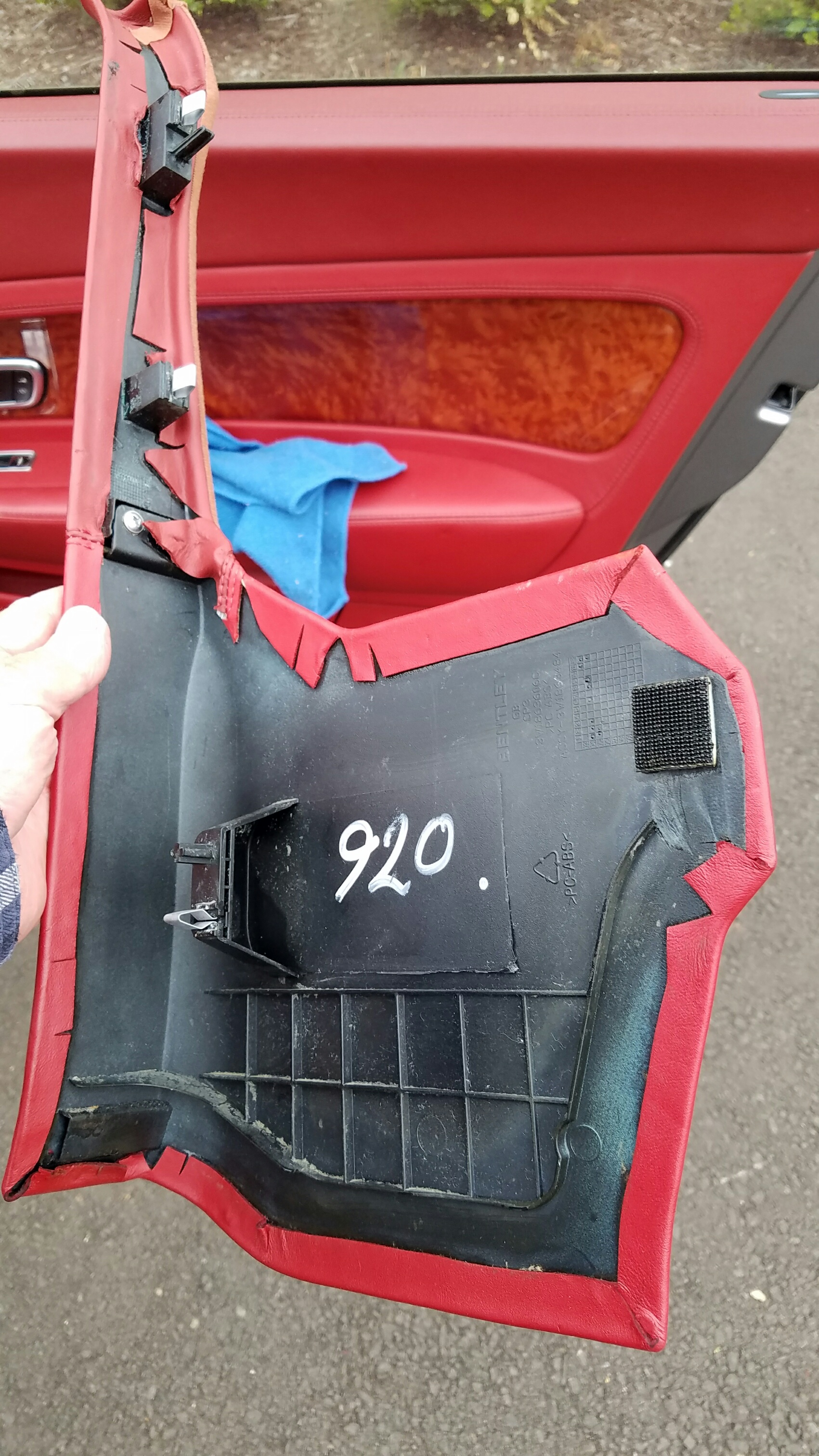

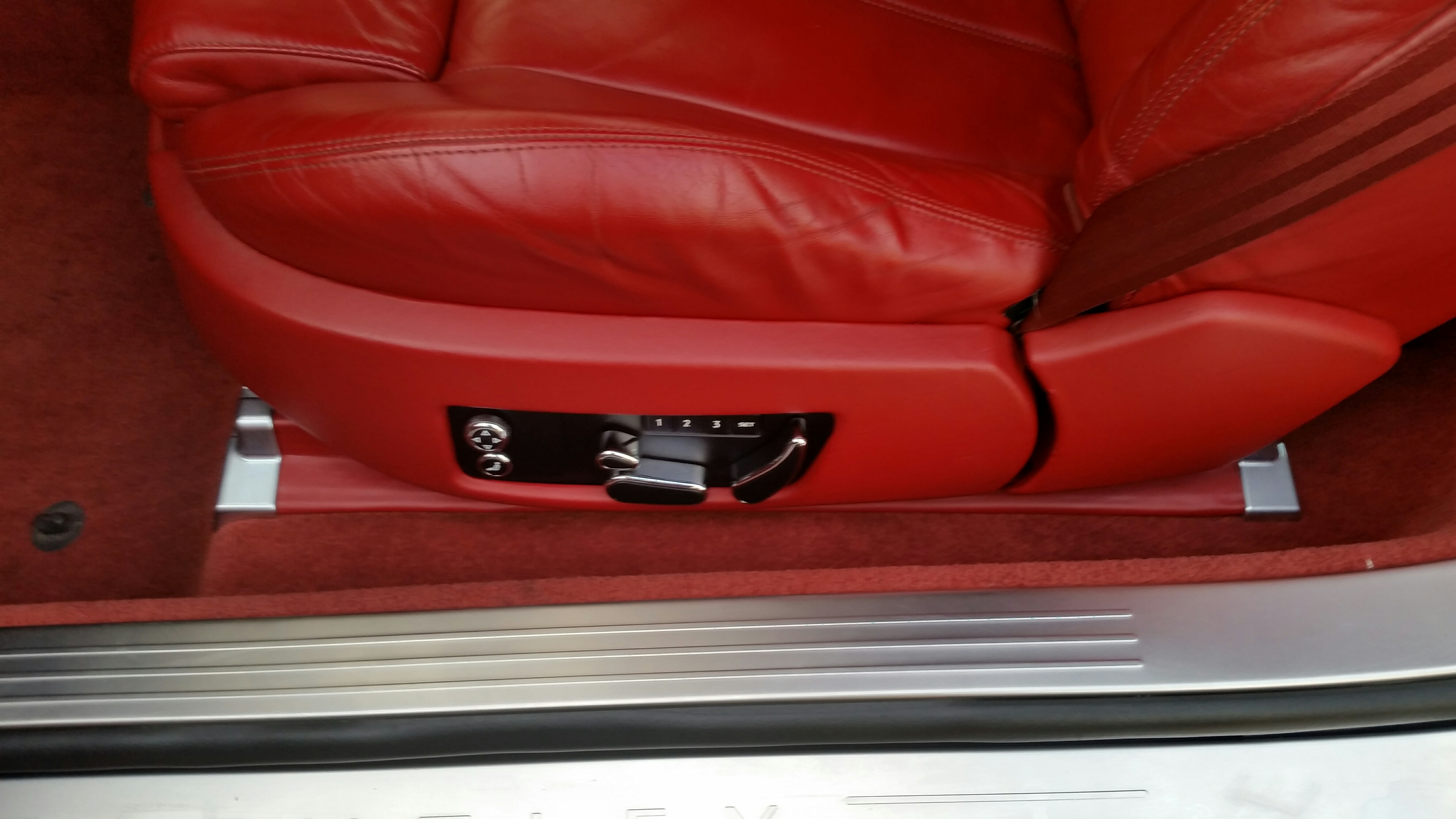

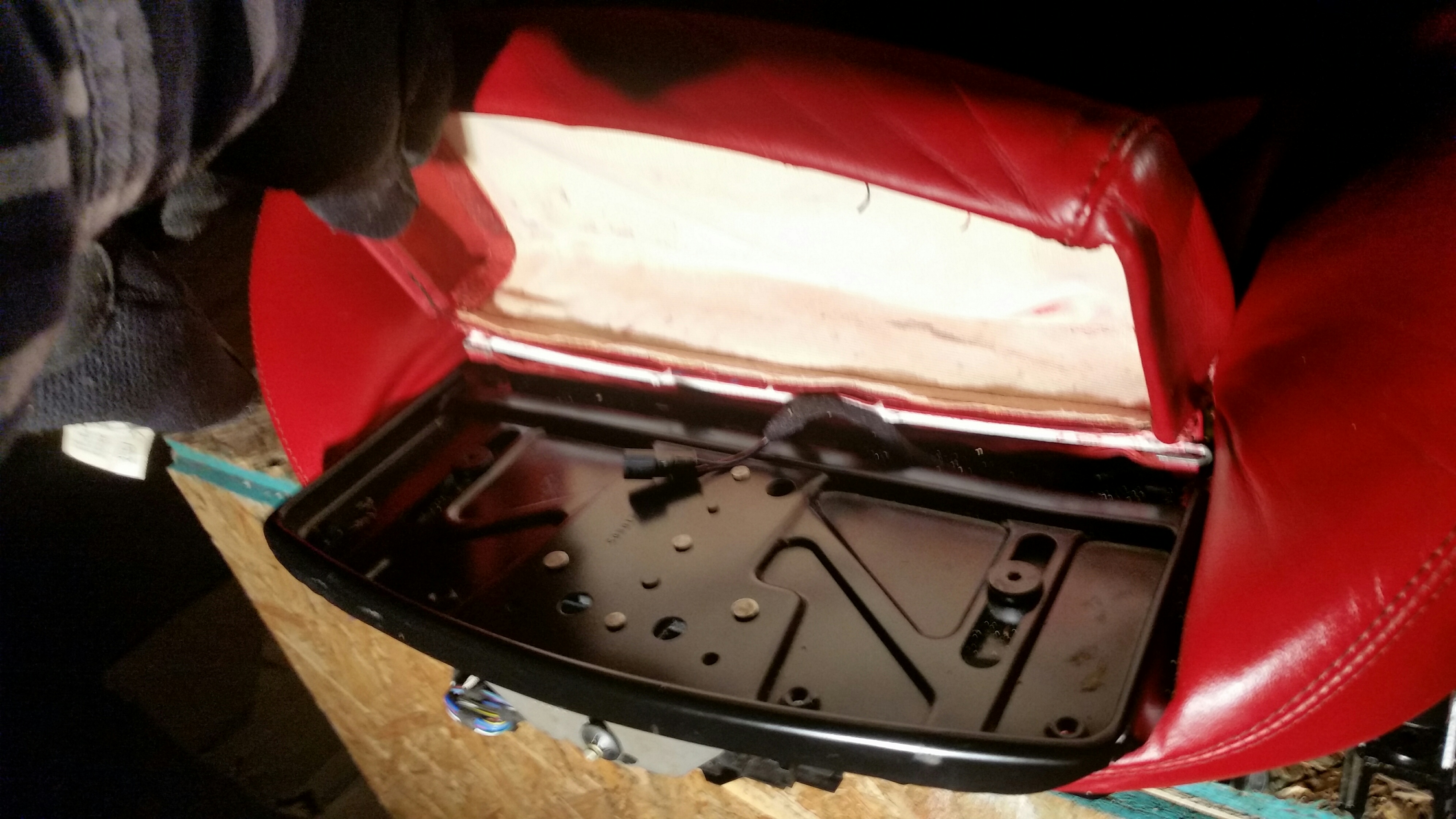

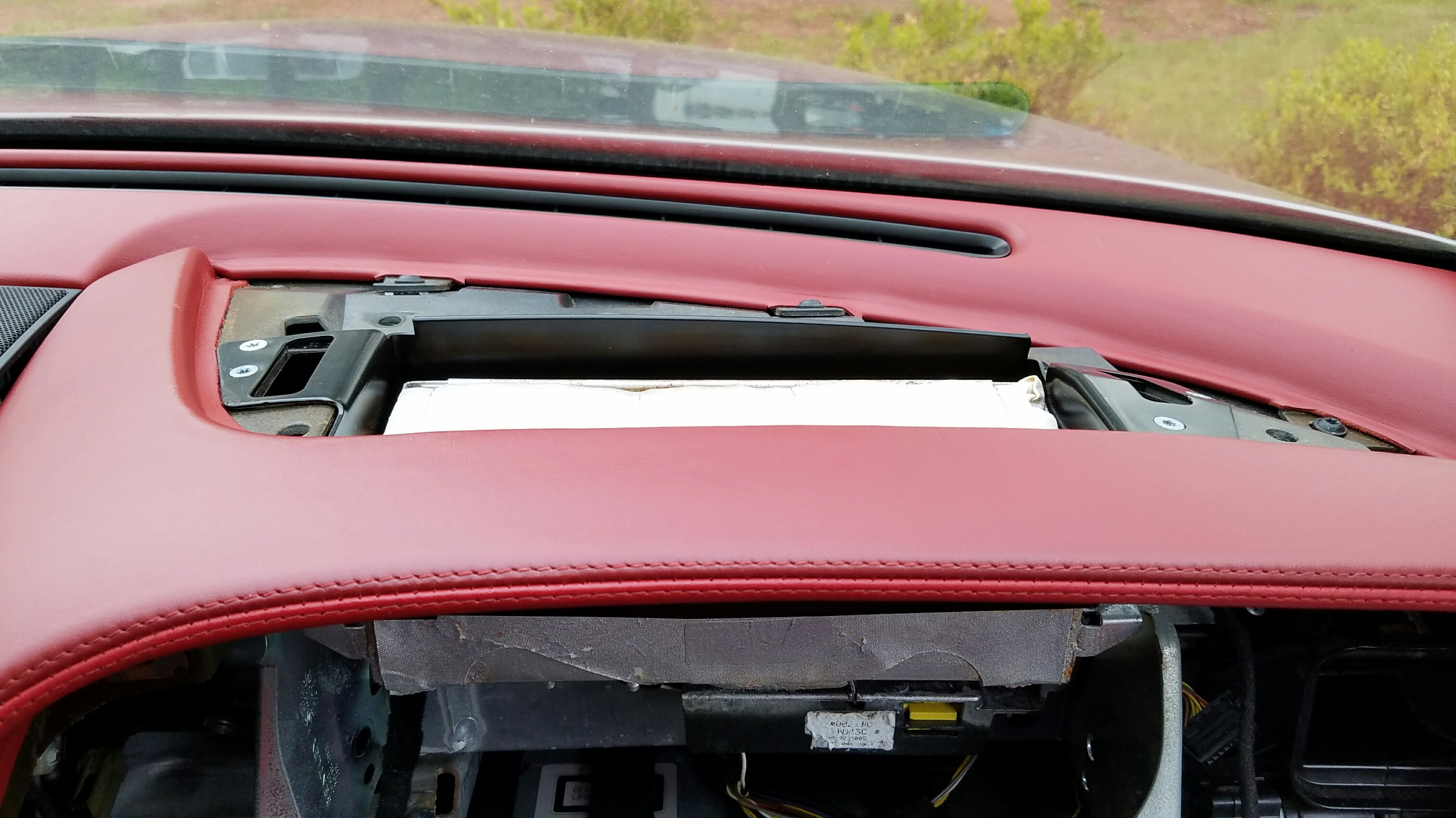

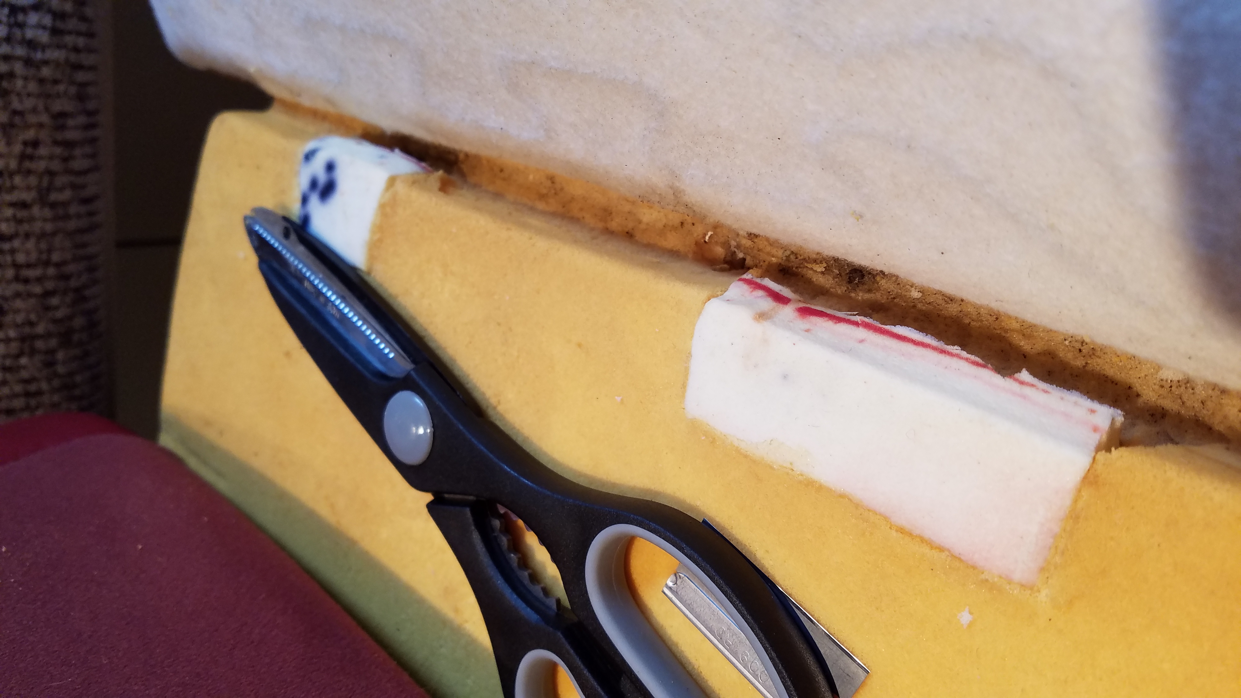

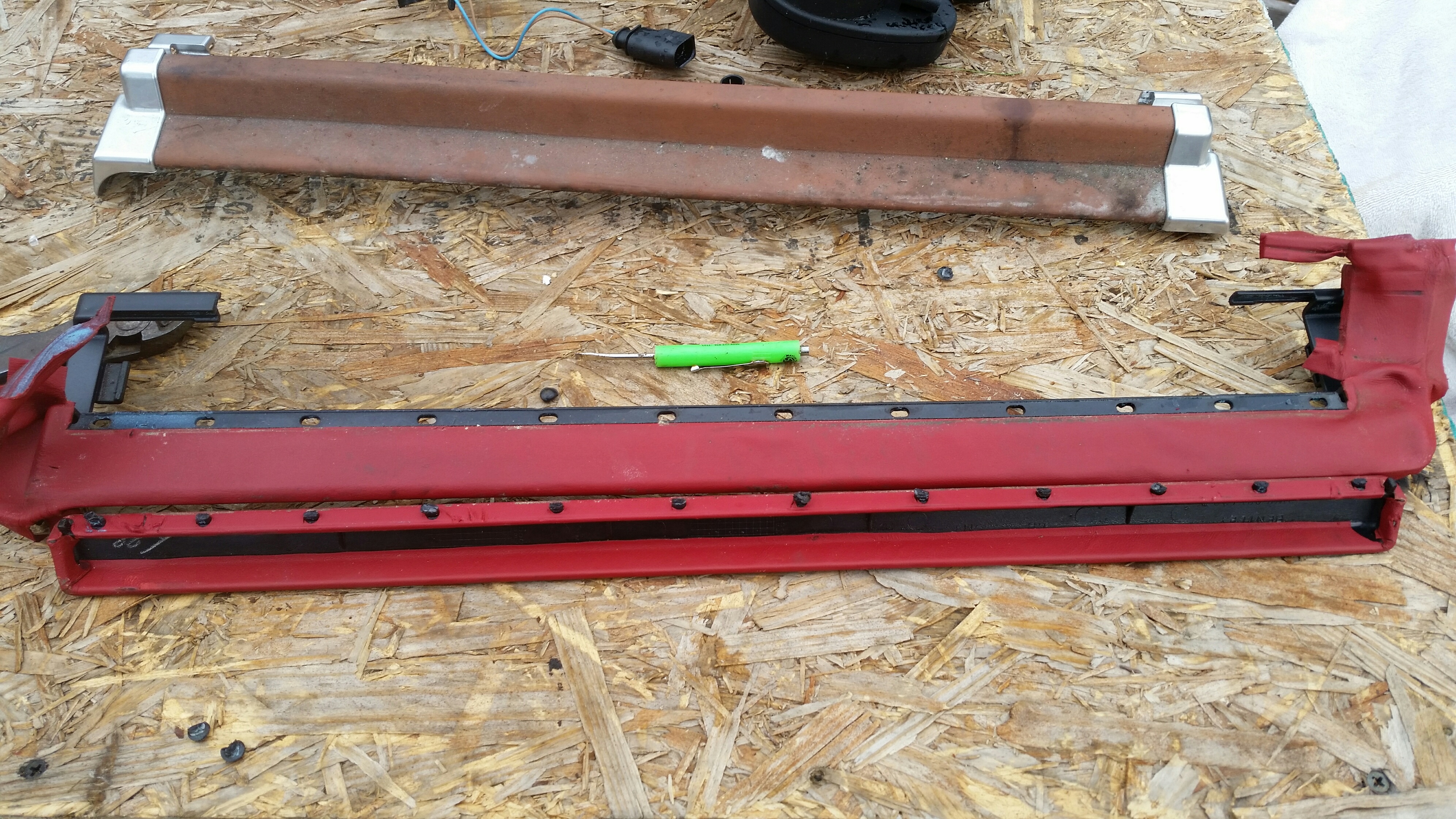

Update !
Spent some more time on this beauty !

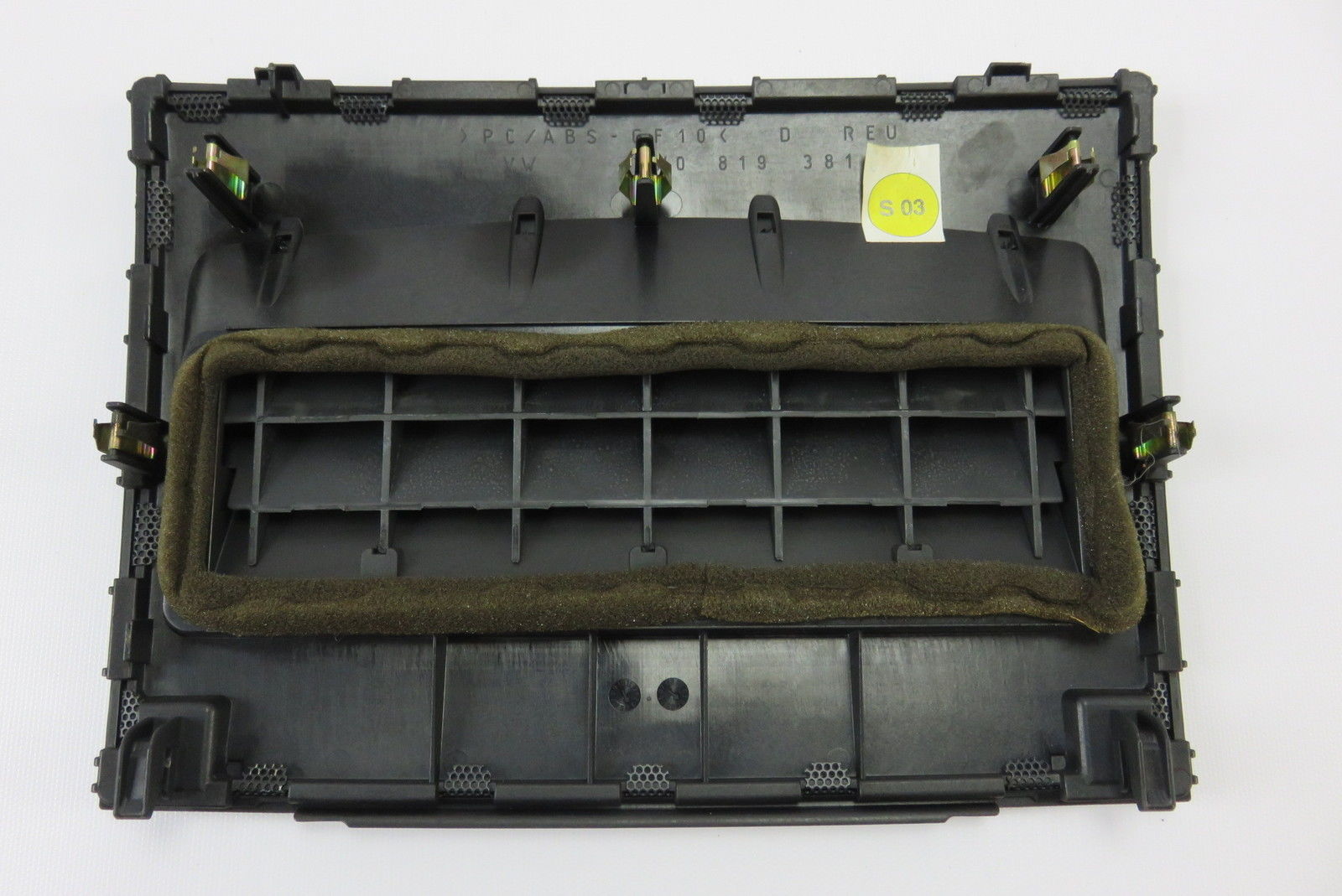

I did some drivers seat foam surgery, changed out the tan seatbelt for the red belt, there is a cam lobe on the seatbelt roller, the vise grips hold the roller from spinning and losing all tension, OH the joy it was doing the seatbelt, I stabbed myself in the finger with a flathead, at least a Phillips would have pierced the skin a little nicer, that's why you will see me wearing gloves after some gauze and electrical tape repair to my finger, I can not wait to do the passenger side........
I transferred the leather from the old to the replacement seat rail trim, 2005 is different from 2007, the latter having a chrome finish plastic trim added, along with different profile.
Also some have called what looks like a speaker grill just that, "speaker cover", although there is no speaker there, it is the upper center vent for the HVAC.
Now back to some yard work....
Enjoy the Pictures.
ID:	448830   Click image for larger version
ID:	448831   Click image for larger version
ID:	448833   Click image for larger version
ID:	448834   Click image for larger version
ID:	448835   Click image for larger version
ID:	448836   Click image for larger version
ID:	448838   Click image for larger version
ID:	448839   Click image for larger version
ID:	448840   Click image for larger version
ID:	448841   Click image for larger version
ID:	448843   Click image for larger version
ID:	448844   Click image for larger version
ID:	448845   Click image for larger version
ID:	448846   Click image for larger version
ID:	448848   Click image for larger version
ID:	448849   Click image for larger version
ID:	448850   Click image for larger version
ID:	448851   Click image for larger version
ID:	448853   Click image for larger version
ID:	448854   Click image for larger version
