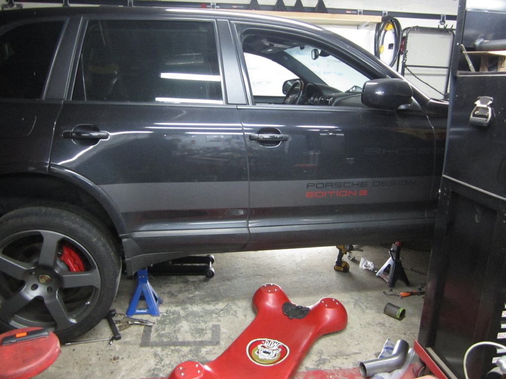

Pepper is up in the air and prepped for surgery...

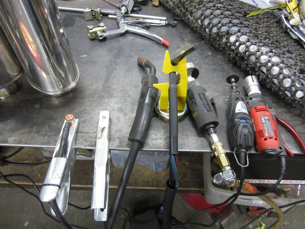

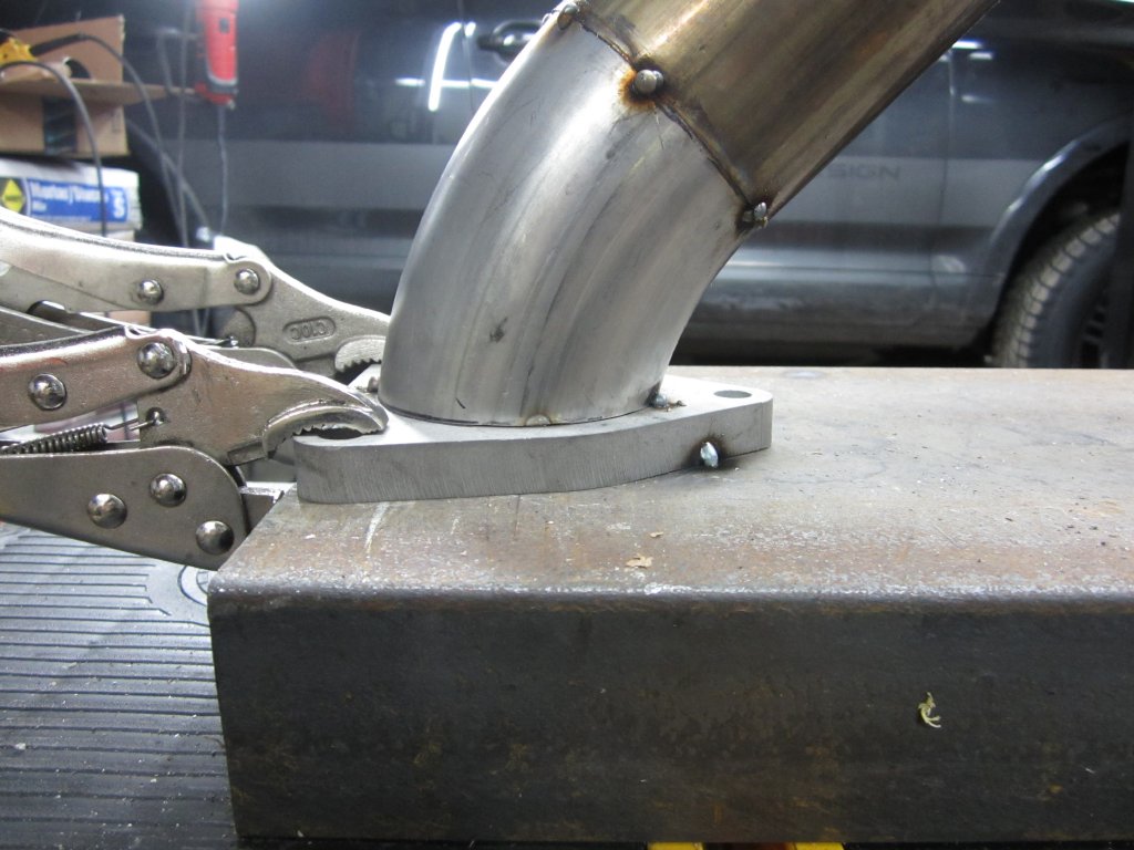

This is a pic once I was 60% complete. A good lineup of tools for the job, including both my MIG welder (tacking) and TIG welder (finish welds).

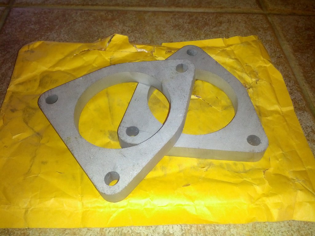

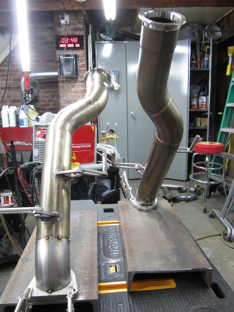

The puny 1/4" secondary flanges will be cut off and replaced with beefy 1/2 304 flanges
Tacked up and clamped down
Look, twins! V-Band flanges used throughout

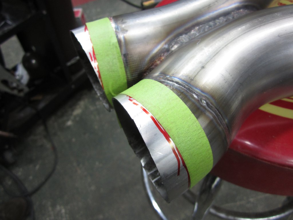

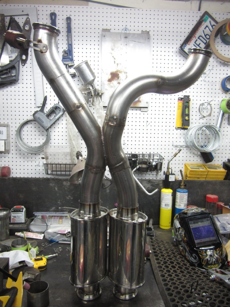

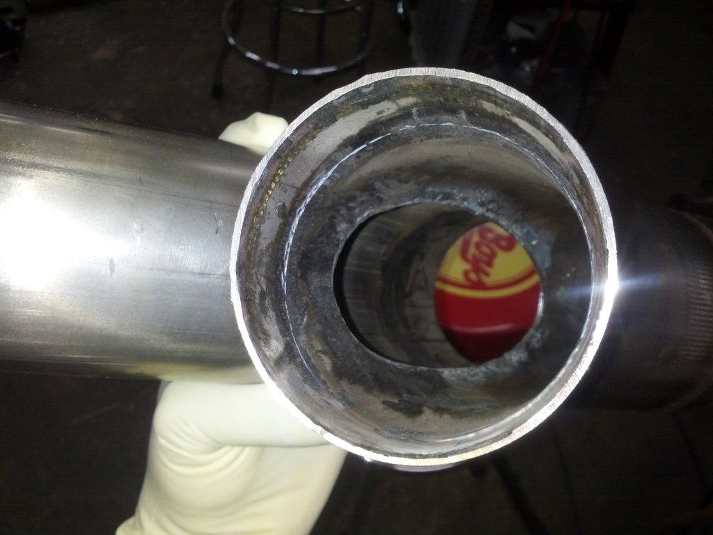

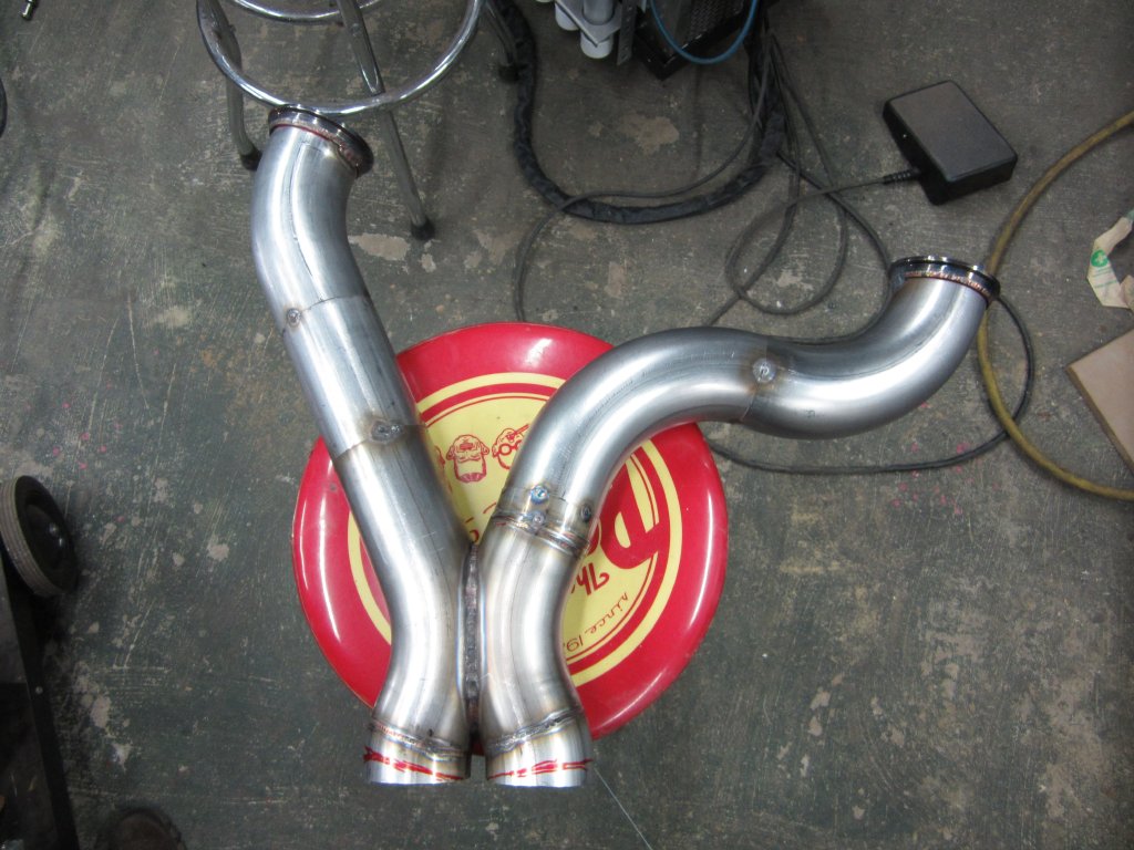

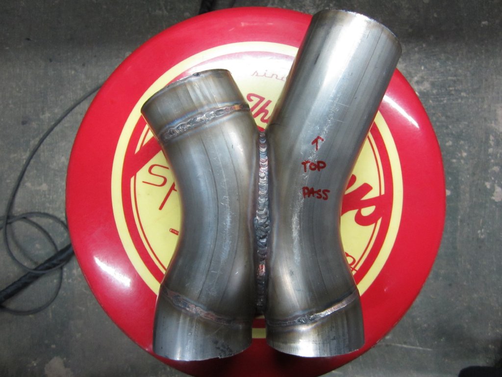

Custom 3" X-Pipe
Inside of X-Pipe
Build out onto the X-Pipe to the secondary v-band flanges
Trimming and angling the end of the X-Pipe towards the resonators

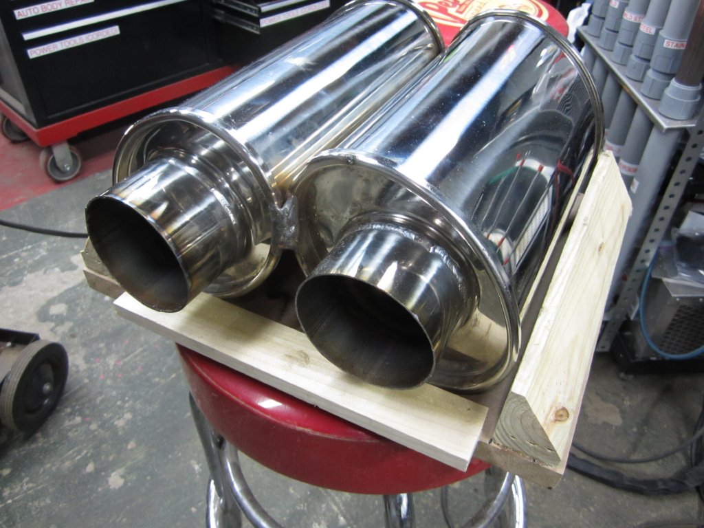

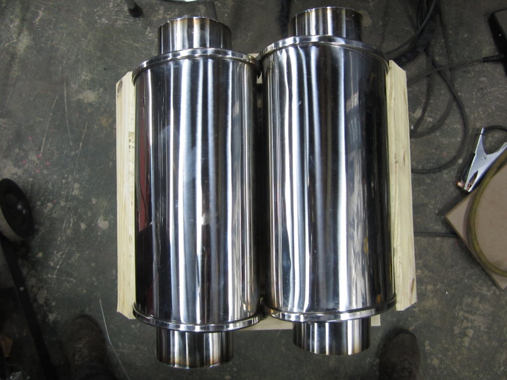

Large Resonators (aka. premufflers) on a placement jig

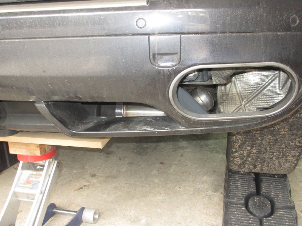

Brief clearance check under the passenger door
Placing large resonators

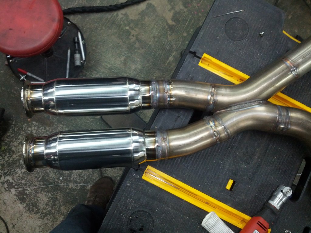

X-Pipe section complete with resonators

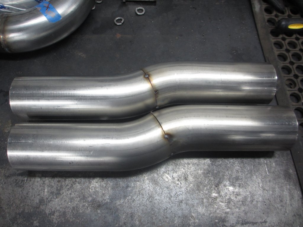

Basic bend forming

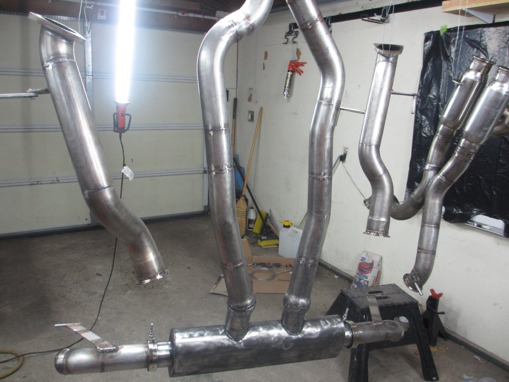

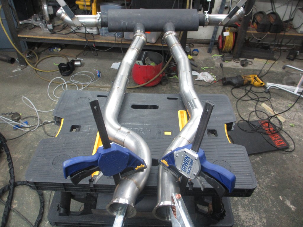

One of two pipes leading from resonators to rear muffler
Both pipes from resonators to rear muffler clamped down and about to be finish welded

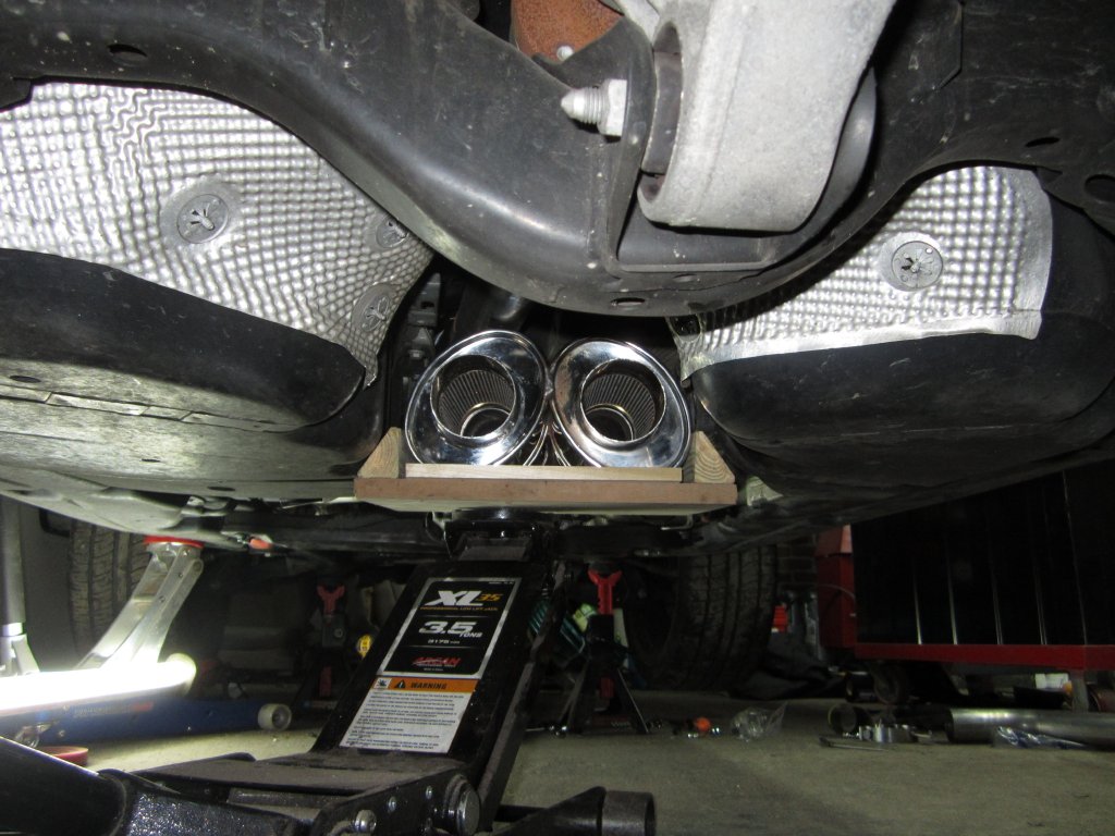

Muffler height placement

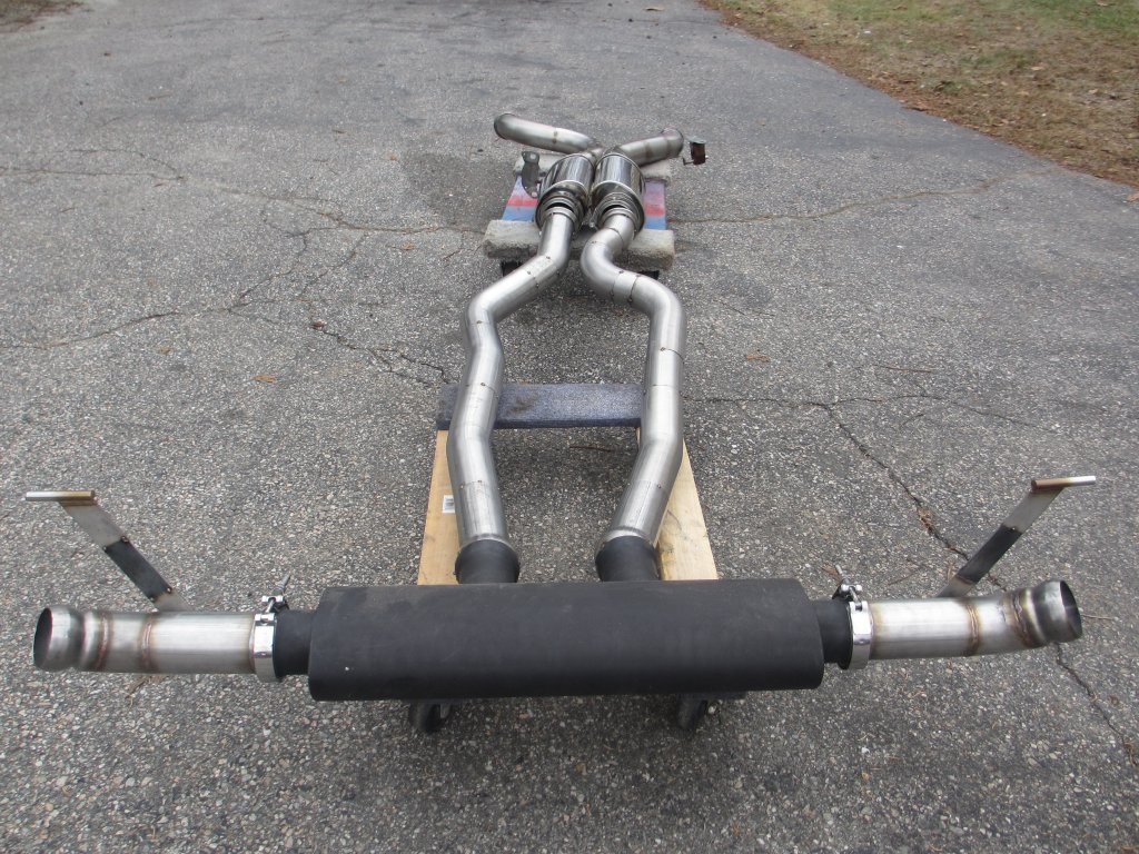

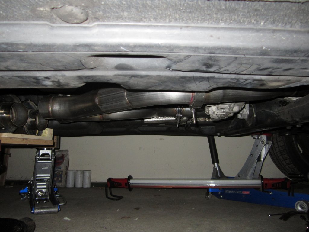

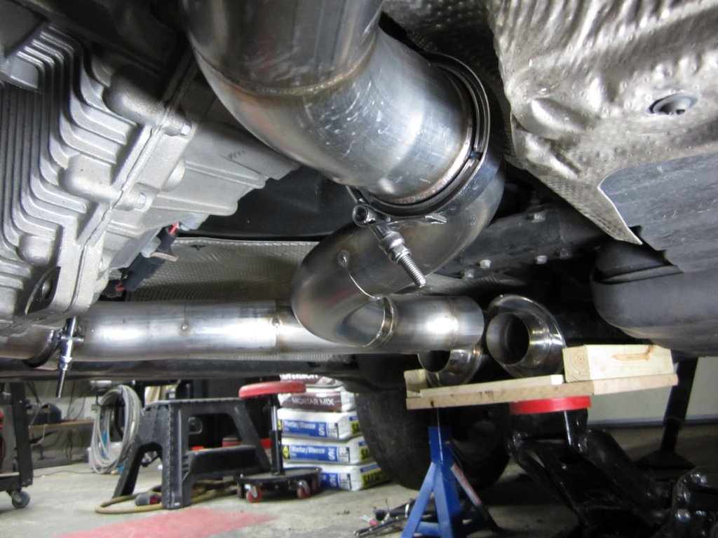

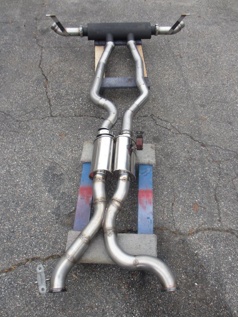

Version 1 -Complete system overhead pic (tacked only)
Version 2 - Had to remove large resonators (too quiet) and install smaller bullet resonators. Everything else is the same.

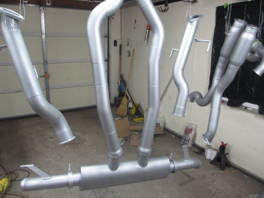

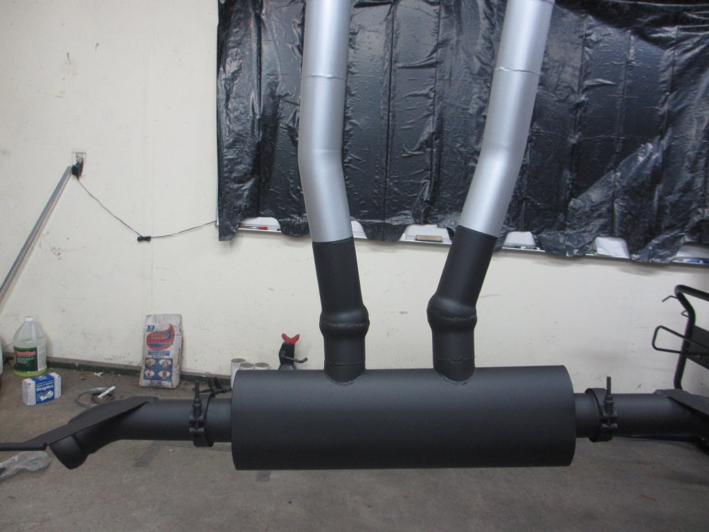

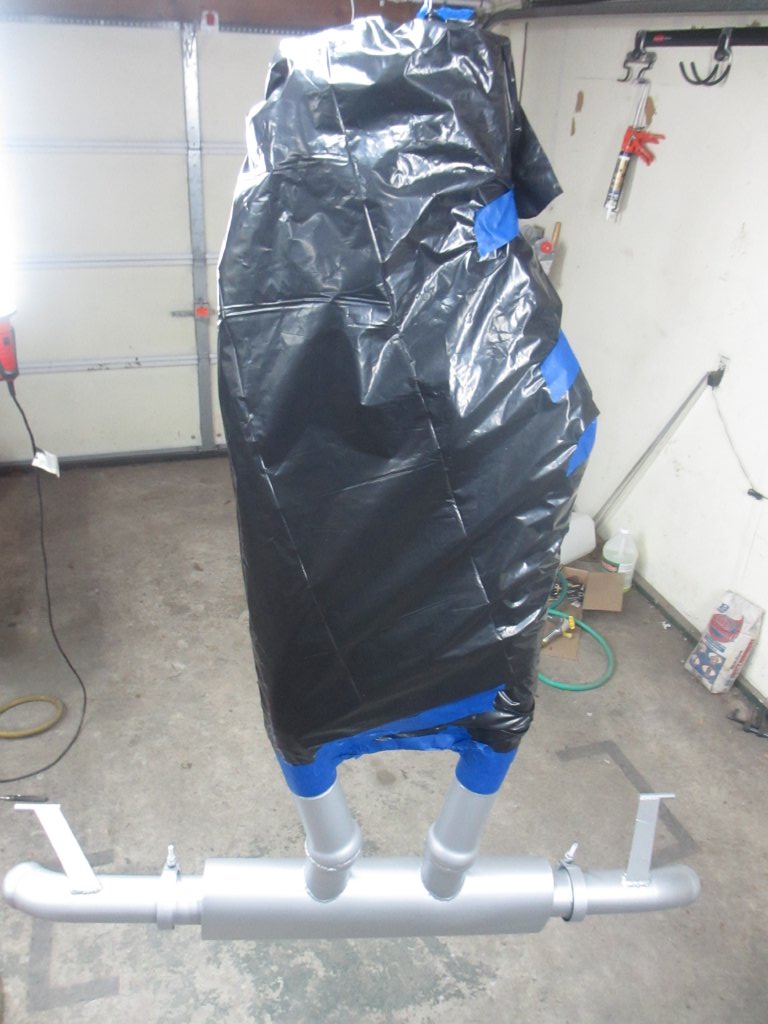

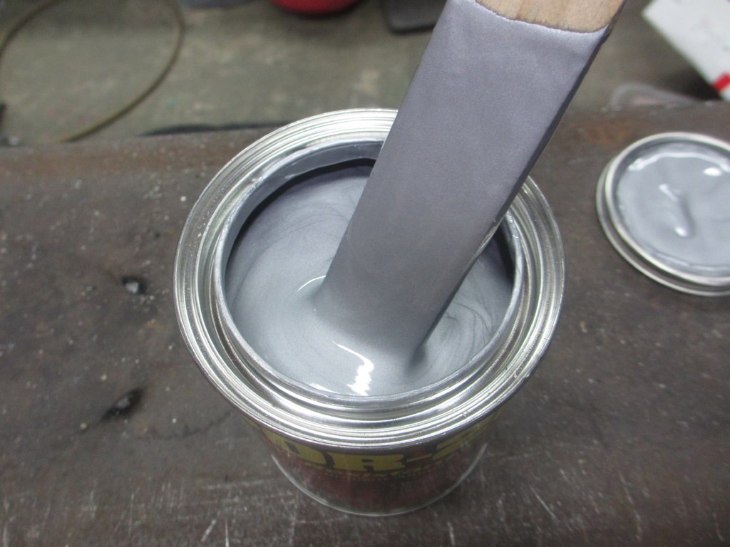

Even though everything is 304 Stainless Steel, I decided to give it extra corrosion resistance since the NE winters are brutal.
Decided on a two-tone paint. Flat black from the rear and the higher temp resistant silver paint for the rest.

It may or may not have been clear, but there were two final versions of this exhaust. The first version was made with the large resonators in line before the muffler, but ended up being too quiet for my tastes. I know, I must be crazy to say that an open 3" exhaust was too quiet. The best way to describe it is that I had inadvertently filed down it's fangs... think less wild wolf, more Golden Retriever
Here judge for yourself:
Video: Exhaust Sound Clip - Version 1 - 4K RPMS
For the second version, I removed the large resonators and installed small bullet resonators in its place, so it would let out a little more gurgle. But still keep the 3" system under control
Video: Exhaust Sound Clip - Version 2 -4K RPMS
Now that is much MUCH better!

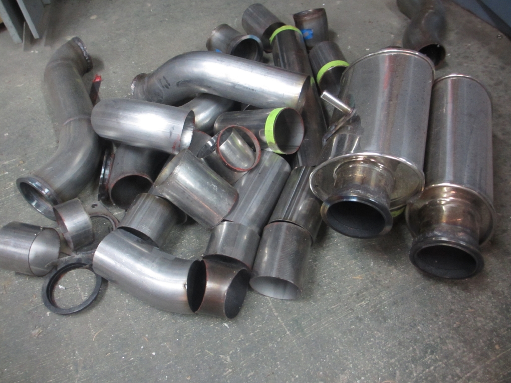

For context, I thought it would be fun to put up a picture of all the spare bends and cuts that I made. This is about 80% of the leftover cuts...
