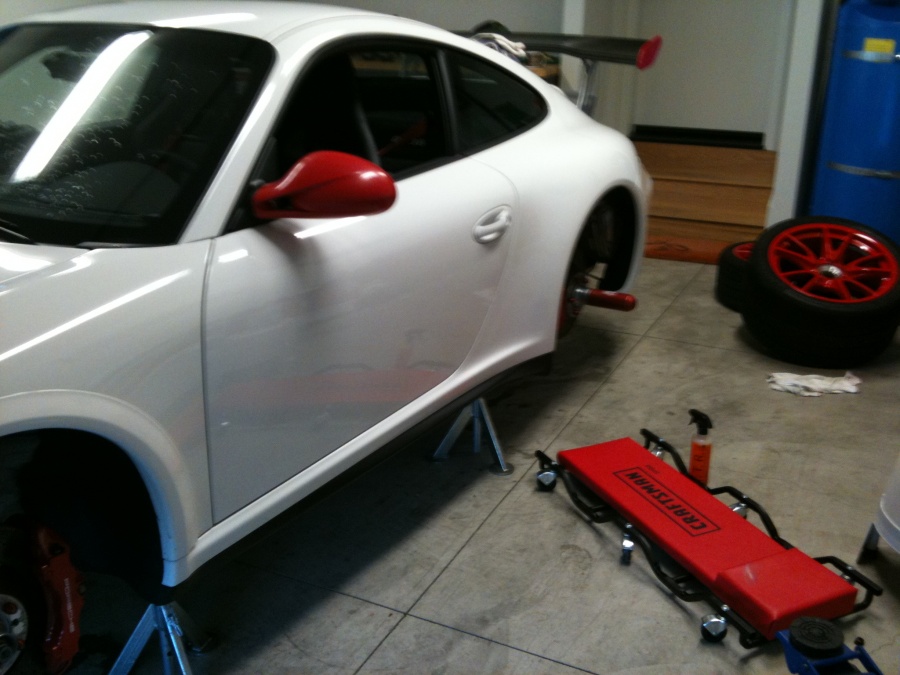

savyboy is right. you need all the ***** tool which is from 3R racing, google the shop. $350 or so.
if you dont have this tool or equivalent, you simple cannot track the car
http://www.tooltopia.com/precision-i...s-c4d600f.aspx
and you wont see many 2010 RS on track, so you wont be able to borrow it.

i hate this site. why is it my pix are always tiny? why can't they make this simple...
anyways, look at the rear wheel you will see the giant ***** tool.
