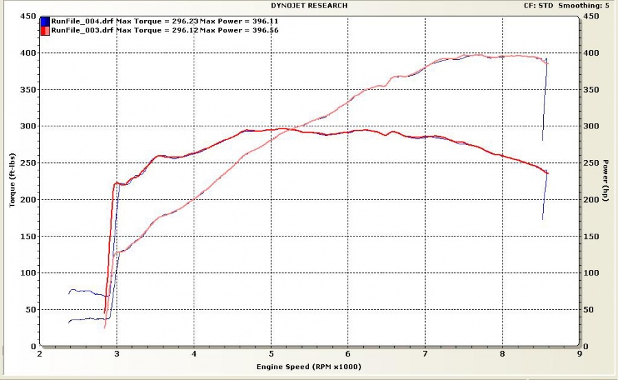

And so it begins. We've decided to officially throw our hat in the ring and join the GT3 madness. With the recent introduction of our complete line of CMS suspension components (CMS Suspension Upgrades), our race history, and our recent success with several full 997 Turbo engine builds, we decided it was time to bring some heat to the GT3 game.
The car below should look familiar to most people on 6Speed (as if the code name didn't give it away lol ). The upgrades planned will touch on every aspect of the car....including suspension, interior, engine, and *maybe body. There will be several new parts that we're working on specifically for this car, so we're anticipating about 90 days for completion, but I'll keep you all posted and updated with photos and info as often as possible. For now, enjoy a few "before" pics, along with a few pics on the dyno getting our baseline numbers.

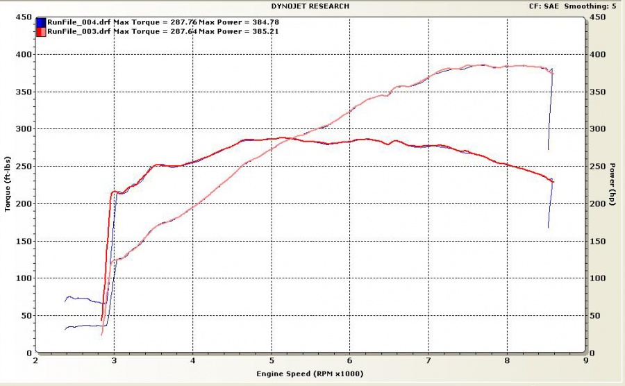

And here's the baseline numbers. I'm not sure how these compare to other GT3RS's out there, but this particular car does already have quite a host of upgrades. The dyno in this case is really just to give us a delta, or a number to compare with so that we can measure the improvement once the project is complete. Out of several runs, results were REALLY consistent, about 396hp at the wheels. Two dyno sheets are attached, one measured in STD, and once measured in SAE. Not much of a difference...some people are used to seeing one or the other.
