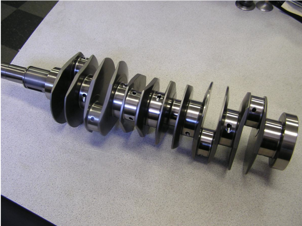

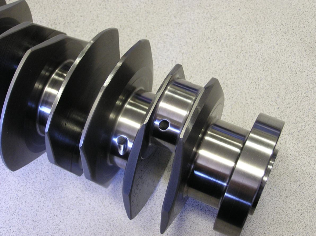

Here are some pics of the crank:

Very nice, do you have spec's?

I have all but the pistons' specs. Talking with both CP and JE trying to figure out the best setup; light weight but strong at a bore size where there are great ring packages available. I will wait till everything is in before I post the specs. Waiting on the Ductile Iron Sleeves, Cylinder Liners to complete the whole package.
What I can say is that the rod journals will be smaller, as well as the wrist pin diameter; both to save weight.
The crank in the pics has a 80.4mm stroke. We might end up with a hair more stroke to get a true 4000+cc engine.
I am also looking into CNC porting options for the heads and possibly going with bigger valves to improve flow. I have found people who can hand port but I prefer CNC porting to ensure even ports. Thanks to bigger bore size, we can go with bigger valves, lash around the valves nicely and do a nice bowl work in the combustion chamber to improve flow even further. Even if you don't do the CNC porting and do the rest it would still help a ton.
