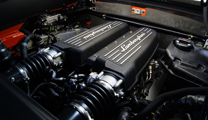

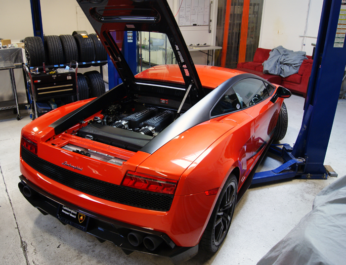

2013 Gallardo Superleggera LP570-4 Ediziione Technica
VF-Engineering is proud to present this Superleggera that was brought to us directly from Lamborghini Newport Beach with only 50 miles on the ODO. This is the 2nd Gallardo that the owner is having VF supercharge for him. In addition to the Ed. Technica, this is the only Argos Gallardo in the US.
Stock:
Baseline and Teardown up next...

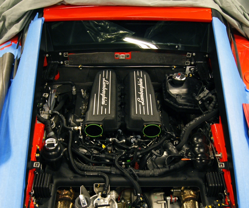

UPDATE: Out with the OEM.
Because the kit is 100% bolt-on, the motor does not need to removed to install the supercharger.
Twin Front-mounted radiators and Air-to-water cooling system up next...

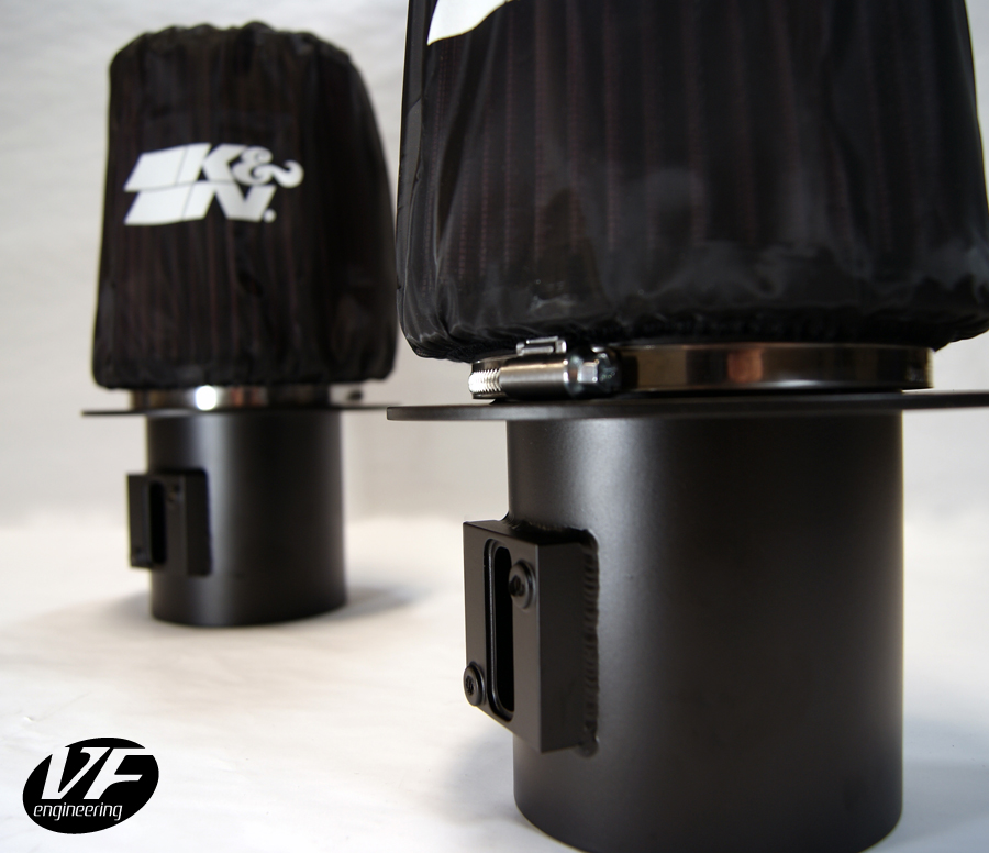

Custom MAF housings with K&N air filters assembled
Although very simple looking pieces, countless hours and resources went into creating our VF-Spec custom harmonic dampener and auxiliary alternator drive pulley. Putting together simple billet pulleys was not enough. Precision engineered and perfectly balanced, these pieces come together to provide factory-like drivability and feel at whatever RPM you are driving at.

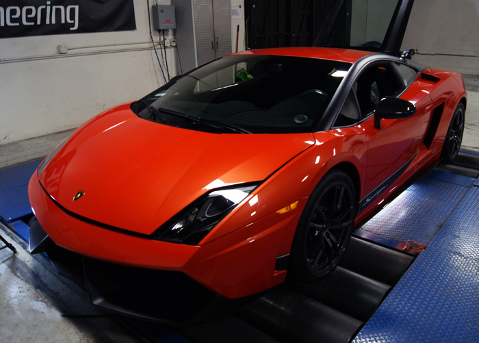

Teaser shot from our soon-to-be released video of this car.

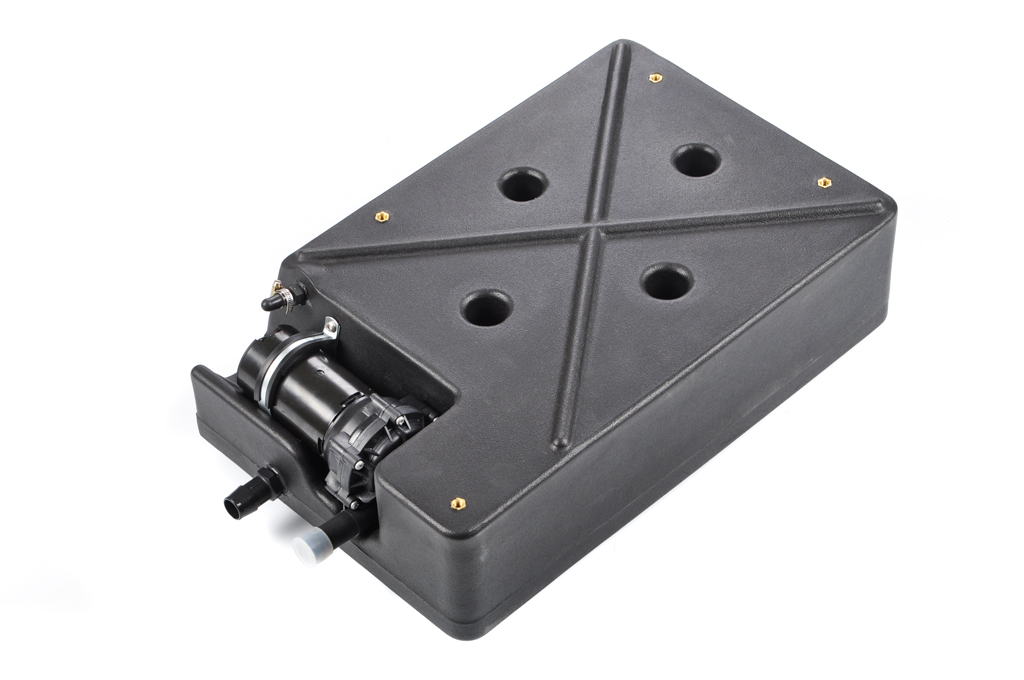

VF Engineering's Avatar
Joined: Apr 2012
Posts: 376
From: Anaheim, CA
VF Engineering is a jewel in the roughVF Engineering is a jewel in the roughVF Engineering is a jewel in the roughVF Engineering is a jewel in the rough
We use a very large water reservoir (~2.5 gallons) and a Bosch water pump to insure continuous water flow throughout the independent cooling system.
An owner of a Supercharged R8 V10 (99.9% identical drivetrain) who tracks his car says he's able to run his car longer than when it was stock.
http://www.r8talk.com/forums/6-perfo...tml#post219209
Another owner of a VF760 Superleggera drives his car very hard in the canyons here in Southern California. During the hot summer days, going uphill, he did experience increased temperatures just as any other normal car would. He's very much enjoyed putting his VF760 SL through its paces.
http://www.lamborghini-talk.com/vbfo...14-post80.html
