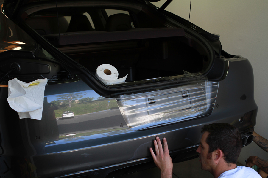

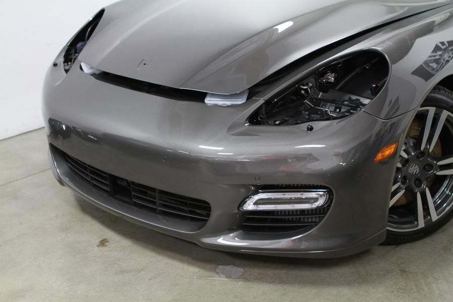

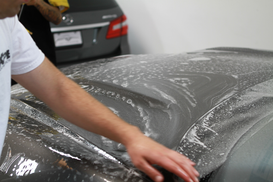

After the proper washing and paint decontaminating, we begin taking the various pieces of the vehicle apart to prepare for the clear film application. This process is quite laborious, but we demand a very high level of precision with our installation. Taking a few extra hours of properly taking certain things apart and removing imperfections in the paint, makes the final result near flawless

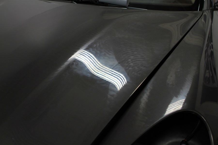

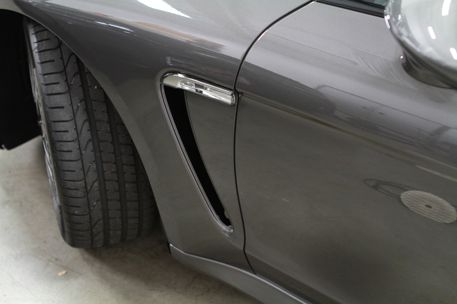

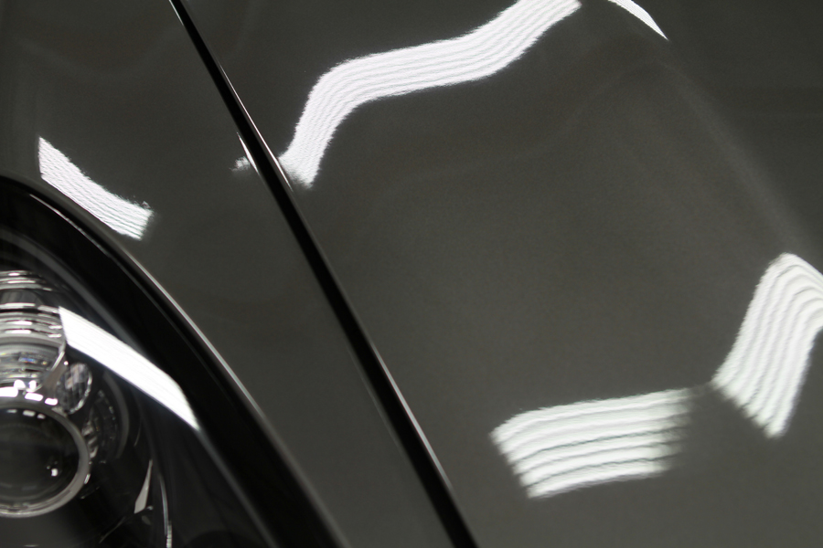

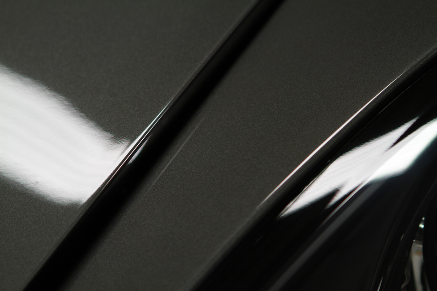

Paint surfaces are polished to remove any imperfections prior to film installation

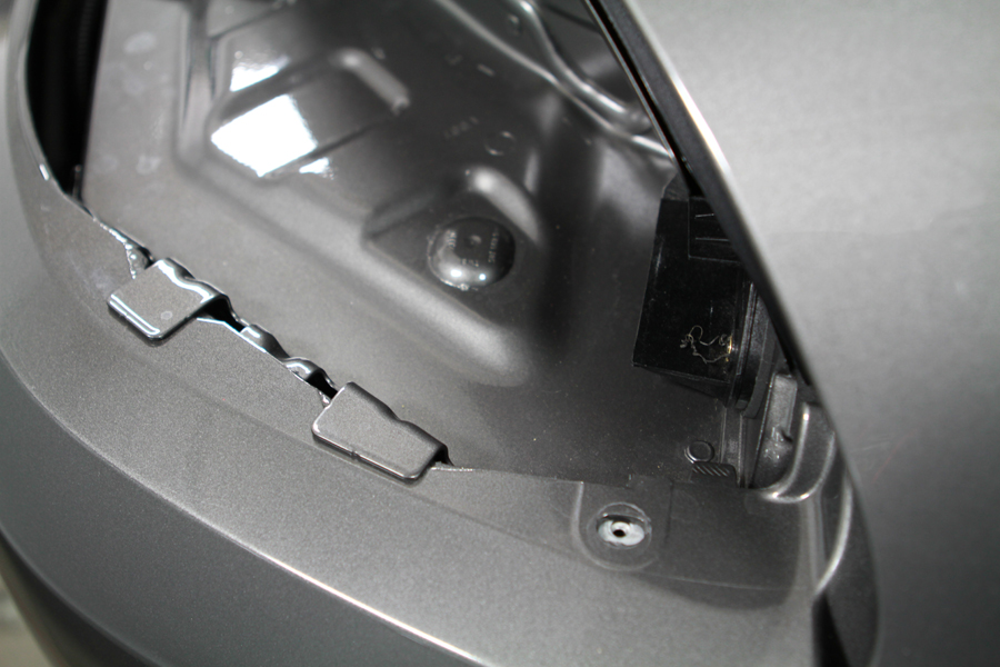

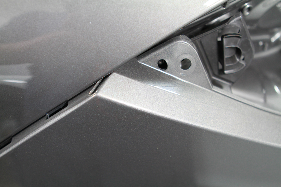

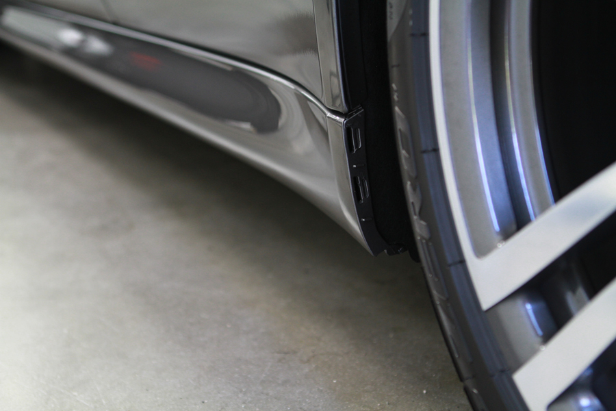

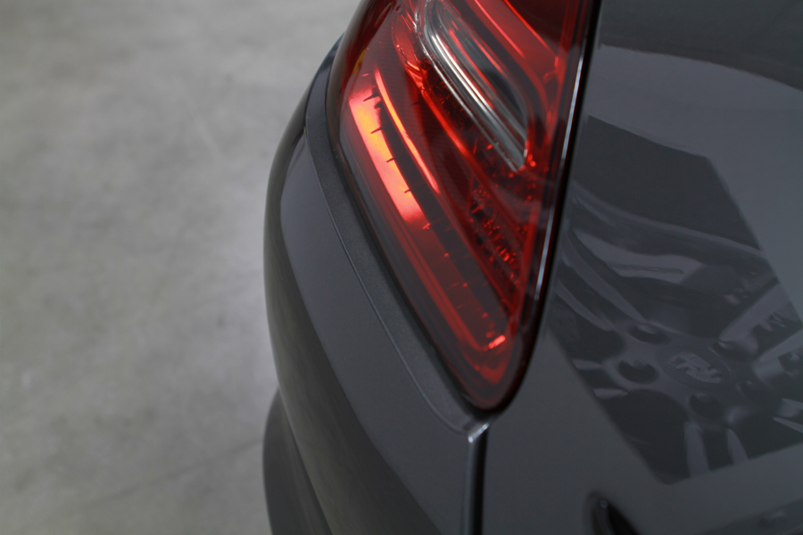

Rear bumper edge opened to wrap film inside edge. This allows for a seamless installation and no visible edge to film

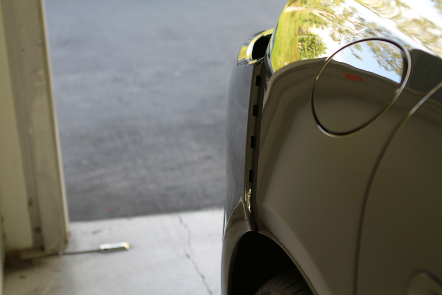

Mud guards removed to wrap edges of film

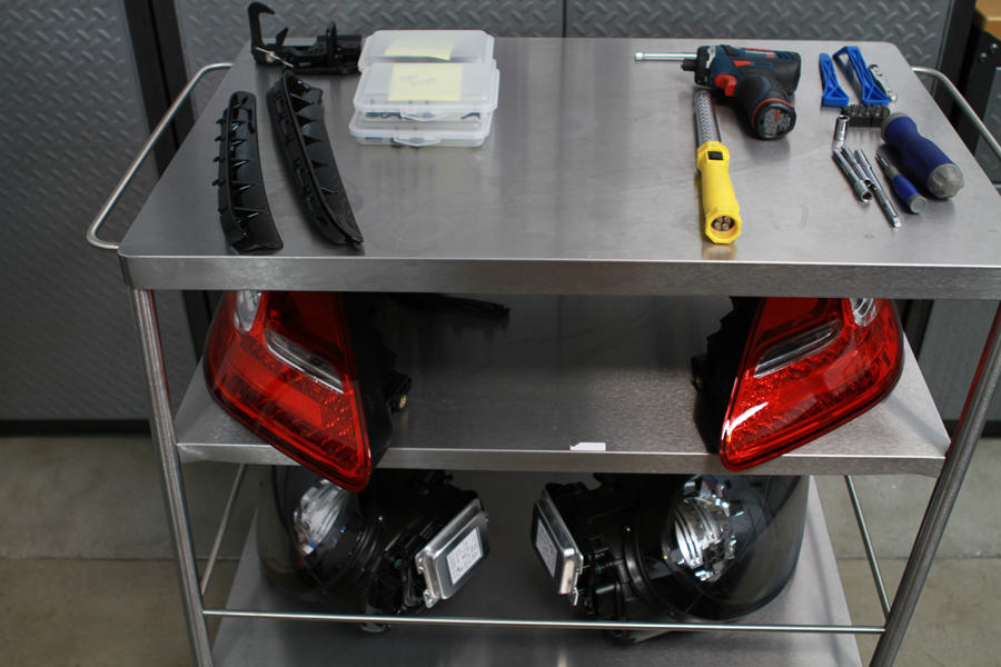

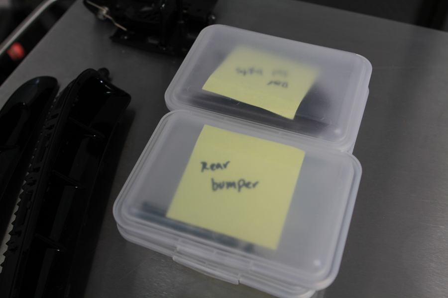

All screws and bolts properly cataloged and stored

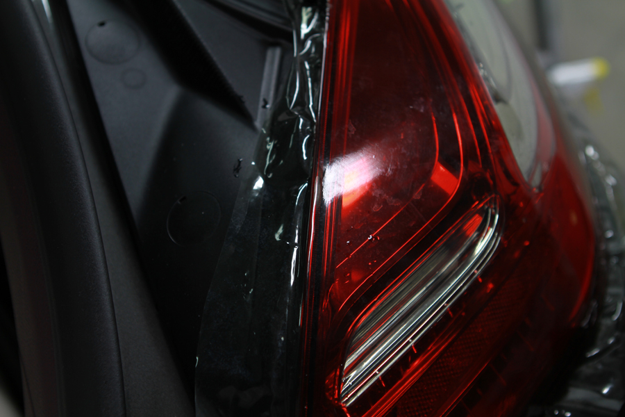

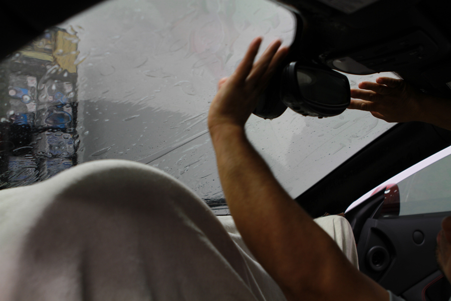

Window Tint - Huper Optik/Smoke Taillights

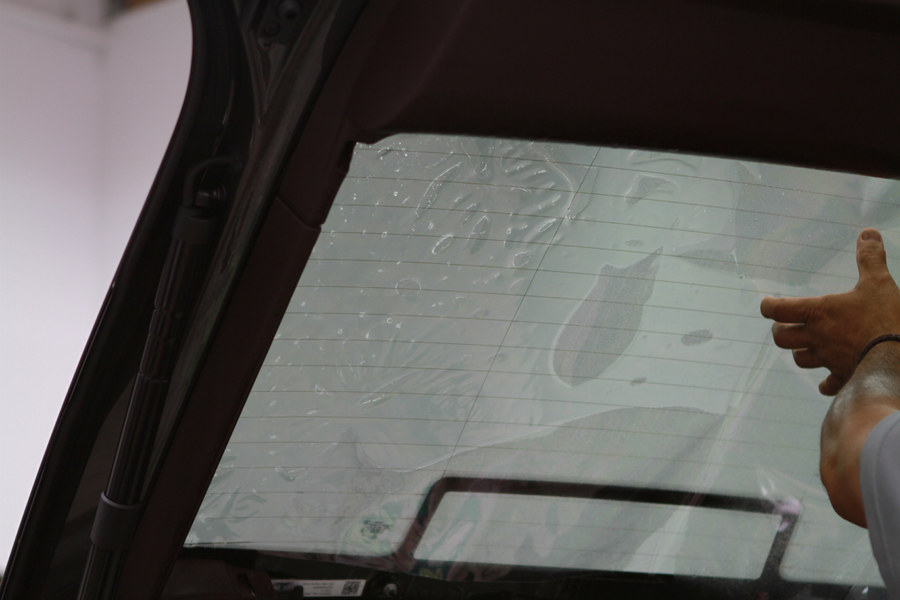

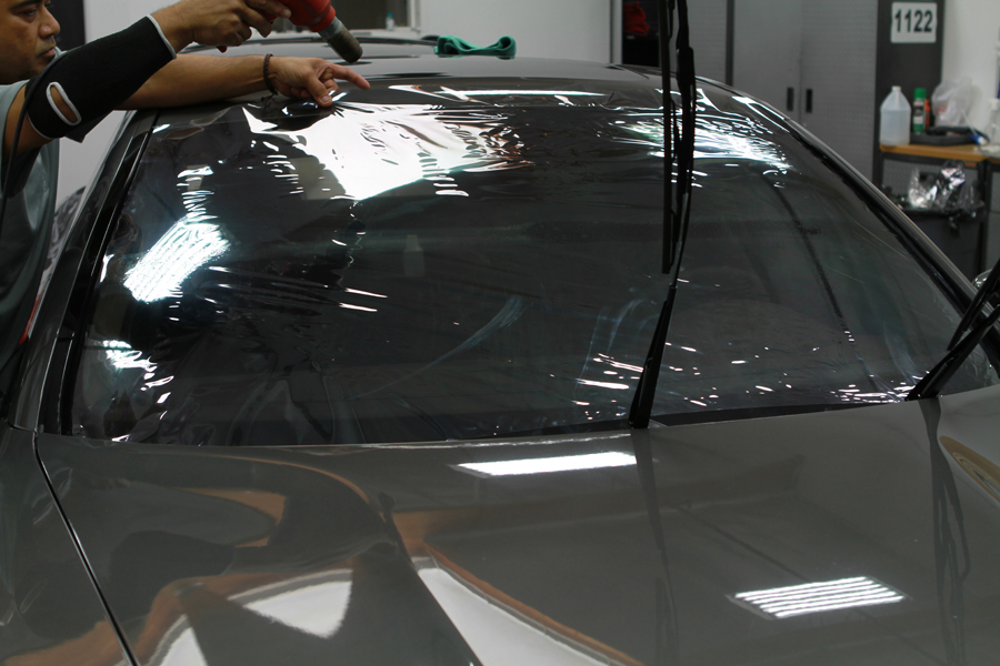

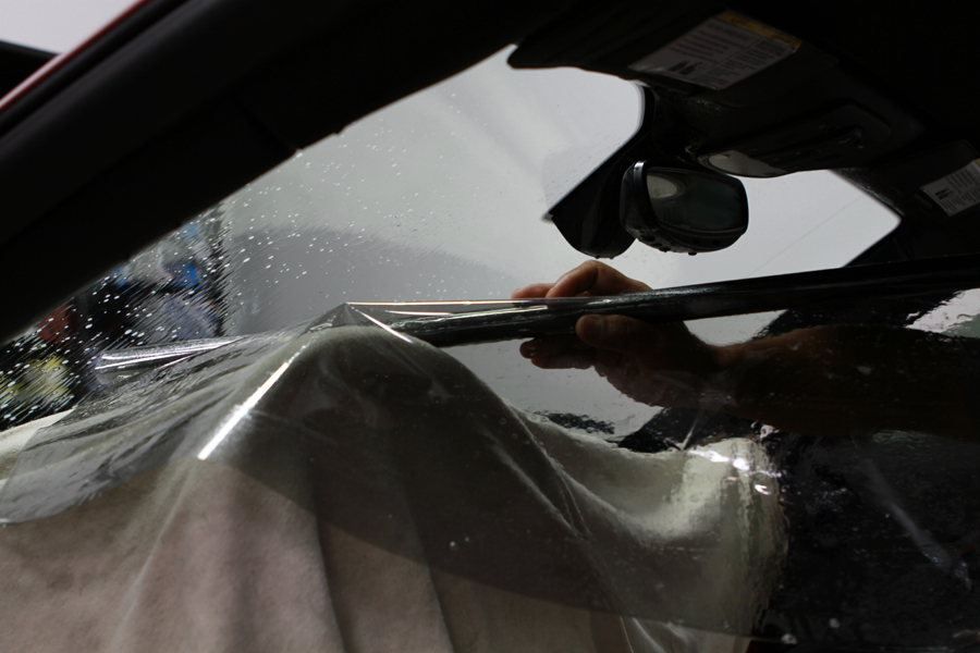

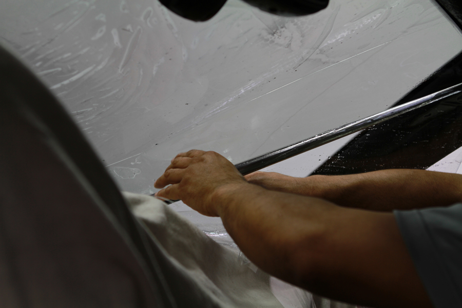

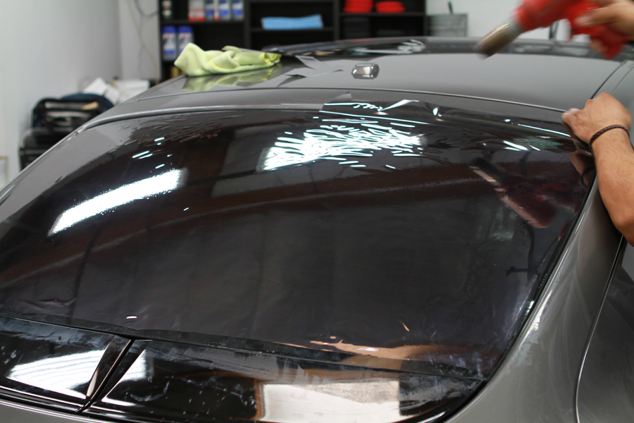

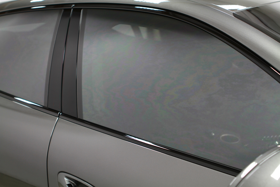

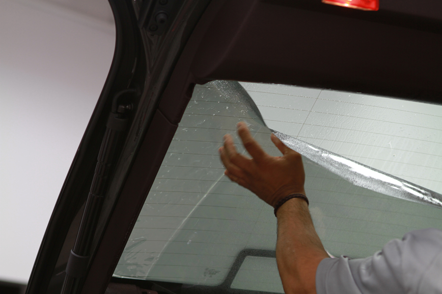

Once glass surfaces are properly prepped, we begin with bulk huper optik window film. We do not use any computerized aid as we feel the skill of the craftsman cannot be matched. This film is one of the best on the market and demands the most skilled installer. If done properly, the results are amazing. If in the wrong hands, the issues can be seen for a lifetime of the product

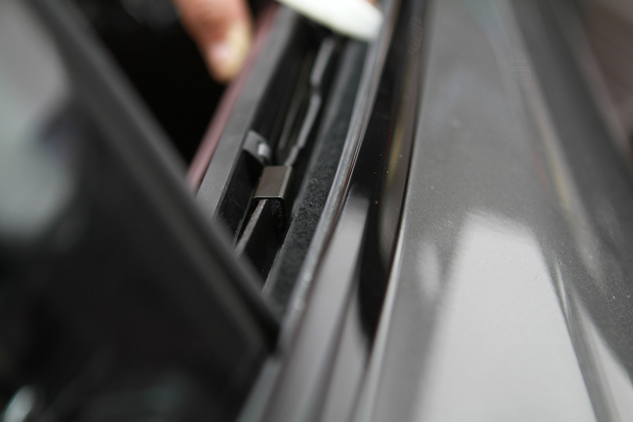

On Panameras, and some other makes, we install a mole skin felt along the window gasket to insure the film is not scratched. With huper optik, this step is not necessary as the film's thickness and nano coating protects it from scratching, but we don't like to take chances

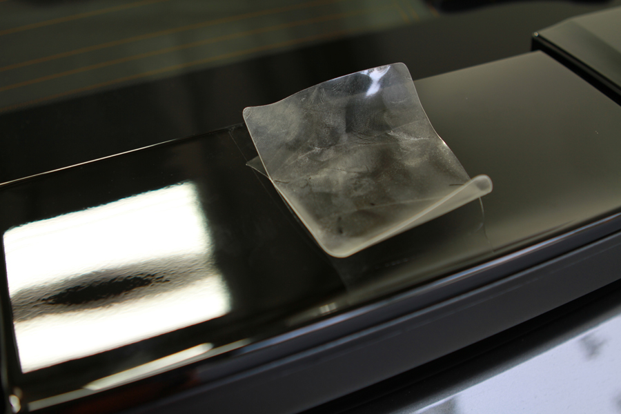

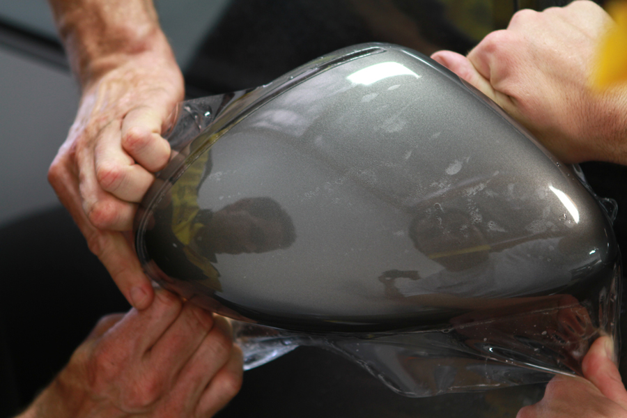

Film is hand-cut and shrunk to mold the contour of the glass

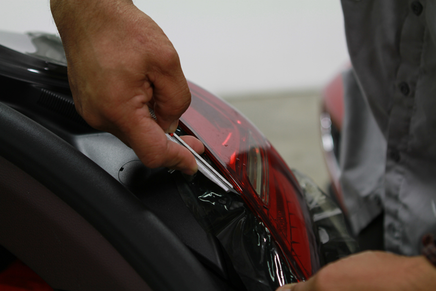

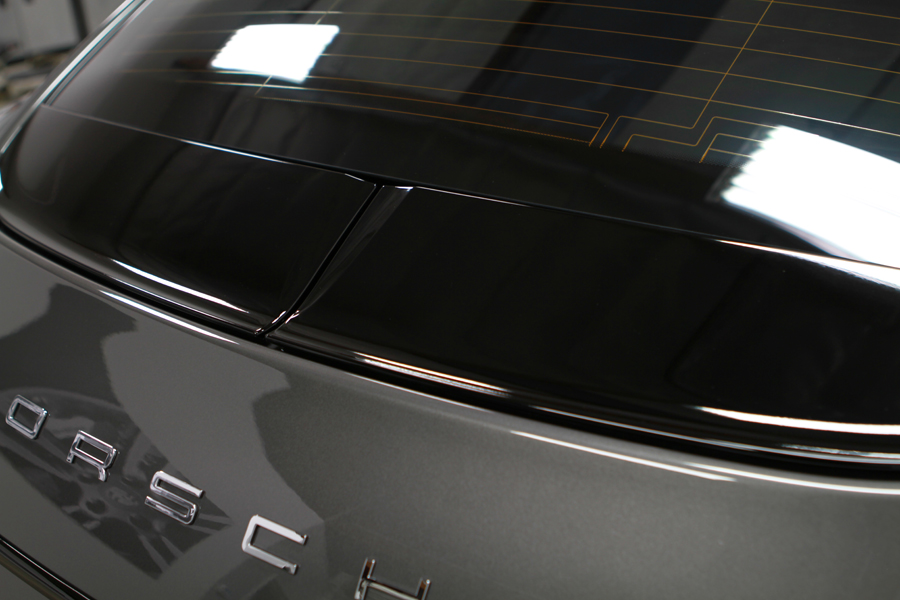

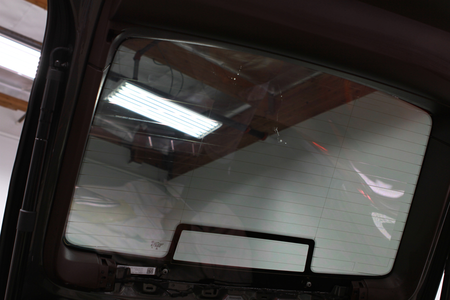

Third brake light is removed as part of the rear window installation. Once again, it's the small details that make a job perfect

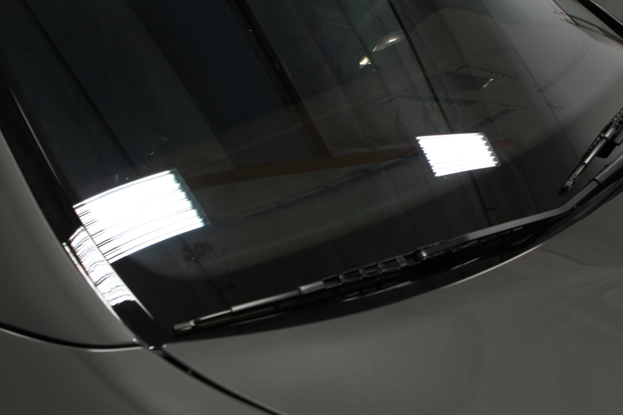

We put a very light huper optik film on front glass to protect the interior 360 degrees from heat, UV, IR rays, and dramatically reduce glare

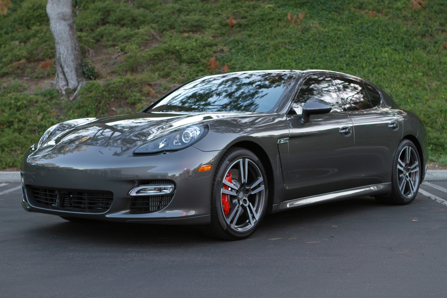

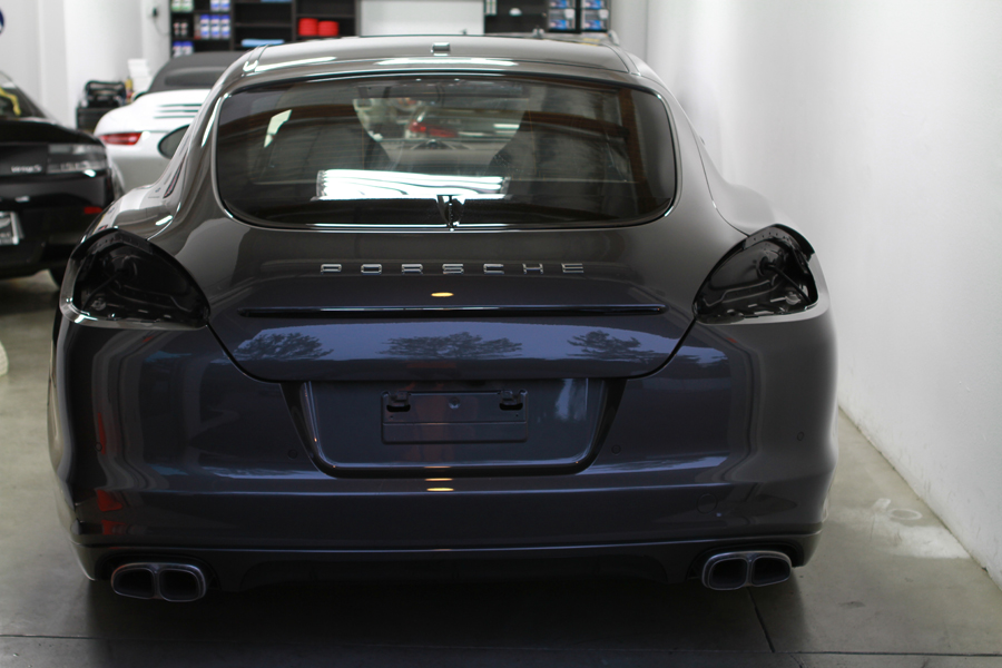

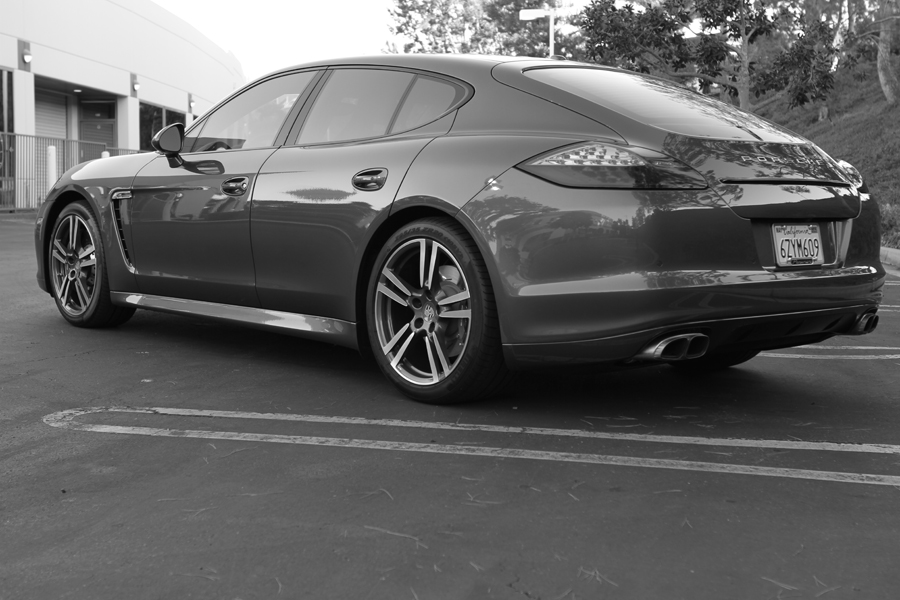

Phase 3/Nano Complete. Final Result
